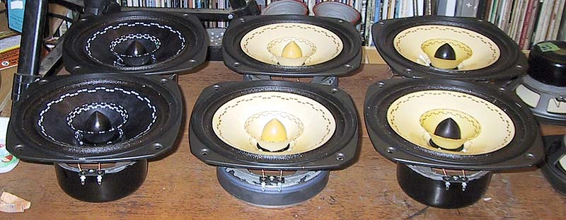

Scottmoose said:My suspicion is that it should do well with the 206. I believe Dave's now applied it to good results with the 207 (same cone).
Still a couple coats of 50% gloss and i have to put spots on the phase plugs (481 spots on a phase plugged driver with a whizzer cone vrs 157 on an FE126/127 -- that is a lot of spots)

That's EnAbl
ing I take it. Beautiful job.
I have a hard enough time not poking myself
with thin wires.
loninappleton said:That's EnAbling I take it. Beautiful job.
Yes... just don't look to closely at the rows under the whizzer.
dave
