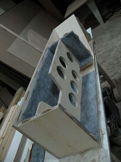

Just one question, the internal brace. How critical is the shape (since no dimensions is mentioned)? The size of the holes etc. And how tight should it fit to the back of the driver? Should I use some isolation between the driver and the brace?

CJ900RR said:How critical is the shape (since no dimensions is mentioned)? The size of the holes etc. And how tight should it fit to the back of the driver?
Shape is non-critical. Primary funtion is to brace the driver against 3 walls. 2nd (and equally important ids to brace the wall panels.
Should be a firm fit against the magnet but not so much as to strain it. You want to transfer as much energy from the driver as possible to the box panels spreading it out instead of it all being dissipated by the baffle.

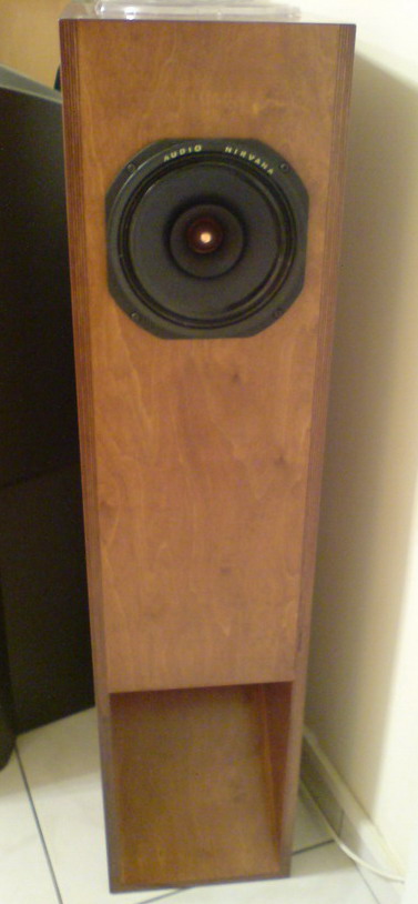

They 're almost ready. Yesterday evening i heard them for the first time. I have only a couple of hours of burn in till now. The first impression was quite disappointing. Peaky mids & highs and very week LF's. The only dampening material is a synthetic carpet underlay ~ 2 mm (dual layer of this). In order to manage a non fatique listening i connected a 8.2 Ohm resistor. Only a little difference occured. Is also a regular BSC needed or things shall be improve after fully break period. I know that AN 8CF is not the driver that HC designed for but i thought for a better result anyway...

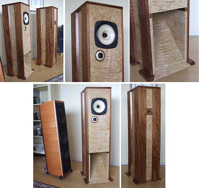

i built the half changs and the only way i got them to sound pretty good is to build a bsc for them that helped alot and i coner loaded them for mor e low bass they sound pretty good now
link to my half changs

Re: HC - AN8" CF
Not something you can count on... i'd be very surprised if you can make those work... the specs are dramatically different than the 207.
dave
aroS3 said:I know that AN 8CF is not the driver that HC designed for but i thought for a better result anyway...
dave

Dampening
As you can see in the related photo, all sides plus bottom is covered by this carpet underlay material bought from IKEA. The material has a rubber feeling in touch. Do you think that my way (all sides plus bottom) and the kind of material itself could cause low and bass frequencies dampening or cancelation ?
I'm asking your opinions first cause it's a bit difficult to remove it if neccessary.
Re: Dampening
Sigh. Why on Earth did you think that? The cabinet is not designed for the AN8; stuffing any driver into a cabinet designed for something else it is asking for it, and by the sounds of it, you've got it. The AN is completely unsuited to the load as-is, and will be the primary cause of the exaggerated HF & midband you're experiencing. If you'll forgive an anaology, it's a bit like saying 'I know this car is designed to run on diesel, but I think I'll fill the tank with petrol in the hope of better performance...'
That's heavily over-damped compared to spec., which calls for alternate walls (i.e. top, back, & one side-wall), which will kill the LF even further, and wool felt. I try to design for minimum damping. FWIW, rip it all off the bottom, one side & the front. That will help a bit. You'll also need some hefty Eq to take down the AN's inherently rising response over ~1KHz. In passive terms, that will mean a shelving filter, on the order of a 3mH inductor paralleled with an 11 ohm resistor. Active would be better if possible of course. Either way, sensitivity will be dramatically reduced, but that's the price you pay for having to force a mismatched driver / cabinet combination. The same applies to the FE206E, albeit to a rather lesser extent. You might get away with a couple of ohms less if you've got a high output impedance amplifier.
Just to reitterate: I designed the cabinet for the FE207E, with the possibility of a Pioneer B20 as an alternative cheap option for casual listening, as is noted on the plans. If you try something else & it doesn't work, don't blame muggins here.
aroS3 said:As you can see in the related photo, all sides plus bottom is covered by this carpet underlay material bought from IKEA. The material has a rubber feeling in touch. Do you think that my way (all sides plus bottom) and the kind of material itself could cause low and bass frequencies dampening or cancelation ?

We're here to help when / where we can. 🙂 Try getting some of the damping out, as I say, & you should get a small improvement. If you can get the circuit or active Eq sorted for a big cut over 1KHz, you should find things start to become much more to your liking.
