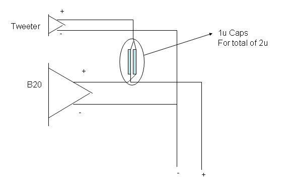

HC with Pioneer B20
Hi all...I too am planning to build the HC using the Pioneer B20. My initial impulse was not to include a tweeter but the consensus of the thread indicates that to be an error. So my question, and please pardon my ignorance, is how exactly do I connect each to each while including a suitable cap in the circuit - and I am a visual learner, so a simple drawing and/or picture would be greatly appreciated.
Thanks in advance,
Jorge
Thanks in advance,
Jorge
Re: HC with Pioneer B20
look at attached, hope this helps.
gychang
jorge1 said:Hi all...I too am planning to build the HC using the Pioneer B20. My initial impulse was not to include a tweeter but the consensus of the thread indicates that to be an error. So my question, and please pardon my ignorance, is how exactly do I connect each to each while including a suitable cap in the circuit - and I am a visual learner, so a simple drawing and/or picture would be greatly appreciated.
Thanks in advance,
Jorge
gychang
Hello Jorge
Only one capacitor at 2 uF instead of two at 1 uF will work also, of corse. If you take one at 2.2 uF, the tweeter starts at 13 kHz instead of 14.5 kHz (there's no problem with that). The cheapest solution is this:
http://www.parts-express.com/pe/showdetl.cfm?Partnumber=027-324
But you'd better take these:
http://www.parts-express.com/pe/pshowdetl.cfm?PartNumber=027-414
http://www.parts-express.com/pe/pshowdetl.cfm?PartNumber=027-214
And if you think you have golden ears, it schould be:
http://www.parts-express.com/pe/showdetl.cfm?Partnumber=027-724
sonobox

many thanks gychang and christian...a pix is worth a thousand words so it is said - tis so in my case, and chris, thanks for the links - not possessed of golden ears nevertheless i'll "splurge" on the daytons...again, thank you both for your help and thanks to all on the thread for making this stuff comprehensible, and fun! will post pix when the project is completed...be well,
jorge
