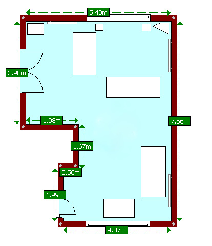

I received an interesting reply to a question I posed about a regulated PS I have built for my LM3875 amps. I was surprised that the heat sinks remained stone cold. It made me wonder why it was suggested that they be fitted in the first place. I was told that using the 206E in a BLH meant that I was only using milliwatts. Milliwatts for acres of deafening good sound 😀

As you can see I currently have my speakers quite close to the rear wall, either side of a window. The left hand speaker is located just behind the left hand sofa.
How far from the wall should I place these speakers?
One of the sofas could be in front of the horn mouth, but the driver will be free from obstructions… will this ruin the sound?
Does anyone know if the Solo 206 performs well? It is quite a compact unit that may get full wife approval without any persuasion.

Tripmaster said:Does anyone know if the Solo 206 performs well? It is quite a compact unit that may get full wife approval without any persuasion.
I've not heard it, but 206 needs a horn, and horn & compact don't really go hand-in-hand. Have a look at the Ronhorn Dallas ... it and Sachiko are probably your best bet for 206s.
dave
Solo 206 is basically a stretched version of a defunct Fostex design (quite well done). If a single-mouth horn is wanted though, I'd be aiming for Ron's DallasII.
Tripmaster said:Are there any issues with my speaker placement?
Have you considered putting your speakers in the corner -- i.e. one speaker on each side of the corner and the listening chair at 45* to the walls?
Bob
Bob
Hi Bob
Its not really going to work with the layout of the room, walk ways and radiators etc..
I think the half chilli will work better with the space I have available. I have posted on the half chilli thread and have included a picture.
