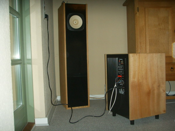

HI there, i was writing a quistion before in this thread, but it was in a middle of something else discussed at that moment...
As wrote before, i have build the HC with the FE207 driver's, and i have been experiating with some coil/resistor combination, for tuning them, to my need's.... But i found that putting them closer to wall/corner, was the best to do.
Well, i have been experimenting with a "helpersub", and that's really the way to go for my need's, as i think they lack a little, at lower freq. - Where that point start's i can't really tell, so i was hoping that someone could point out where the sub, should be taking over, with thoose FR ?
I would also like to test, putting in a passive xover, on the HC.
Any suggestion's ?
The sub i am using is a Rythmik audio diy, sealed sub, 12inch driver a30peq-plateamp. http://rythmikaudio.com/amplifiers.html
Jesper.
Any suggestion's ?
Jesper.
