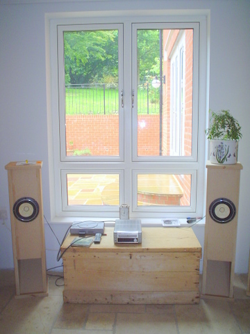

Half Ceinwyn
A Half Ceinwyn is a HC but with different dimensions due to the Fostex 168 es driver..provided by Scott..who else..??!!
My first go at DIYaudio...
I got some low hour drivers...first learning point is that as they get hours on them they sound better and better.
The cabinets are made of MDF (groan, groan..) but it was spare and free. Worked out fine on the table saw..even have wife appeal which is a real bonus.
I wanted to love the sound from my first creation but they just shouted at me...what had I built..
But a better location, hours on the drivers and woo hoo...acoustic guitar is real nice..Tracy Chapman..Eric Clapton Unplugged. Bass is very good..Bizzare Fruit thumps it out...the tops haven't been glued on yet and when I first got the bass really going I thought the drivers were breaking up...just the tops bouncing...hence the plant pot.
Alison Krauss vocals are beautiful but once Tina Turner starts going up the scale they still shout a bit and become fatiguing...so underlay to the rescue. Can you get phase plugs for these drivers..? Would they help..?
They will be glued down once I get the woollen underlay in...do I glue it with wood glue..?? or silicone..??..and have sorted out the brace for the driver.
The CD player is a PS1..total cost £6..as my kids broke the CD player in my Denon...which I got going after perusing another thread. My current amp is the Denon...I have a Trends TA10 from Mr Wu in HK but my wife has misplaced it in the house build / move..!! Maybe I souldn't have bought it but just gone straight for one of Mr Pass's designs..that is my next project I thnk.
I also use my laptop as a music source...high quality MP3 and FLAC sound very good. No DAC, just Windoze MP and the laptop soundcard, but I shall improve on that as I have time.
As a non HiFi audiophile who really likes his music sorry for the non-audiophile review but I hope you understand what I am trying to say and a big thank you to Mr Moose...I am in LAX later in July so your drivers will be with you shortly sir..

Nice job Adrian,
You might want to consider making up a BSC circuit to help tune the sound to your taste. They can be a great help in reducing the shoutyness and fatigue. It's easy to do and can be done externally, if you don't like it just take it out. there is a nice explination at Martin King's site if you don't know how to go about making one.

Re: Half Ceinwyn
Although purists will be revolted by the suggestion: I would try a baffle step correction circuit.
The HCs I built benefited greatly by the addition of a BSC. For the HCs w/ FE206e drivers, I used a 1 mH inductor and 5 ohm resistor. You give up a couple dB in sensitivity, but improvement in SQ is worth it. And if you have a SS amp w/ any power in it at all, you won't notice the loss of sensitivity.

Given that, if I'm reading the post correctly, the tops aren't even glued on & the MDF enclosures are completely undamped, I think it might be a trifle premature to be contemplating Eq circuits.
Before anything else, they need the required damping adding & the tops gluing in place. MDF is not an especially stiff material so it too will currently be resonating right where you don't want it to -the damping & brace should take care of that. Once that's done, & assuming they're near a wall, I'd be surprised if they needed any correction. In your case Jim, IIRC, you're using the 206, which isn't ideal for this kind of load -low Q, high mass-corner, rising response over ~1.2KHz; the circuit you're using will likely be dealing more with that than step-loss itself. The 168ESig. has a higher Q, lower mass corner & a slightly flatter overall response trend so needs less adjustment for this sort of box.

Re: Half Ceinwyn
No-one has yet done the legwork (ie lost a dustcap) to figure out what would be needed... i'd wait until you have finished the cabinets and have some 100s of hours on them before ever considering phase plugs. I'd also sort amps & sources too.

Thanks for the comments.
Maybe I should have finished them completely first before posting. But I am pleased with what I have done so far and it is just a first step of many..I hope.
Having spent hours and hours perusing this and other diy hifi sites I am beginning to get the basics and understand their importance. Materials, burn in, the importance of a good source and amp. Time it takes to build, cost and WAF appeal.

Adrien,
I'm delighted you're liking them already. :^) Cheers re the drivers BTW.
Regarding possible amps, if I were you, I'd probably be looking at the F1, F2 or F3 for use with them, if you want one of Nelson's designs. A Squeezebox would also be a canny move at some point in the future.
