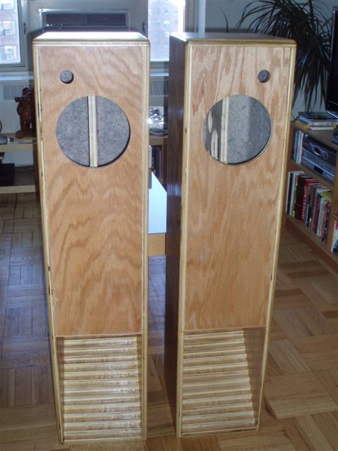

many thanks to all on this thread who have contributed their time, their expertise, and their enthusiasm to enable me to complete my project - 1/2 CH with B20, and the Dayton/PX cheepies with 2uf caps as per GY Chang - recently put them in my daughter's apt and was extremely pleased with the outcome, fit, finish, and non-technical listening experience all very satisfactory...again, heartfelt thanks to all...

Your speaker looks very professional indeed, looks excellent. My contribution here is minimal I happened to hit on the combination of the Dayton tweeter (was cheapest I found at that time around $4... but now higher) with the B20 by pure luck.
Main credit should go to Scottmoose, Dave at Planet10, who comes out with the science and practical way to distribute the knowledge to the street guy level.
gychang

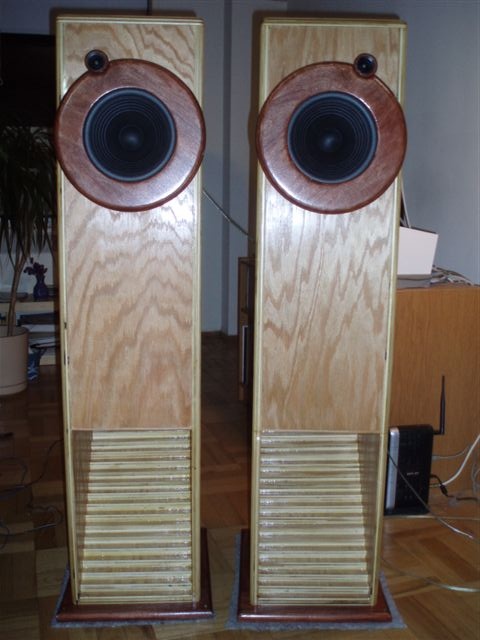

Sorry for this simple question, but ive seen many different types of internal padding in this thread. Im planning to build a pair of these with 207 drivers very soon and just wanted to clarify what would be best in terms of internal padding. What type of material should be used, how thick and where should it be placed?
I used "felt carpet padding" from my local home center. It might be called "wool underlay" or something similar. It isn't really wool felt, but a synthetic material about 1/2" thick. I covered the top, one side, and the back.

Anyone placing any poly fil (sp?) in their half-changs?
No. I lined per instructions: top, back & one side. Open cell egg crate foam worked well.
