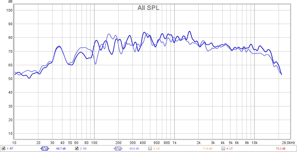

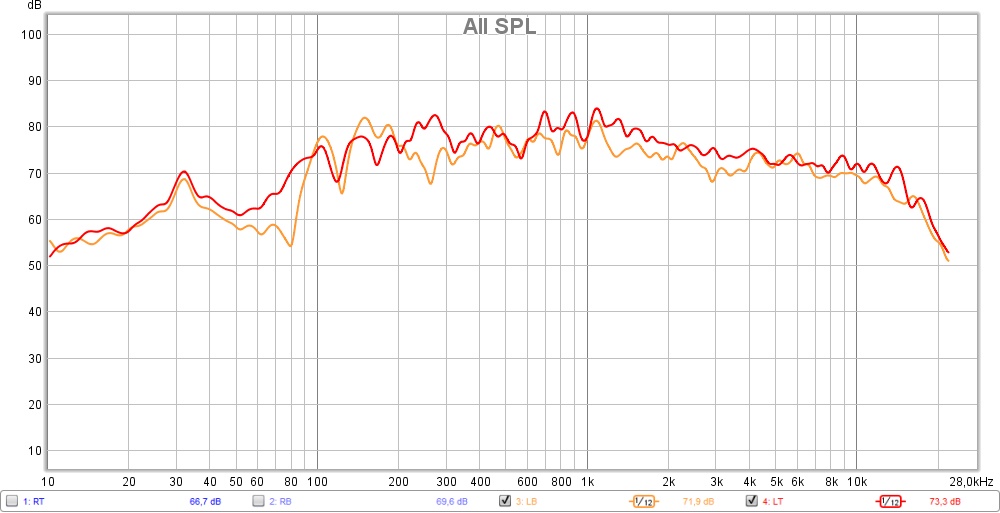

Here are the non-EQ measurements from sweet spot for top right (RT), bottom right
(RB) and LT/LB (1/12 smoothered). The idea is to use these measurements to generate EQ-profiles I can play with. (1/12 smoothered)
Measurements are done at 80dB calibrated.

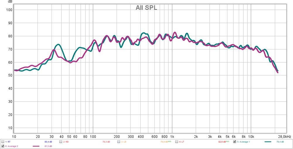

For the Left side there is a bigger difference between top/bottom group between 40-90hz, otherwise they are more or less on line with eachother.
There is also a 3rd plot with the average response from RT+RB is shown, along to LT/LB.

For no EQ measurements these are not bad at all. Don't try and boost both ends alone. Shave off some energy in the middle so it get's more leveled out. I shave off 10 dB of energy in the lower mid frequencies to arrive at a flat target.
I had expected to see more output at 200-300 Hz, but that might be because you ran these in sections, making them act as finite arrays instead of a floor to ceiling array.
Except to maybe be able to fix bottom end problems I wouldn't run the top and bottom separate from each other. As that removes their "virtually endless" array advantages.
On that note, after further thinking about it.... you have the wiring of each diver accessible at the back right? Two sections make up the entire floor to ceiling array.
I would connect the top most 6 drivers to the bottom 6. have a middle section of 12 drivers covering both seated and standing up distances. I may even use the lower 4 and upper 8 if that covers both standing and seated positions better. That way you could run a limited section for the top frequencies is you were inclined to experiment with such a thing. In theory that would reduce comb filtering as there is less difference between each driver and ear position for that middle section. the outer array would get a gradual cross filter to shave off anything above ~5 KHz or something like that. A unique opportunity to play with.

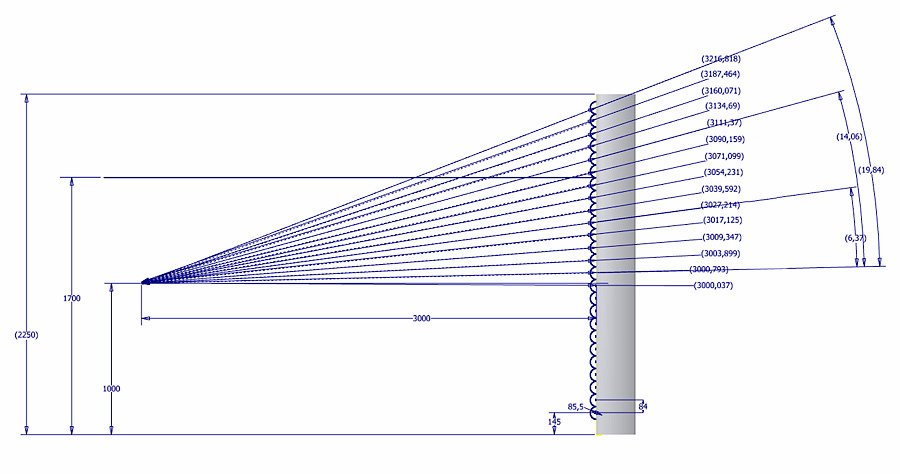

I have considered something close to an expanding array, as seen from a listening position in my design phase. It was a backup plan if a full range array did not work out.
a chart showing driver to ear distances that can be calculated back to (quarter) wave length differences
9 - 5 could also be done.

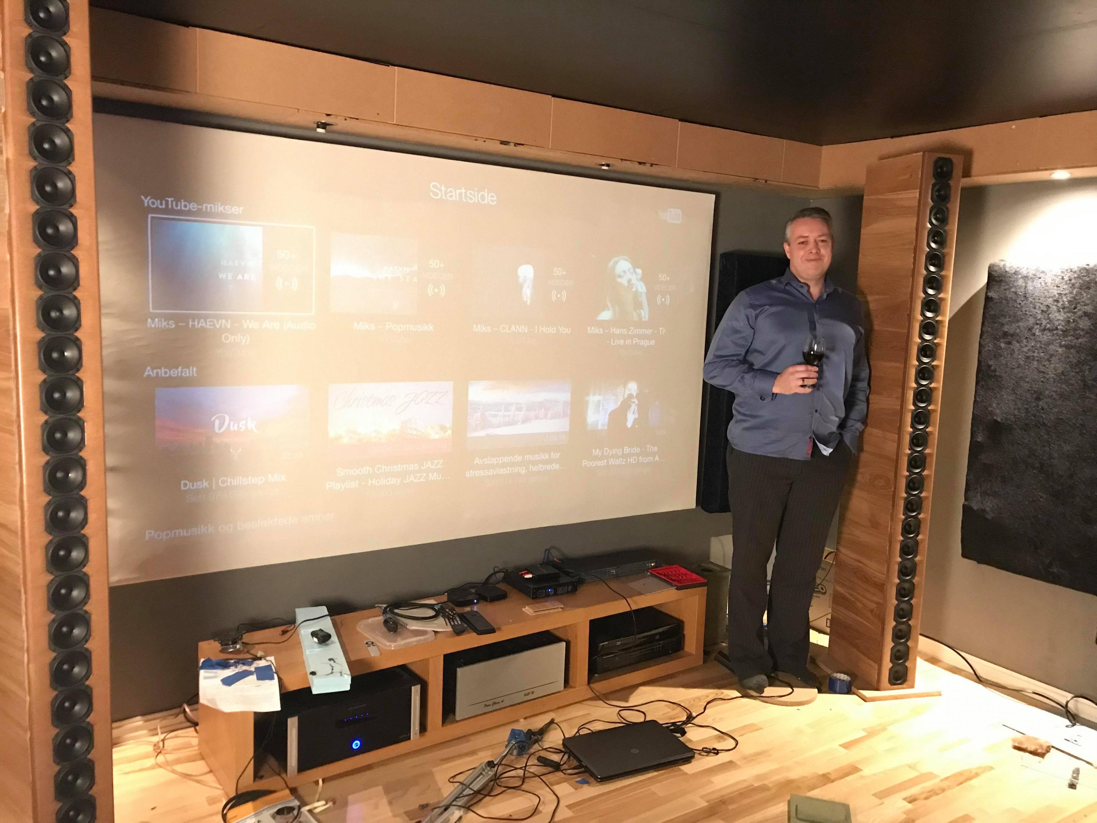

BTW - my in-law was over for family dinner on Thursday and my father-in-law wanted to have a listen, he was stunned (but no "audiophile" guy) by the clarity and presence. As a coincidence two weeks ago he spent an evening in front of Sonus Faber Extrema´s, and he would have taken the arrays any day of the week
He also snapped a pic, seen below - I apologize for my cheeky grin and not tidying up 🙂 I am 186cm tall for size reference (about 6´2")
