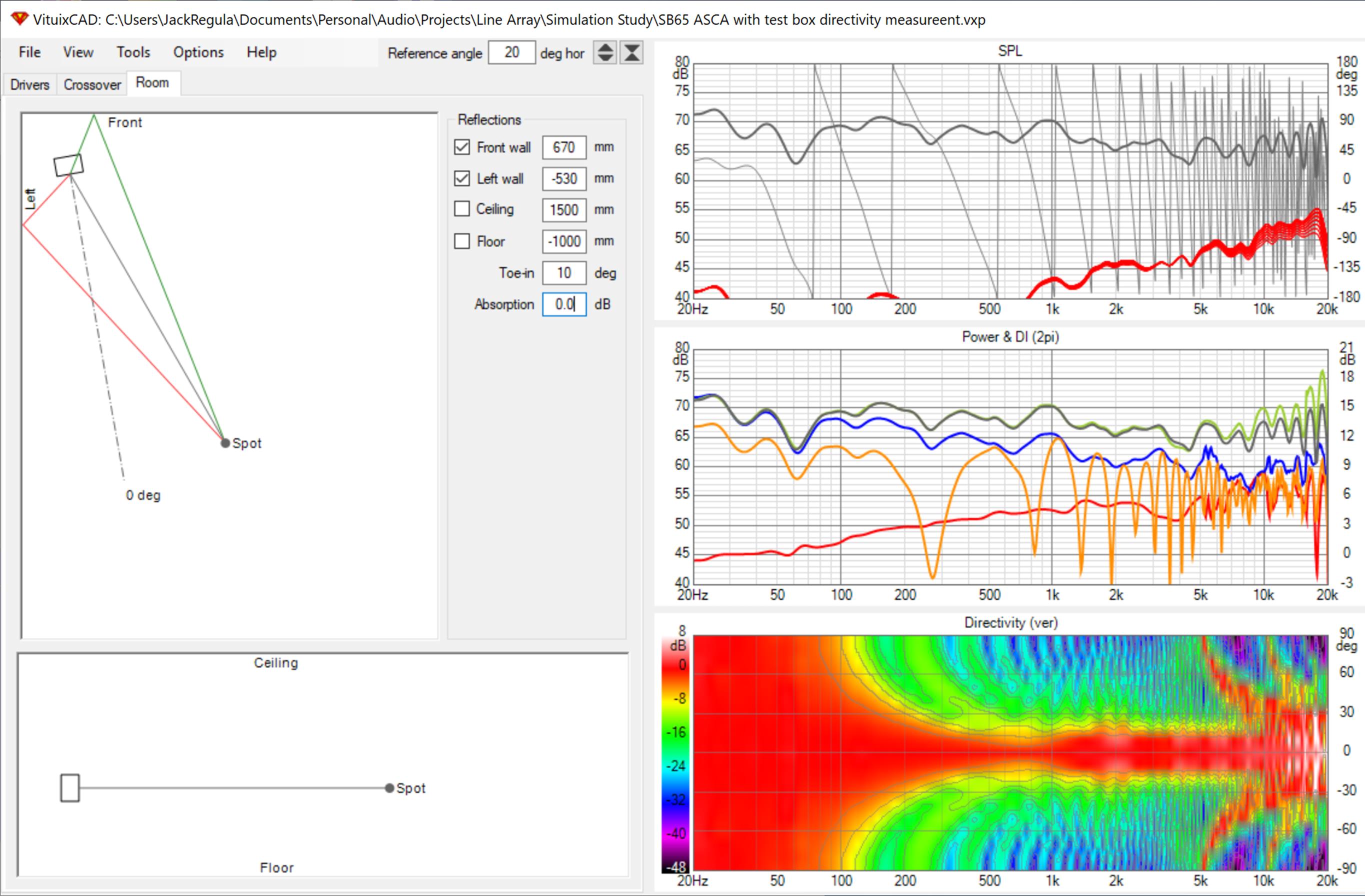

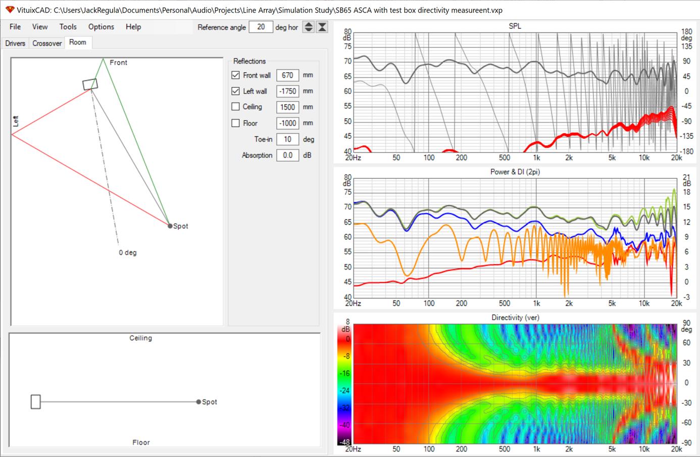

I already had a room sim of an array so I plugged in your numbers to see what the boundary interference looks like. Thank Kimmo for Vituix!
This comes from my SB65 array sim, imperfectly equalized. The sim predicts the directivity of the array based on measurements of a single driver. At the low frequencies we are concerned with here, the directivity won't be different from a TC9 array. The orange trace in the middle graph is the room response. The gray trace in the top graph is the response at the reference angle without reflections taken into account.
First the close side. The boundary null is out almost to 1 khz where your 2" absorbers will have no trouble killing it.
attachment.php
The other side at 530mm has a null near 250 Hz. If you can fit an 8" panel there, that should suffice.
attachment.php
These nulls and ripples are due to the side wall. Turning the front wall reflection on and off has very little effect. Both Wesayso and I have noticed that front wall reflection is the least problematic. I don't want to say it doesn't matter at all because I think the sim might not properly take having to diffract around the baffle into acccount but I would certainly treat the sidewalls first.
Of course I recommend doing your own sim if you haven't already and playing with spacings and absorption.

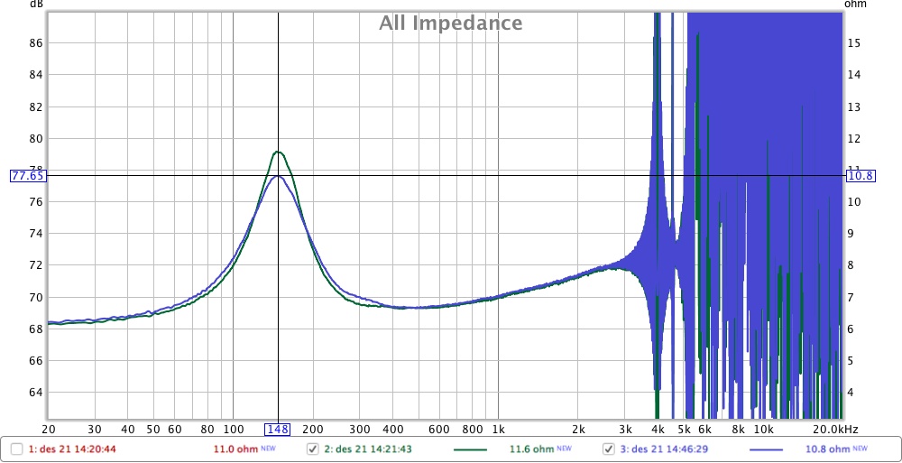

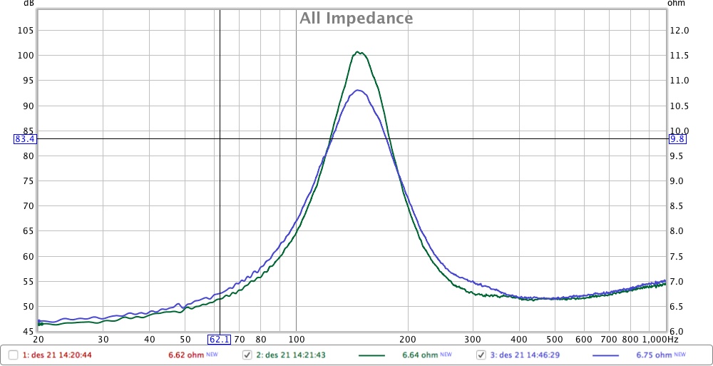

I experimented with the stuffing today and filled one group of drivers, here is the before/after plots. Note that the resistance of my test circuit is not precisely measured so the amplitude may be off, but that shouldnt affect wiggles.
The measurements are from one group of 12 drivers (3Series4Parallell)
One question - comparing mine with Ronald´s I see he have a smooth imp.raise in the HF-range, while mine doesnt - they are all over :scratch2:

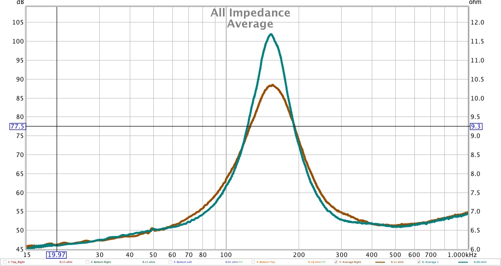

I spent a little time experimenting with the internal damping and came up with a promising combination. So I have now updated my Right array accordingly and Left is not so I could do a comparison.
Right impedance measurement (Brown) is an average of TopRight and BottomRight as each line have two independent groups.
Turqois is average Top/BottomLeft.
I will update the Left with the same damping configuration then I will need to revisit freq.sweeps and speaker positions 🙂
While the freq.scans are rough the ears are still quite excited 😀
I'm still wondering what happened to your top end on that impedance graph...
I've never seen it look like that...
803769d1576939947t-halair-aeralis-fullrange-line-array-vifa-tc9-18-08-a-imp_rightline-jpg
What did it sound like? Just like a normal frequency sweep at reduced SPL? It should be visible in the two most right indicator columns on that meter that's running while making the impedance sweep. The right most indicator draws the impedance curve and should show strange behavior at higher frequencies. But if the tone still sounds like a regular sweep, something must be wrong. The middle (and left) indicator stays at the same level throughout the sweep? It is possible you're clipping the signal somewhere. That could throw everything off. Try running the sweep 3 dB lower in level. Watch the indicators and make sure each of them says clear of the top by a few dB.

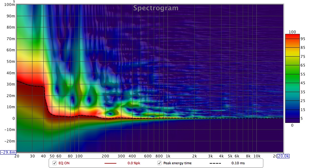

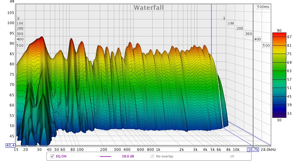

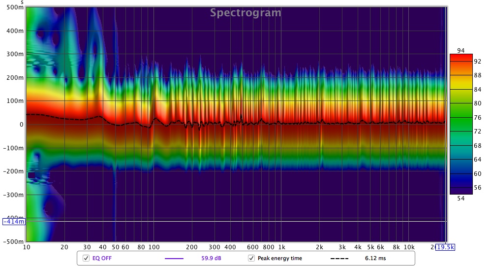

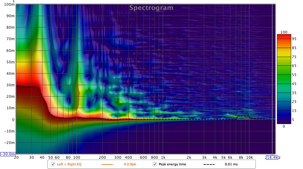

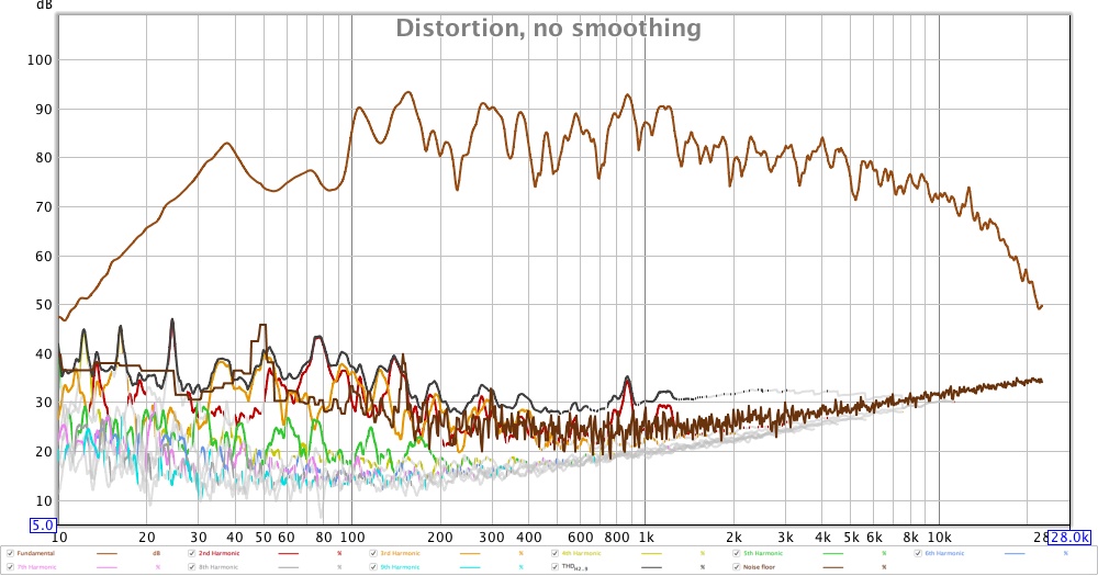

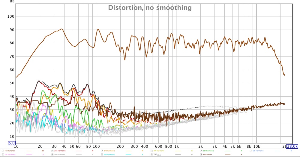

I was curious how the re-stuffing might affect things, which was finished yesterday.
Brief REW-session with UMIK in sweet spot and arrays straight out from the wall (no toe-in), distance to wall approx 90cm. I have not balanced the L/R response individually yet so take it for what its worth :judge:
Distortion increase below 100hz obviously with EQ=ON :wrench:
Between 40 Hz and 100 Hz there are phase differences between both channels. That's creating the suck-out and we need to see the separate left and right plots to figure out the why.
As they do not sum properly, boosting it isn't going to help and distortion will rise quickly.
So we need more detailed information of what's really happening, but that can wait a few more days 😉.
