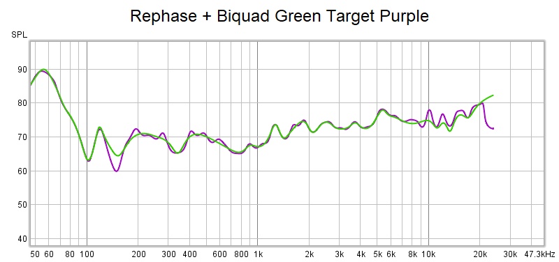

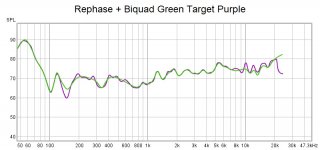

I have made you a set of filters in rephase based off the DRC target. In simulation they are fairly similar. Purely minimum phase at this point.
If it works then I will explain the process :)
attachment.php
