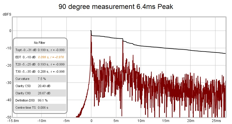

In your newest measurement taken at 90 degrees there is a massive spike at around 6.3 to 6.4ms it is very consistent between channels, it is only 5dB below peak. This is weird because it wasn't in the other ones. For now I will continue with the first measurement until you can work out what is going on. Works out to be a distance of about 2.1m.

In terms of distance, the 6,3ms = about 210cm = 2x distance baffle/front wall.
Not sure why it show now vs earlier measurements, the front have not changed - only mic orientation and cal file.
But cal file should not affect impulse right?
Our maths agrees 🙂
Cal file only affects spl graphs so that shouldn't be causing it. Could be a glitch as it is so loud. Perhaps try again and see, due to the change in orientation I would look at the ceiling but the arrays normally take care of that.

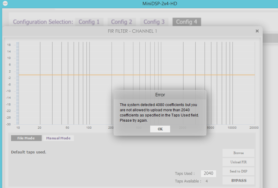

The miniDSP 2x4HD can handle a total of 4096taps, arbitrarily split over the 4 outputs. Minimum taps per channel is 6, so I can use 2042 taps each for two channels. (@96khz?)
Fluid have generated some test filters, which load to the DSP but apparently severely attenuate the output signal. Reason unknown.
The graphical filter display do not show this attenuation.
Work in progress 🙂
The filter won't run properly at 96K it needs to be at 48K. With the limited number of taps available the sampling frequency will need to be left at 48K.

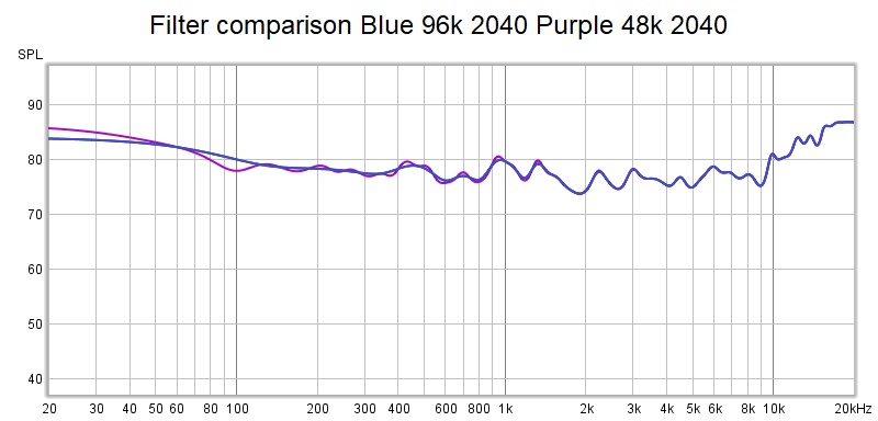

Most of the last paragraph above is probably wrong as the volume of the filter was quite high when I checked it, now I'm thinking sample rate.
I thought that the 2x4HD could be set to 48 or 96KHz like most of the older units could. I think I may have been wrong and it can only run at 96KHz because of the plugin it is using.
If that's the case all the files I sent were set for 48k. These won't work at 96K and could be the cause of the low volume. Seems the preEQ biquads are OK as REW knew they needed to be at 96K 🙄
I'll make some new files at 96k, but it will involve a bit of sample rate converting and it will effectively halve the tap count.
Seems ridiculous to me that MiniDSP would not give you option to set a lower sample rate with such a tap limited device 😡
That thread is quite amusing, my take would be that the quality is likely to improve by leaving the sample rate at 48K to give you more processing power. 96k filters should be on the way soon so hopefully that will give you something to test.
attachment.php

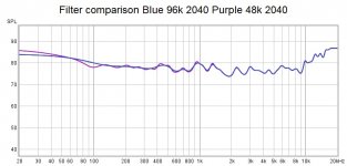

Due to the need for a 96k filter the tap count has effectively gone down to 1020 when compared to a 2040 filter at 48K. This is the difference in the filters. The filters start to diverge at about 1.5K. Still a fairly close representation and workable.

No fly 🙁
Managed to skip out from work in order to take a delivery at my house (270x TC9's...) and briefly tried to import the filters you have provided.
