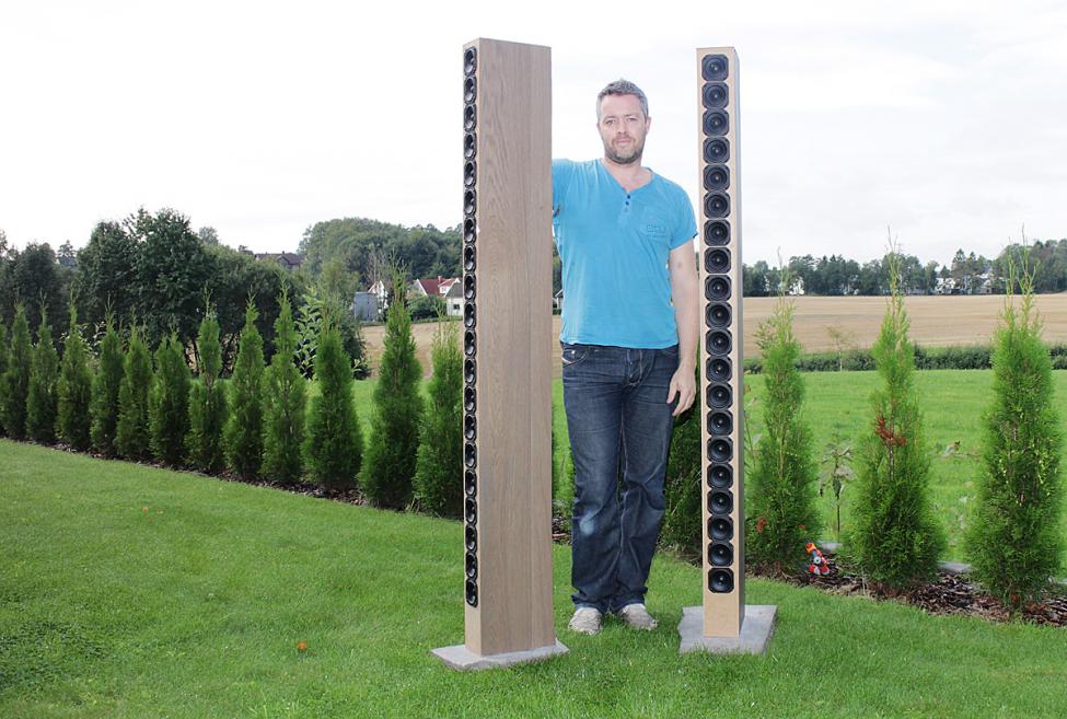

Indeed they do, and yours are +1 in drivers 😀
I could have added the 25th driver but then I would have to be creative when tilting them up (ceiling is 219cm)
I am 186cm tall and the mk2's dwarf me 😎
Here are my smaller mk1's, guess I'll have to take both mk1 and mk2 out next summer and do a comparison shot 😀
Once both are playing I will take a break from building, and finish them off exteriourwise until the holidays. Its been a several long nights and a lot heavy lifting - I am tired 😉

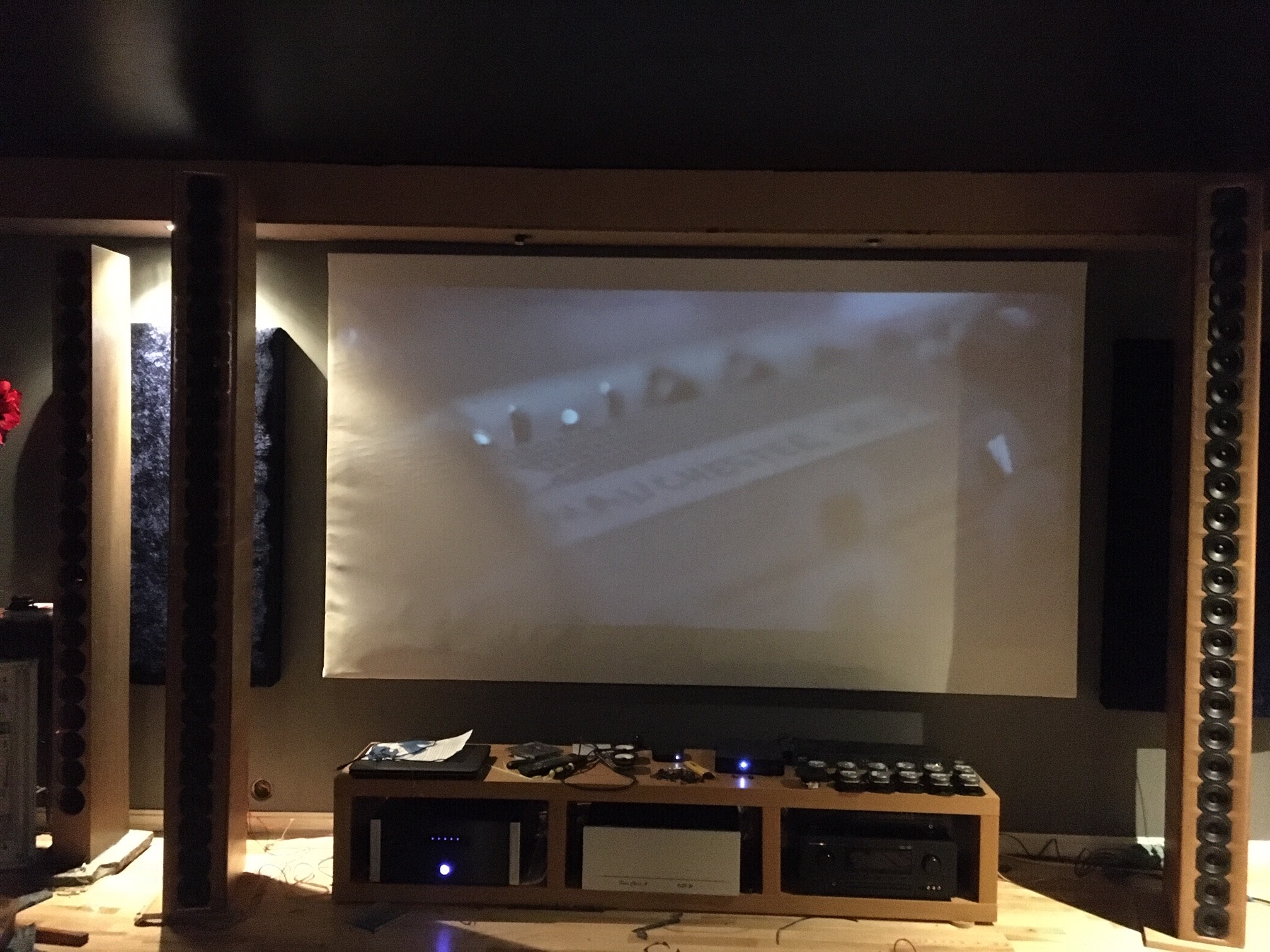

Today was indeed the day :scared:
Wired up the lines, put some power into them and what came out is best described as "pure glass"...
This was a world apart compared to my mk1´s.
Bottom end was so much richer, layered and the ambience / 3D soundscape was the best I have ever heard - it was ridiculous 😱
EQ is done by ear only and isnt perfect by any means but its close, darn close.
Hope to score better DSP tools soon :deerman:
However - I may have an issue with my system as the amp is tripping some failsafe on occation. It dont seem to be volume related so it might be a low resistance detection - or heat. But the cabinet do not feel hot, barely warm. Amp is an Emotiva UPA5, 600VA PSU and rated at 5x 125W/185 into 8/4ohm. Arrays are 6ohm nominal and should be within spec.
Will have to investigate....
First stereo impression sounds great 😀...😀
Trouble shooting power amp can probably be bit of a headache or time stealer, does it have a indicator that indicate what channel out of the five that triggers the fail safe mode, can think of if power amp is real DC coupled then if preamp have some small DC offset error it can trig the power amp failsafe detector circuit and if that's the case you can use a DMM in DC milllivolts mode to measure each preamp outs cacble and see if any of them carry a DC potential greater than say in 10-20mV area.
Its not one channel that consistently that trips, also not only at high volume.
So its a random channel, out of the 4 used that trips. On one occation two channels indicated fault, both outputs to one speaker.
Its the same DAC I have been using for a few years but the changes are:
  • Simple/dirt cheap RCA cable used to make-shift a Y-arrangement. Each cable is 4m long and the Y -split i close to the DAC. So with two long, thin cables running might make it worse.
  • System impendance is down from 6,3 to 6ohm. Not much.
I will make new signal cables, shorten them and have the Y-split close to the amp. Will also check the DAC outputs for DC offset, thanks for the tip 😀
@wesayso
I have not had any issues with the mk1´s. When hooking up mk2 I needed to make a RCA-Y cable to split the signal. This was done using cheap and long signal cable, with the Y-split close to the DAC. So it could possibly allow for voltage oscillations over the total length of the entire cable, spanning 8m end to end? I had one or two stages enter failsafe, and it was random which side was affected. It was dominantly one stage that displayed error. When two stages stated error it was either left or right array.
Redid a shorter cable this evening with the Y-split close to the amp and have not had issues since, albeit short test period. Time will tell...

Time to clean up the room and give the speakers some proper lighting 🙄
