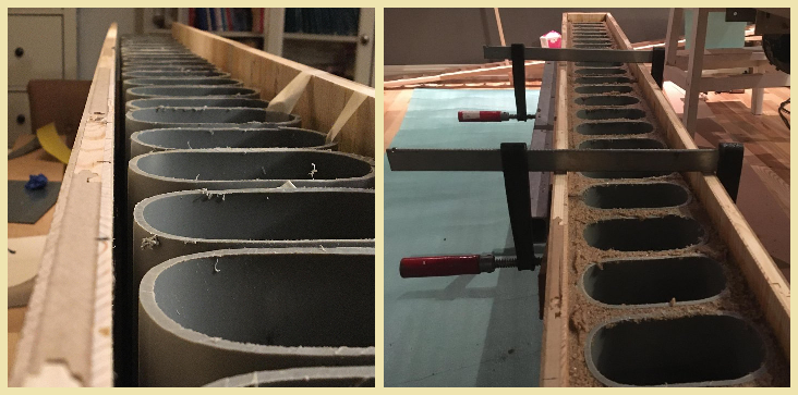

30kg worth of EG cast in place, now I need to get some sleep before work, so I can do the last 20kg or so.... Each 10kg require about 1h30min from mixing to compacted, a lot of small areas that need to be filled properly as the EG do not flow one mm by itself :mummy:
If the last 15-20kg can be cast tomorrow I should be able to pull the liners on thursday/friday....
With that extremely low viscosity isn’t there a pretty big risk you get som void’s in there that could give you unwanted internal resonances?
or is that a non-issue or, do you have that thing under control too? :p
There is the chance of that, taking it slow reduce the risk - but on my first cabinets there were some voids and a few holes in the interdriver chamber walls.
What kind of effect it may have on resonances I dont know, but dont think it will affect much :p
Everything under control? Hardly :drunk:
Another milestone have been achieved, cabinet #2 is cast.
47kg sand and 5,6kg epoxy was the grand total and its now left to cure until friday :) Another 5-6kg will form the rearwalls, scheduled for this weekend.

Regarding voids, due to the cramped volume the EG is forming into there is no chance of consealed voids, like bubbles trapped inside the matrix.
On cabinet #1 there vere two voids towards the cabinet, where a small area didnt have EG at all - but these were easily remedied after the liners were removed.

I have started with less stuffing compared to my mk1's and I hope to find a little time to finalize that aspect before finishing up line #2. So far I have been focused on the casting which was a tedious process. If I ever is to do this again it will be simplified :D

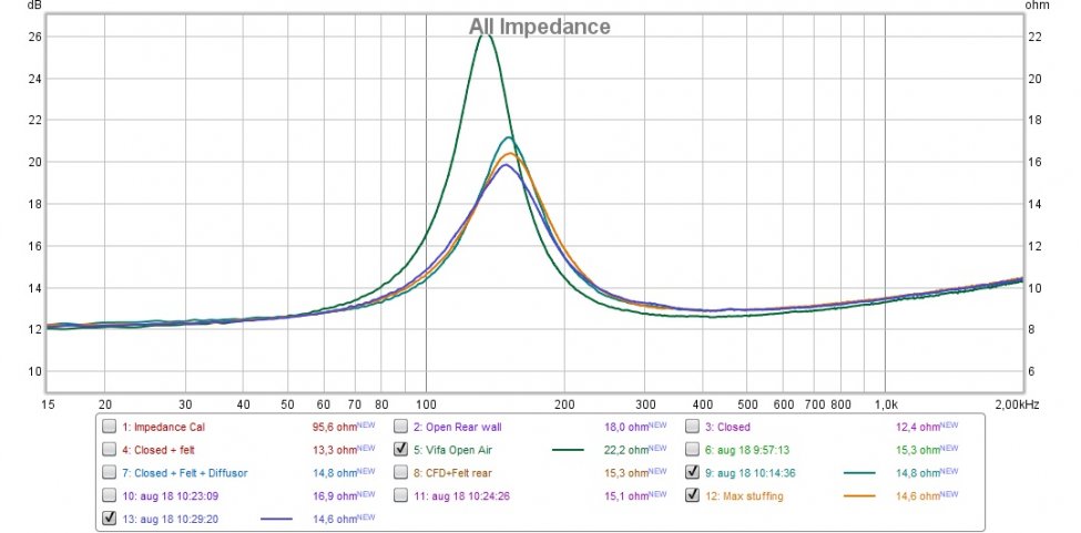

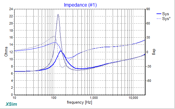

If it can help for stuffing process find a zma file hang on below into a zip folder, its the curve of wesayso's build and think it can be used as kind of good refference or textbook overlay : ) its the blue curve in below Xsim overlay and the grey curve is one of my own TC9 curve into free air. Admit i haven't asked wesayso permission to share file but in the visuals is shared over in towers thread anyone can do the tracing act : )...

Shame on you! ;)
Just kidding... observe the fine wiggles in impedance tests. Stuffing should get rid of those. Leave some free room behind the driver(s). I bet your results can be great with denser stuffing the further you get from the driver. If you use fiberglass stuffing it might make sense to have another material between it and the driver. I used (real sheep) wool felt for that.
The first tower is lined with 8mm felt all-around and 10g of Knauf Glass Mineral Wool for each chamber. It occupy roughly 1/3 of the chamber volume.
Preliminary impedance tests in the test chamber showed promise, but compared to my mk1 its only 50% of what I used there :sly:
Using two different medias for stuffing will most likely be more efficient and overstuffing the test cabinet with Knauf made the curve drag and a shelf to the left. (measurements are crude and not with a calibrated circuit as the resistor value for REW is not within spec)
I havent measured the first tower yet but want to do individual driver / full line plots when time allows it.
