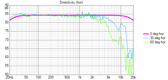

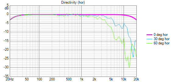

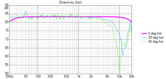

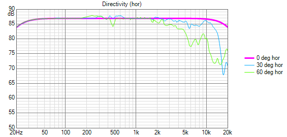

Think to die for is a over react but nice you can buy them locally 🙂 compared to TC9 or TG9 a bit less diameter should naturally give a bit better dispersion on cost of less area to keep up displacement number. Below comparison is based manufactures datasheet for the first three of them and for the fourth Tectonic TEBM46C20N-4B data is thanks Juhazi link to HiFiCompass. The low cost for TC9 and TV transducer application stamp in datasheet is probably why many always think there is something better out there, in my view its a jewel in raw out of box its close to 10F in response domain and in impedance domain nothing looks come close, in comparison below they mirror EQ'ed flat as pancake on axis in a 20Hz-20KHz bandpass:
SB10PGC21-4:
TC9FD10-08
10F8424
TEBM46C20N-4B

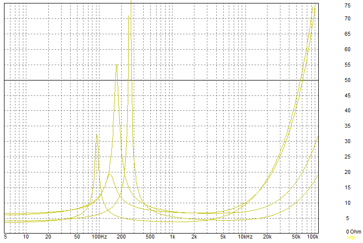

BYRRT - I bet you are hatching on those impedance traces also 🙂
What about me...!!! 🙂
Well take it as a friendly hint that it means something we dont measure and also because we dont filter anything out as for multi way in one transducer cover all the audioband here, the flatter the better and also a higher nominal impedance would help but that feature belongs to past get transducers more than 8 ohms and 4 ohms really belongs to cars doesn't they 😀. Subjective try look up how natural bass notes resolution sounds for you in head phones 300 ohms or up compared to 32-64 ohms cans, also how bass resolution could sound natural in granny's old mono or stereo system that probably had a combination of a high impedance widebander plus a power amp which output impedance number probably was a relative high number.
Below are those same four transducers in same order starting from left side focusing on frq of the resonance peak, TC9 rocks the lowest resonance and the highest HF reach by its low L(e) number and can say for wesayso's build he managed get that resonance peak down to a 12,3 ohms number probably because he is good or carefull to execute mechanic stuff.

The Fountek impedance trace looks ugly - a lot of resonances in that design. The SB is clean - even at the peak. Percevel - please report on your finding once you get hold of them - a new thread maybe even!!
