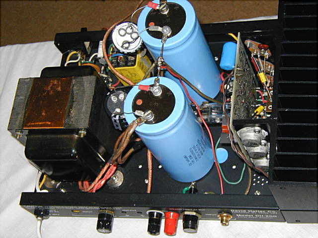

1. Dual mono or monoblocks. Took the right hand heat sink from
one amplifier chassis and mounted it on the left hand of a 2nd
chassis and with an extra transformer, switch, PS caps, etc.,
had a pair of monaural amplifiers. Their transformers were
moved to the right end to better balance the weight and to
provide ample space for larger PS caps. Also installed an AC
powered time delay relay in each set for ~7 seconds to cancel a
50 ohm 20 watt AC surge resistor (see picture below).

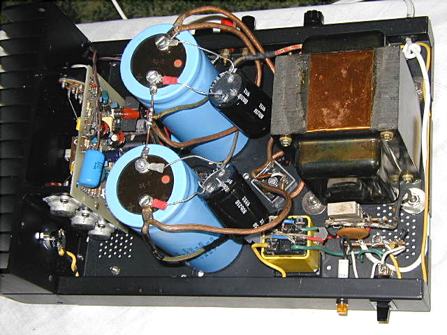

3. First auditioned them with the stock 10 K uF Sangamo PS
caps and found the monoblocks improved spaciousness and
breadth of sound stage but the overall sound was still the bland
old DH-220 sound from the past. Then, installed a 10 year old
set of 25K uF PS caps from Musical Concepts. Sound improved
with better inner detail and lower mid and upper bass warmth. I
could hear that progress was being made to get a really good
sound. Then, installed my trusty old set of 42K uF pairs of PS
caps in each mono amp and the sound really took off! The
blandness was gone and the sound became detailed with depth
and good left/right definition and stability of audio images. Plus,
a better sense of inner nuanced presence became more
apparent. Finally, the last addition is a pair of 1400 uF caps to
bypass each PS cap. These 1400 uF are nothing special, just
snap in electrolytic models from Illinois Capacitor. However they
provide a slight improvement in the lower mid and upper bass
area.

monoblock
Dick,
Interesting idea. I always thought that the DH-200/220 was limited on the power supply for a more than 100W amp. I wonder how the mono amp configuration using the 2 channels sound?
Increasing the power supply capacity that much I have no doubt that it sure has a big effect on the sound!
I know I have heard before to bypass the output fuse but I am not sure of the real bad effect it does (provided that the fuse has not aged) on the sound. With the fuse installed I get a damping factor of more than 500 at 1KHz. Also, removing the fuse expose the speaker tp possible excessive current in case of failure of the amp.
Your picture shows 3 pairs of mosfets instead of 2 pairs as in the original DH-220 I believe? The chassis switch position and high temperature alarm lamp also suggests a DH-200?
I know you have mentioned your appreciation of the Musical Concept board in previous posts. Have you got the chance to try it out on the monoblock too?

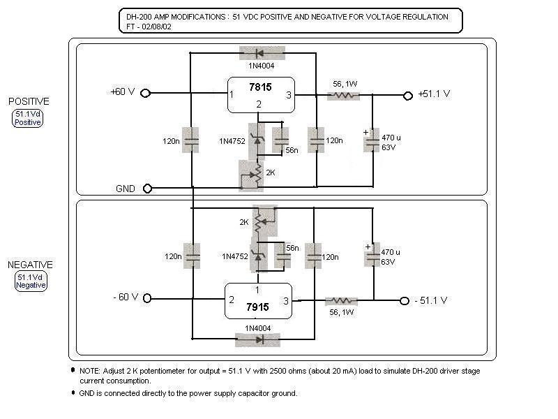

Regarding improvement, I guess that you have plenty of room to add a front end regulated power supply.
fab,
You are observant. The basic amp chassis is that of an early DH-200 version and the heat sink and 6 MOSFETs are from a P-230 or XL-280, but the circuit card is the basic one found on a variety of Hafler amps. Since most of the "sound" of an amp comes from its circuit card I thought it might be instructive to experiment with a monoblock and modified version of the basic power supply with minor wiring changes of the DH-220 to P-505 series of Haflers. The difference in sound between 4 and 6 MOSFETs per channel is slight, mostly in transient "slam" to drum percussives and bottom bass heft, but the basic character of the amp's sound remains the same.
The point I really wanted to make was the change in character of the DH-220 sound that occurred with PS upgrades. The DH-200 has its own sound and improvements to its power supply are worthwhile to do but they don't really change the basic sound of the amp. The DH-220 has always been bland to my ears but the changes I made seemed to help the "real" amp that was hidden inside to come out into the open and produce a much different and improved sound.
Bypassing the speaker fuse loop made a slight change in a DH-200 I modified earlier and this time I did not try a before and after. I just bypassed the speaker fuse loop. However, the speaker output of the circuit card now does go to the speaker protection fuse and then on to the speaker output jack, just as the XL-280 and DH-120/SE-120 are wired. This wiring still protects both the circuit and the speakers from major voltage faults.
Next will come a comparison between it and a similar set up with the MC PA-3B circuit cards, once I get a few more pennies saved up. But, it is interesting that no major set of mods have been done for the DH-220 -- P-505 series of amps that all use this circuit card. Is it that good or do people not care and prefer to go on to something different?
The is the other half of the monoblock pair:
Dick

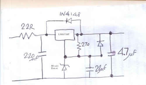

tchewtch said:I hope there is still some interest in this thread.
... Then I intend to install regulators for the front end. The cct I'm going to use is shown below.
I would appreciate any comments on this plan, from experienced modders, before I move on to front end mods.
Thanks.
hi tchewtc
Yes the driver regulator supply is a good idea for sound improvement.
I believe that the LM317/337 are adjustable regulators. The way you use them is not adjustable thus why not use 7818/7918 or 7824/7924 simple fixed regulators (probably cheaper). The 22 ohms input resistor is not really needed with these regulators.
Your input voltage of regulator needs to be at least 3 V higher than the regulator output to use the benefit of regulated voltage. What is your output voltage?
As Dick West indicated, for max efficiency the driver voltage should be higher than the mosfet voltage section. However, it is not the case in the original Hafler DH-200/220 amps. So if efficiency and max power output is not your primary goal but more the quality of reproduction, the regulated voltage at about 6 volts less than mosfet voltage section is beneficial. If you use an additional transformer or one with dual voltage (as the XL-280) with regulated driver voltage then you get max efficiency and sound improvement.
See attached circuit installed for several years in my DH-200 amps.
In another version I replaced the Zener with TL431.
Good luck
Fab
Fab,
Nice circuit. Is there enough adjustment in it to allow it to work with the 75VDC of an XL-280 transformer? What component values would have to be changed?
I have read that it is preferable that the output stage clips before the driver circuit. Supposedly some really nasty sounds result if the low level circuit clips first. Therefore, the circuit card should run at a higher voltage that the output section. So some experts tell me. . .
