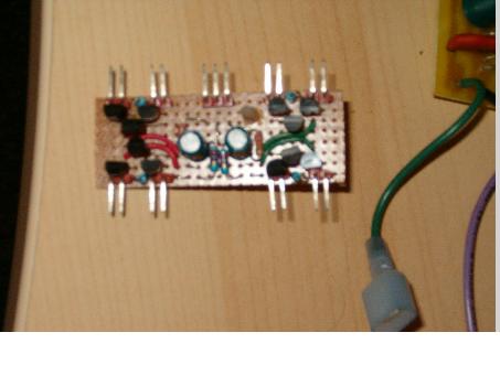

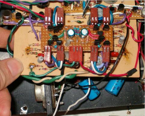

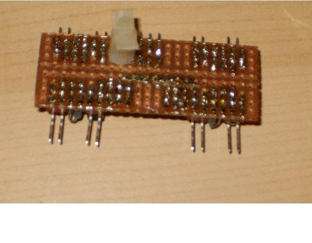

DH-200 cascode diff input stage
Rob
I cannot send attachments with your forum e-mail link.
Use my forum e-mail link to send me your e-mail address and I will reply to you.
Rob
Here is a picture of a symetric diff input cascode CFP stage using a cheap Radio-shack universal pcb #276-150A. Each 4 input bjts of the original mother board of the DH-200 are replaced with small wires (b,c,e) that go to the daughter board sitting on top of the pc-6 DH-200 mother board. The connectors shown on the daughter board for the wires are only for my first protoptype (except for the V+, V- and ground).
