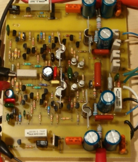

DH-200 New card Tests
Here are some news:
I have done some progress on the NO sym card for the DH-200/220 but I am not happy with the bench test results. I may continue later. By the way the Hafler SE-120 uses a NO sym card to drive lateral power mosfets too.
I decided to complete the already advanced SYM circuit that included my previously discussed mods. In additon there are some other mods that I could not do on the stock DH-200 card. A pcb is populated and bench tested with a +/- 28 Vdc power supply. Here are some results:
*THD at 1K Hz <= 0.02% (could be less but my home made meter is not that accurate) at Vac = Vdc -10V in 8 ohms (see scope screenshot)
* Rise time = 2 us (see scope screenshots at 10KHz Square wave)
* 8 ohms + 1 uF at 4 Vac (see scope screenshots at 10KHz Square wave)
* 8 ohms + 2.2 uF at 4 Vac (see scope screenshots at 10KHz Square wave)
Not installed in DH-200 yet so I have not listened to it.
I will post the scope screenshots on the next posts.
Picture of populated board under test:
It was not easy to fit all the components on a pcb of this size that fits in the DH-200/220.
I made 2 small mistakes on the pcb layout which I have easily corrected by drilling a hole to cut an extra trace and used a to-92 leg to connect to an adjacent point (missing trace).
Thanks for the nice comment. I put a lot of work into that circuit.
I am awaiting comments also from DickWest and Still4given who had already indicated interest in a pcb with those mods.
The circuit is the same topology as the stock DH-200/220/500.
The pcb is in fact "configurable": it can be the same circuit as the stock DH-200 pc-6 board depending on the components not mounted and replaced with jumpers. Or, it can include some or all the mods. The circuit shown includes all mods:
- input diff stage CFP cascode
- current sources with increased tail current
- Enhanced darlington VAS CFP cascode stage
- CFP front-end driver for output mosfets with increased current and speed-up cap
- Symetrical CFP VBE Bias stage
- Low overall negative feedback (< 40 db)
- Lot of local feedback for each stage
- Mosfets source resistors
- Regulated front-end voltage supply on the pcb
- Voltage reference for all cascode voltages
- diodes for VAS stage overload as in DH-220/500 pc-19 board
- No output choke but only RC network
- matched NPN and associated PNP based on HFE within about 10%
- separated ground points to return to a single star point
The circuit could also be mounted to correspond to my actual 2 DH-200 mod amps.
So far, I got only one board done. Unfortunately, I got more tests to do including audio test as well of course.
I did not really think about selling boards. This first board cost me about 150$ in parts (pcb alone was 92$!).

I always have an interest in mods to Hafler amps and like to look at schematics and evaluate different circuits. You obviously have spent a great deal of time and effort to develop your present modified boards. However, the costs you mentioned and the time it would take to source and stuff parts does make me hesitant to jump into another project. I hope you don't feel your efforts are not appreciated.
Personally, I have spent considerable time in the last 3 months evaluating several Hafler amps to determine which has the sound most preferred by me. As a reference point I use the Musical Concepts PA-3B circuits as installed in an old Hafler chassis. I have concluded I don't like a symmetrical circuit and instead prefer those that begin with a LTP, such as the MC cards and the DH-120, SE-120, Hafler 9130 and Pro 1200. This is just where I'm "at" for now.
Also, I spent the last 2 weeks listening carefully to a Hafler XL-280 amp with a symmetrical circuit and JFET inputs. It had a very clean and clear sound, great bass and highs, but somehow was tiring to listen to. It was just not as "musical" as the other circuits mentioned above. I wonder why?
If your circuit gets built by others and has favorable reports my interest will increase but for now I can't guarantee I would persue it.
One thing that could be of interest to me and perhaps others would be a schematic and parts layout for the voltage regulators for the circuit cards I see you have built into to your version. These little regulators, as "wings" to present cards, could be attached to and bolted underneath the present card and sufficient space should be available for them in a stock amp. Any thoughts on this?
Thanks for your comments Dick
I understand that you have a "crunch" for the Musical Concept board.
I think that you have a good approach too by comparing different circuits with same output transistors. I learned a lot doing that too...more than comparing too different amps.
Regarding the difference between Symetrical and non-symetrical circuit I do not believe that one is better than the other. The LEACH amp which is so much appreciated is a SYMETRICAL circuit. In fact I used several of Leach circuit idea in my new amp circuit. A non-sym circuit can sound bad and a sym circuit too or they can both sound good also. It really depends on the implementation details of the circuit. Also, I am sure that you will agree that a lot of appreciation in sound is sometimes more a matter of "taste" than true real performance of the circuit. For example some peoples do not like to hear the "defects" of certain recordings and prefer a more "rounded" sound to not hear the defects.
The LTP is also used in a symetrical circuit, it is just that there is two (one LTP per polarity) in the input stage.
Do not pay attention to the price because it is only the first board. With higher qty the price could be cheaper if required.
My first aim is that this is a personal project to improve the sound of my system and share my findings. If some peoples are curious enough to try it and want to share their opinion on the sound...As I have indicated in previous posts the peoples has positively commented my actual mods without knowing that my DH-200 amps had mods.

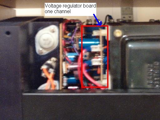

For the regulator circuit, I have previously indicated to send me e-mail since it is a pain to have the information segmented in different parts so it can be posted. I received several requests so far which I have responded. I have attached a picture of the regulator boards in one of my DH-200 amp. The board is attached with "glued" low profile posts on each side of the transformer. The electrolytic caps are quite high and may be hard to locate the board between the stock circuit and the heatsink.
