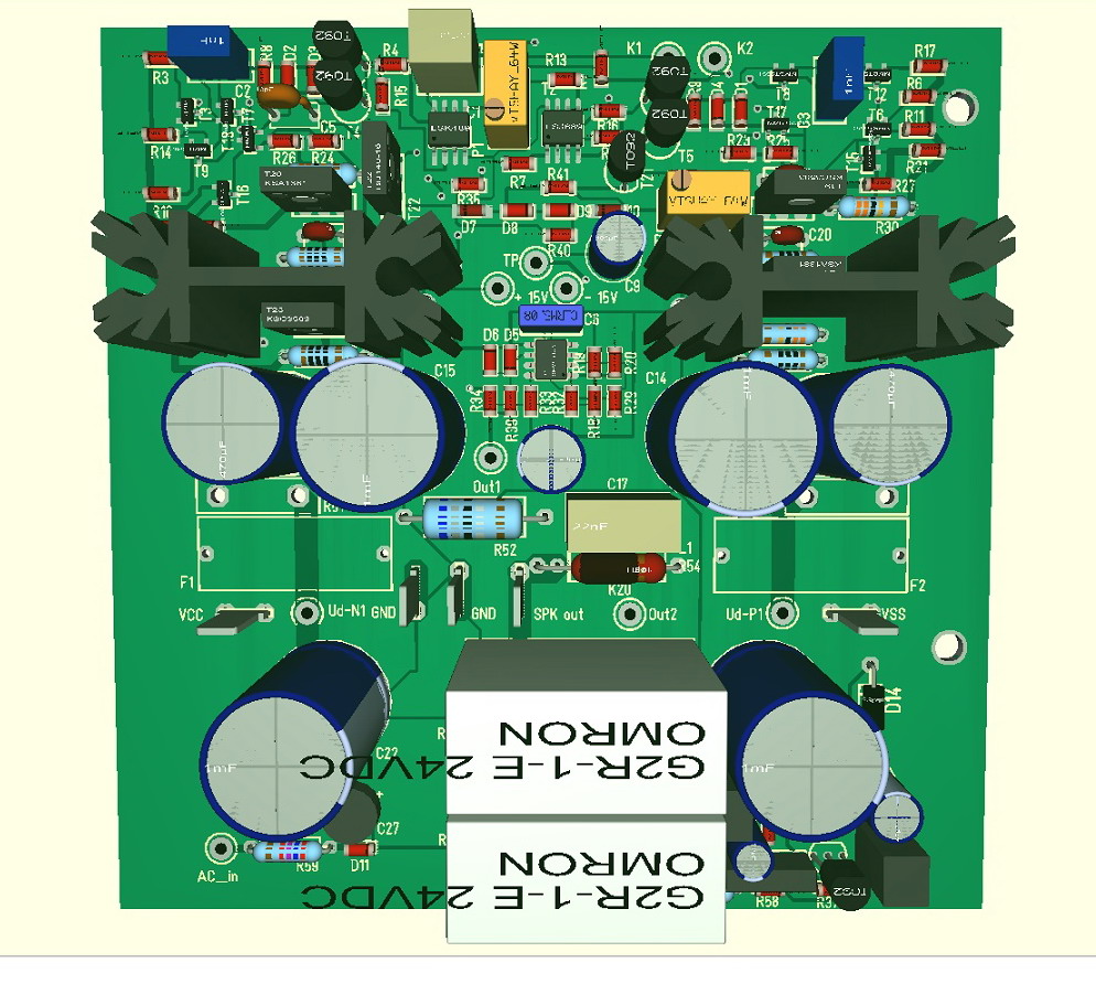

New draft of the DH-220C series
Hello,
this is my new draft of the Hafler DH-220 design, presented by Bob Cordell on Burning Amp Festival 2016. It is based on my DH-120C layout , but adapted to the physical size of the Hafler DH-200/220.
The DH-120C pcb is already in prototype production. Now it's time to get all components and debug the PCB design. with the experience from this work, i hopefully can finish also the other two designs, i already published in this thread.
Due to leftover space, i also realised a speaker protection on the new design.

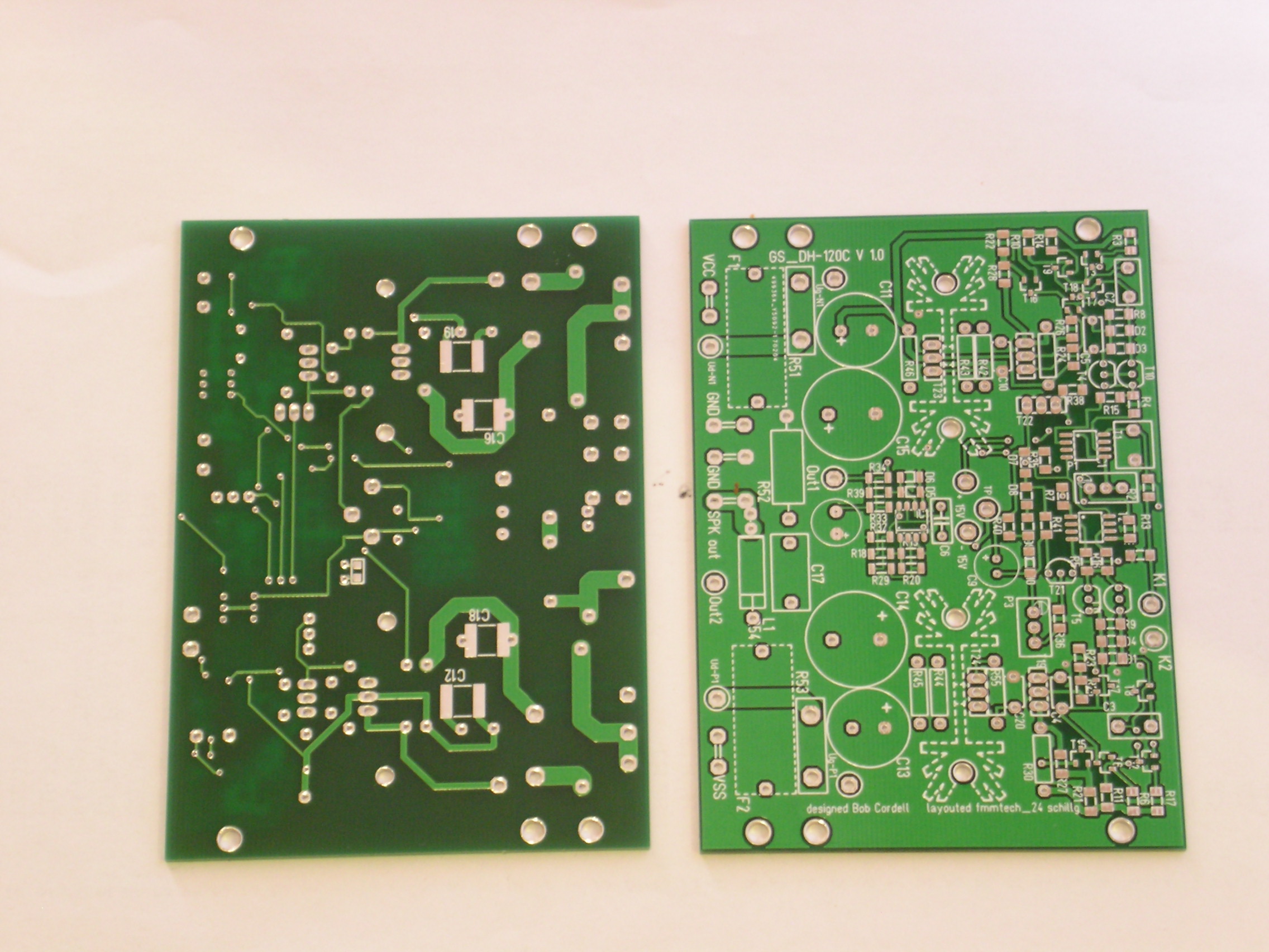

First prototype PCBs of DH-120C arrived
Hello,
today arrived the first prototype PCBs for my DH-120C, Bob Cordell's design of the DH-220C adapted to the DH-120. Now is's getting interesting, time to populate and test the boards.
One problem remains, i am still looking for someone in the US to order for me the LSK489 and the LSJ 689 (5 of each) at Trendsetter.com and send it as letter to me to Germany. Trendsetter asks for $ 35 only for shipment and the local distributor ask for more than double the price. So somebody out there to help me, every support is welcome
Best regards
Guenther

Looks good.
I do not think that it would be any cheaper for me in Canada. $35 for shipping to Germany is not that bad. It is a long way to go.
I went to the trendsetter web site and searched for lsj689, lsk489 they show stocking of lsj689 in sot-23-6,TO-71 and lsk489 in sot23-6,soic-8,TO-71. Looking at your pcb it looks like you used the soic-8 package for both devices.
You should confirm exactly what package type(s) that you require.
Where are you getting the rest of the parts from?
When I look at your post #1392 is see you had relays which I assume are for speaker protection and circuitry. Why did you not include it on the pcb that you designed. Instead I see fuses now? Why fuses, I hope that they are not used for speaker protection now instead of relays. It is is known that fuses add distortion to the signal, esp if they are not in the feedback loop.

Hello rsavas,
At the last time i checked trendsetter had LSJ689 in SO-8 case in stock, maybe have to wait, when again available.
The rest of the parts like minimelfs (diode and resistors) the MMBT5551/5401, 2N5551/5401 BD140, OPA2134 and the KSA1381E/KSC3503E are already there.
The board from post #1392 is a board for the DH-220/200 which is about 111mmx111mm. the actual board only measures only 108mm x 75 mm for the DH-120.
The fuses are the rail fuses according to the original design of the PC-25 boards from Hafler. The speaker protection didn't find place on the PCB and is done by an external board. Attached you will see the new home of the PCBs
BR
Gunni
Very interesting! are you making new PCBs for the 220 too???
My schedule is, first make the DH-120C boards work. Based on that, i wanna rebuild a board based on the DH-220C with integrated powerstage (2x2SK1058/2x2SJ162). And finally a board as replacement for the existing PC-19 (PC-6) board of the Hafler DH-220/200. So i think a long way to go.🙂
BR
Gunni
