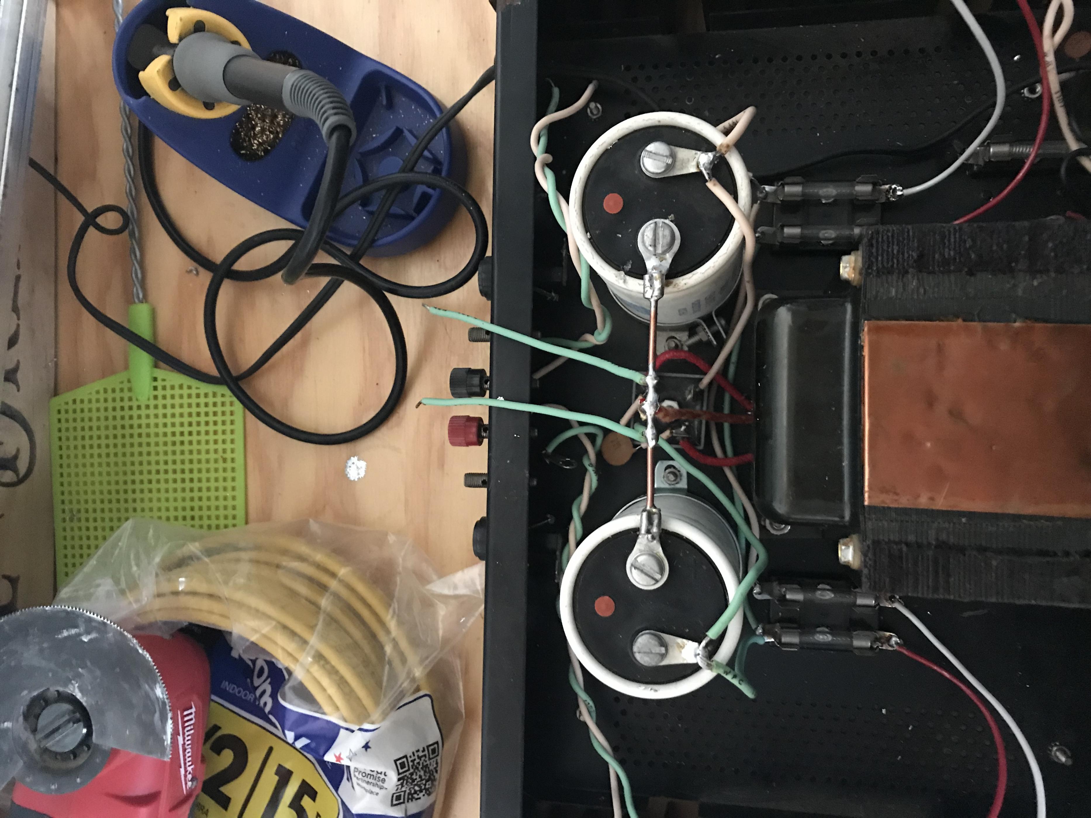

Picked these two up for $100. Neither worked. One had cut cord so it may be a loss. Looks like they’ve both been tinkered with a few times over. I started to rewire one and investigate some obvious stuff and here I am...
Gut ‘em and rebuild? Find fix and flip? Back to stereo (both mono) I you had these what would you do with them?
Can I just run the grounds from pin 6 straight to the center bar instead of the to the output and then the center. This is configured for mono.
I would maintain the grounds runs exactly as original. Changing things like that can run into trouble. However, do make sure that the three wires connected to the ground strap between the filter caps are all soldered together as close as possible to the center of the strap. Your amps show them spaced out. Back when I was a tech at Hafler, fixing that ground point was one of the first things we'd do to most kit-built amps.

The "centre bar" between the two smoothing capacitor is part of the charging circuit.Can I just run the grounds from pin 6 straight to the center bar instead of the to the output and then the center. This is configured for mono.
Short period high current pulses pass along this link.
Do not use this link as a reference for any part of the audio.
Instead take a single wire (twisted with the other two power wires) from this link to your audio circuit.

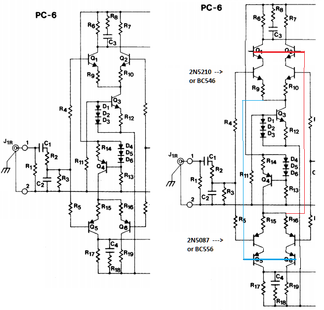

A cascode rewire
I used to fix and mod the DH200 back in the late 70's. Back then, a number of them were starting to generate significant DC offsets due to C-B leakage in the input stage. I fixed one by wiring in some other complementary small signal transistors I had (Motorola 2N5210, 2N5087 of Tiger amp fame) as new inputs, with the original transistors as cascode tops, like this:
This was done by just pulling the emitter and base leads of the original devices from the board and inserting the new added devices into the holes and twisting and wiring the arrangement with a few jumpers.
This put the C-B voltage of the (new) input transistors at around 100mV or so, so they didn't leak, even if the original high voltage input transistors leaked moderately. The DC offset dropped to nearly zero. When I started modding the amps later, I added an integrator and inverter circuit using TL074 opamps to form DC servos, making the cascode leakage fix probably un-necessary, but I assumed then (with no way to measure or simulate) that distortion would be better with the cascode. I don't have any Hafler amps anymore -- the last one I had developed a mechanical hum/buzz in its power transformer that was driving me nuts so I gave away the amp, so no way to measure anything now.
Maybe some here can comment whether my quickie-cascode arrangement was an improvement or degradation of the original input arrangement?
