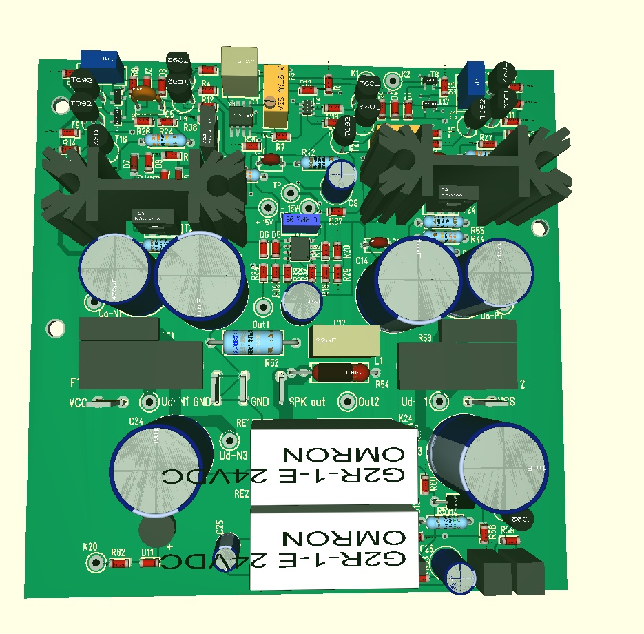

It would be pretty cool to have a nicely designed and laid out board made with modern smd components, that didn’t need a bunch of hacking! Just order the board populated instead of a raw board perhaps. Then just stuff in a few large parts and be done.
I have this DH-220C design captured and in layout.
If you look at Bob's proto picture, he exceeded the original board area, but there are no obstacles to interfere, just have to jumper across the area where the heatsink fits the pcb.
Bob's DH-220C design has a lot more components on it than the original, so smt would be an option. I might do it later after a more user friendly THT version. The jfets are cheaper in the smt packages vs the TO-72-6.
Selling partially assembled smt to the DIY community can have issues. For one, the person making them would have a hard time testing an incomplete assembly. So one could be selling untested partial assemblies. I would shun away from such activity.
This DH-220C is a tight THT layout to get into the existing pcb area. Need to use some miniature SFR16 type resistors in some areas to make it fit.

I was overlooking the developing part when I spoke of using smd parts.
The test fixture would be very complicated unless the electrolytic parts were to be the outer most components, where the holes could be picked up more readily on a fixture. Probably way overkill thinking for a niche item. I’ve seen medical projects held for a long time due to inadequate fixtures like that, probably not something appropriate for this!

That’s a nice looking looking board! It’s a shame you don’t have an amp to try it on.

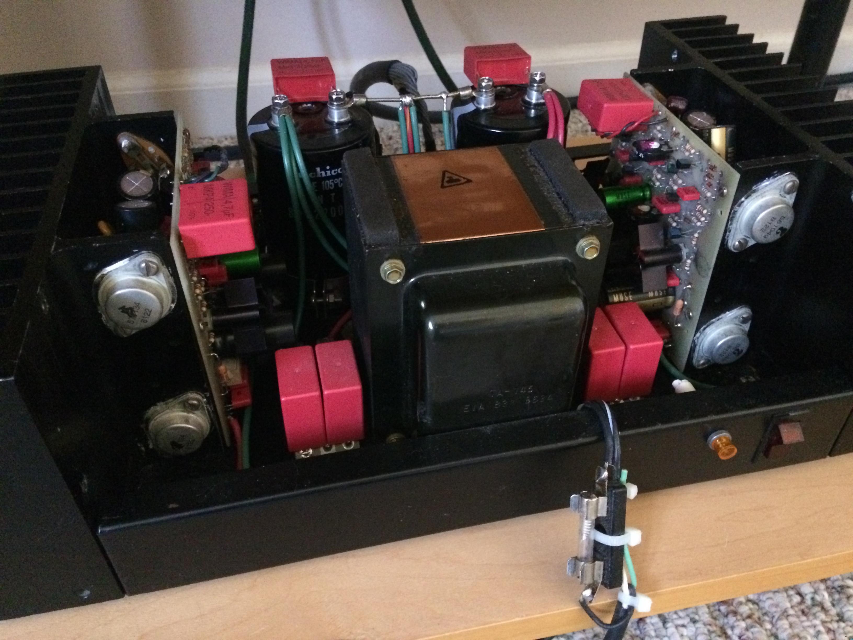

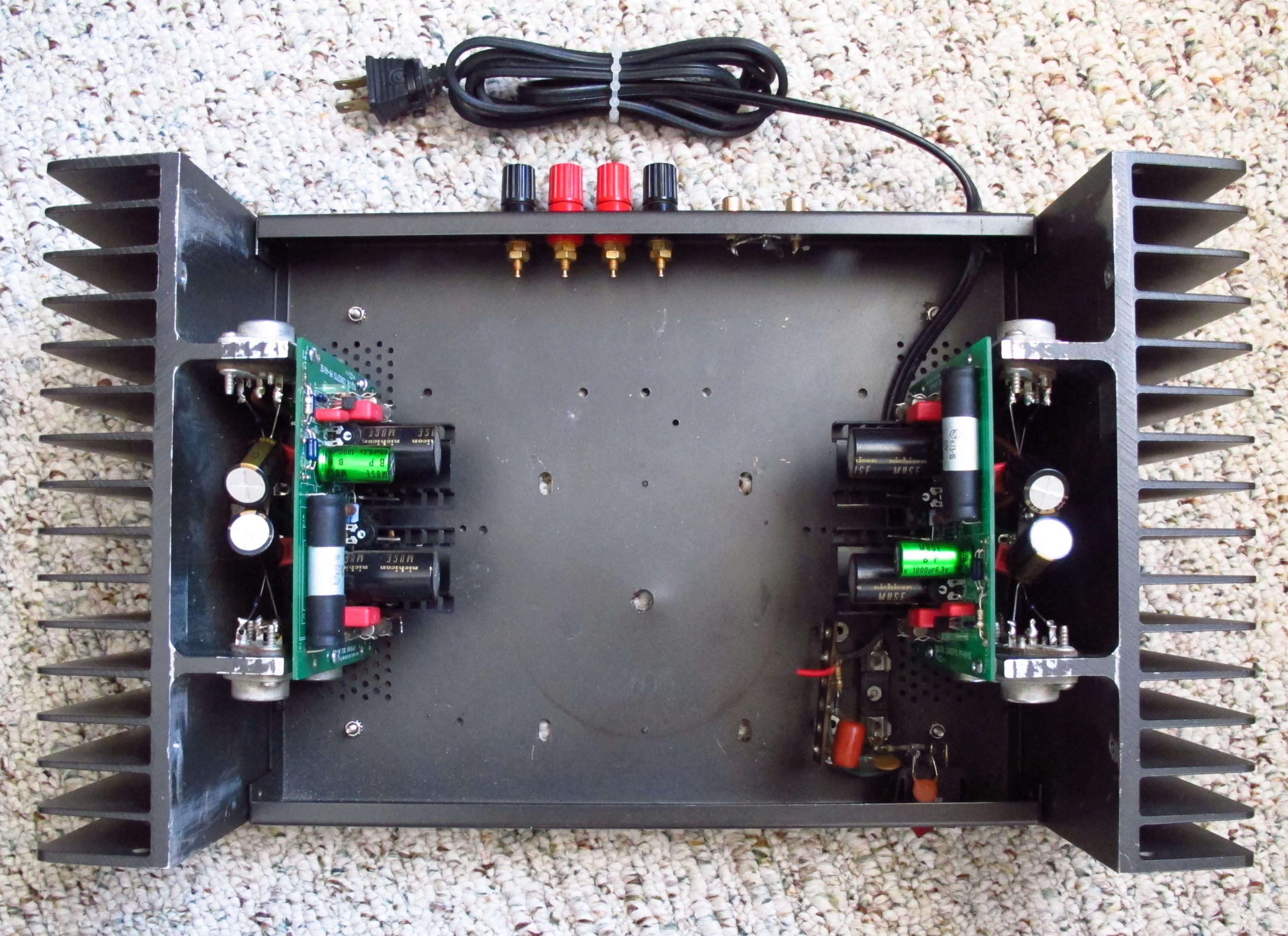

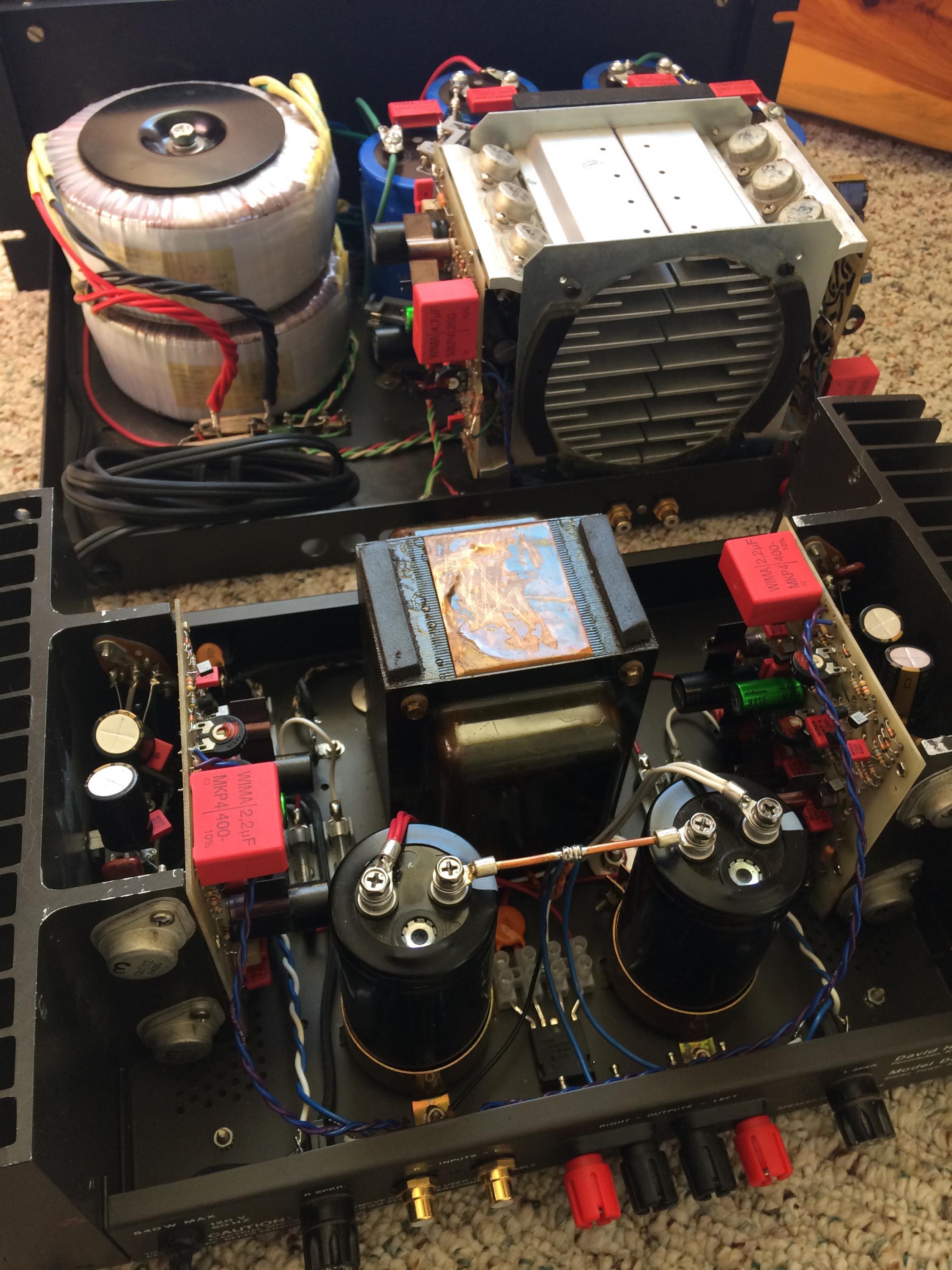

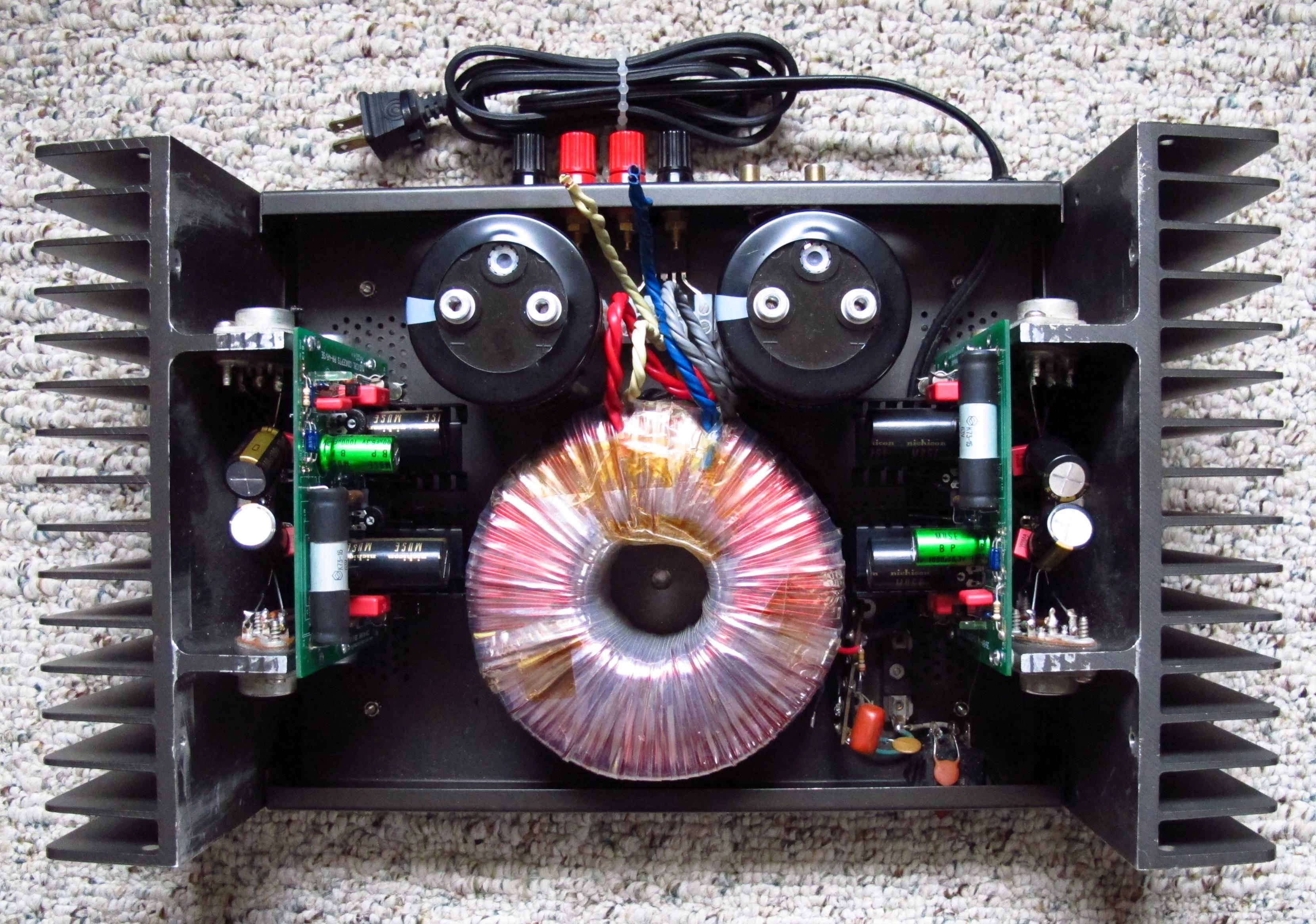

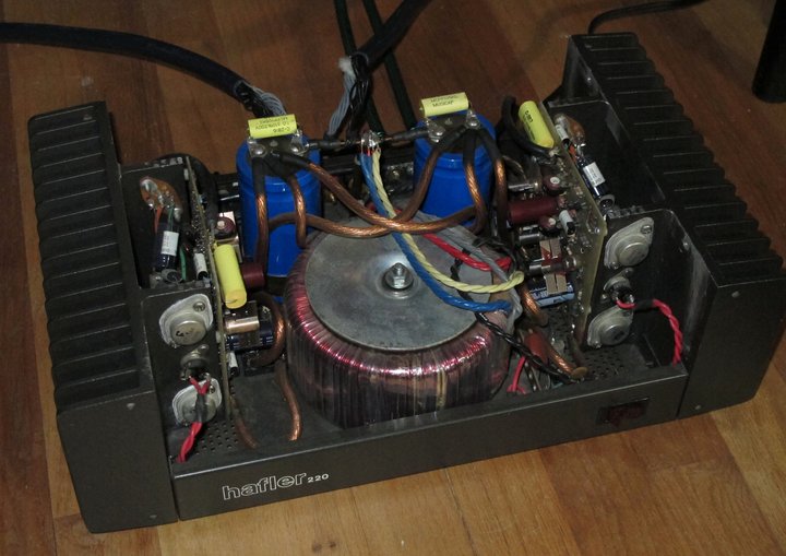

"updating" my original DH220

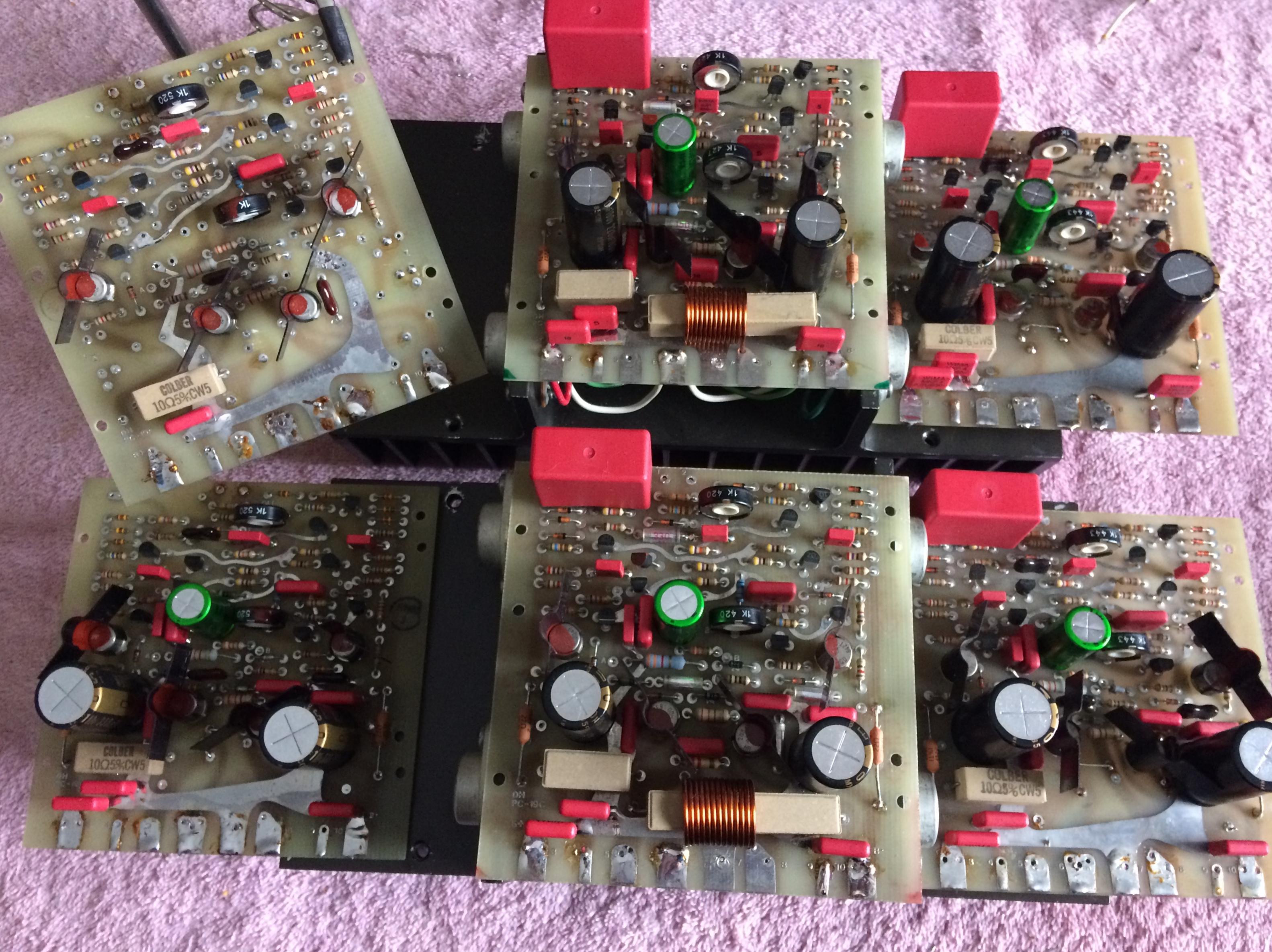

I have been thinking about this, what I would do to my original 220 for over 35 years, last listened to it in 2011, against my Mark Levinson No.336... sold both it and my No.29, the "Hafler' based amps 'are good enough" ~that good~ honestly sounded more open and got out of the way of the music better my other amps, nearly all other amps. In spite of a love affair, an affinity and deep understanding of this amps series
I used this old amp to learn and model, installed multiples of Musical Concepts / Hafler driver board mods, versions they used offer as kits. This particular one has the Beta Matched front end transistors... Is / was an amp slayer in the day. I used alternatively with NYAL Futterman OTL-3 amps... The Hafler, for the every day use (mostly) Summer amps; In the day I would have friends bring over the Big Boy Levinsons, Rowlands, Audio Research behemoths along side this modest Hafler... it unflinchingly held its own, I always had a clear mirror to adjusting and adapting performance.
I used Monster Cable 10g (it is what we had) for the DC runs, twisted Sound Connections / Vampire Wire to speaker out. I gutted the chassis, kept my original Tiffany RCA and 5-way BP, captive AC power cord and power switch. Probably will wire DC in larger Gauge solid core.

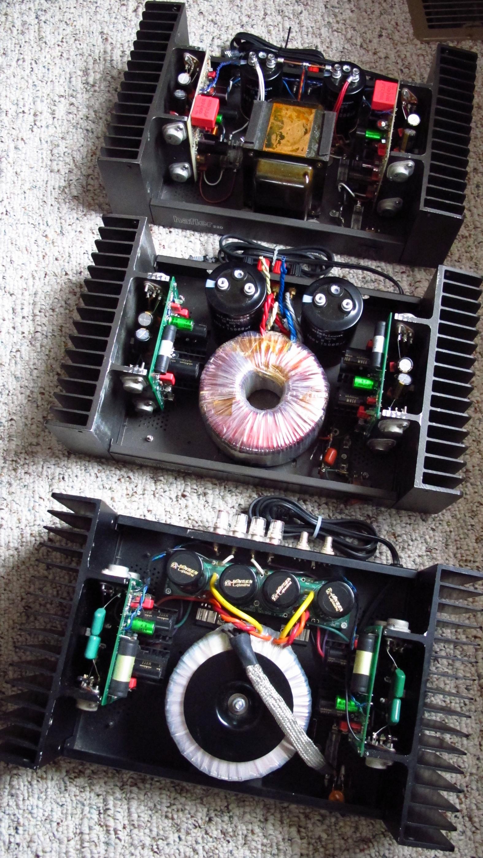

Image 5: three amps in a line up... At the back stock'ish MM220. The middle is my original MC220, as I imagine it. working to fit and layout the parts. The 62.5mm caps ~plus~ the toroid makes for a tight chassis ...power supply wise... 4 caps, as dual mono on image 4 are sadly out of the question. My principal challenge is the Left Channel side electrolytic, is (either) near - speaker terminal or the Driver stage heat sink, ideally 2mm away from each ...and... the other is positioning the capacitor mounting brackets, where the 6 bolt positions do not create havoc to nearby things, squished together... not my ideal. the 62.5mm, 22,000 mfd, way outperform the 51mm stock size, enough to warrant the extra work on the chassis pan.
I will compare the middle amp, to the 3rd (bottom) amp with the exemplary Jensen 4-pole caps... frankly, I am trying / working to mirror the performance of the 4-pole to the point to point wired 'can type' power supply, with both using the [4 year old] Musical Concepts PA4 driver boards, I have owned and used them as a much trusted reference for building. Mostly for modeling power supplies. (another story)
