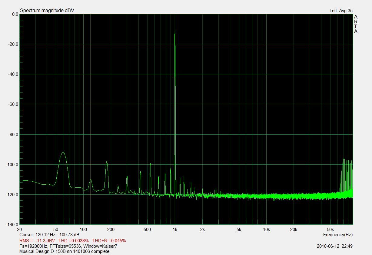

Musical Design sourced parts

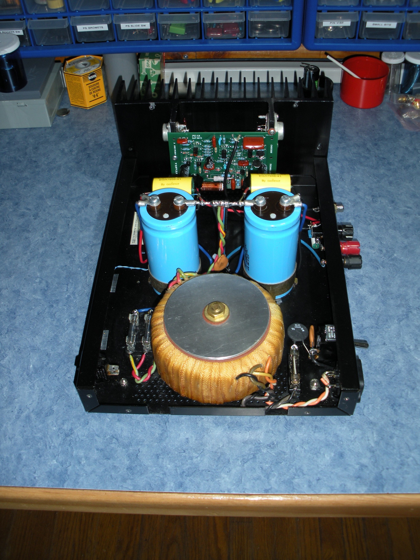

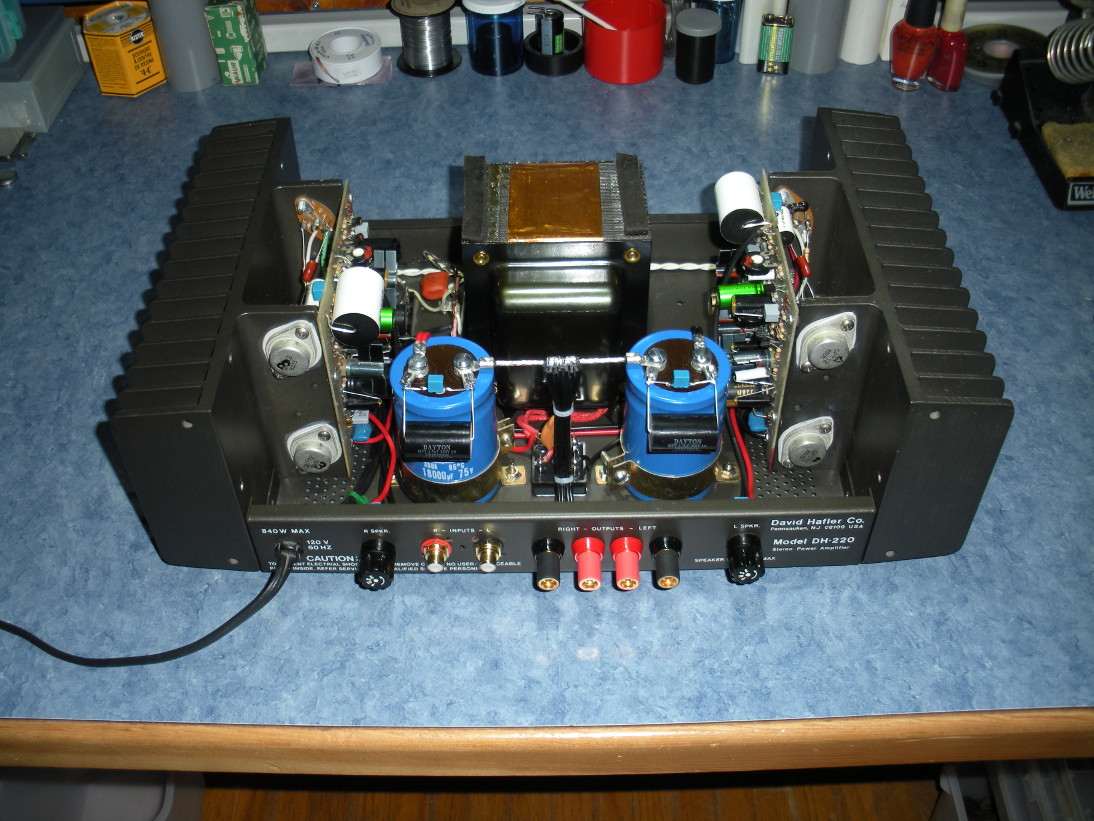

The transformers, are 'plug in replacements' (spec wise) as you can imagine, the amp has a narrow range of what will fit... so 'going bigger' is not an option. 625VA, 50volts, with dual center tapped secondaries, primary can be wired for 240/120. I do not have the current measurements.
The toroid shown, is from, was purchased in the middle 80s, it does not look like the current offerings of Musical Design Transformers
The [Jensen capped] 220 shown in prior post, shows a more 'current' power transformer / parts.

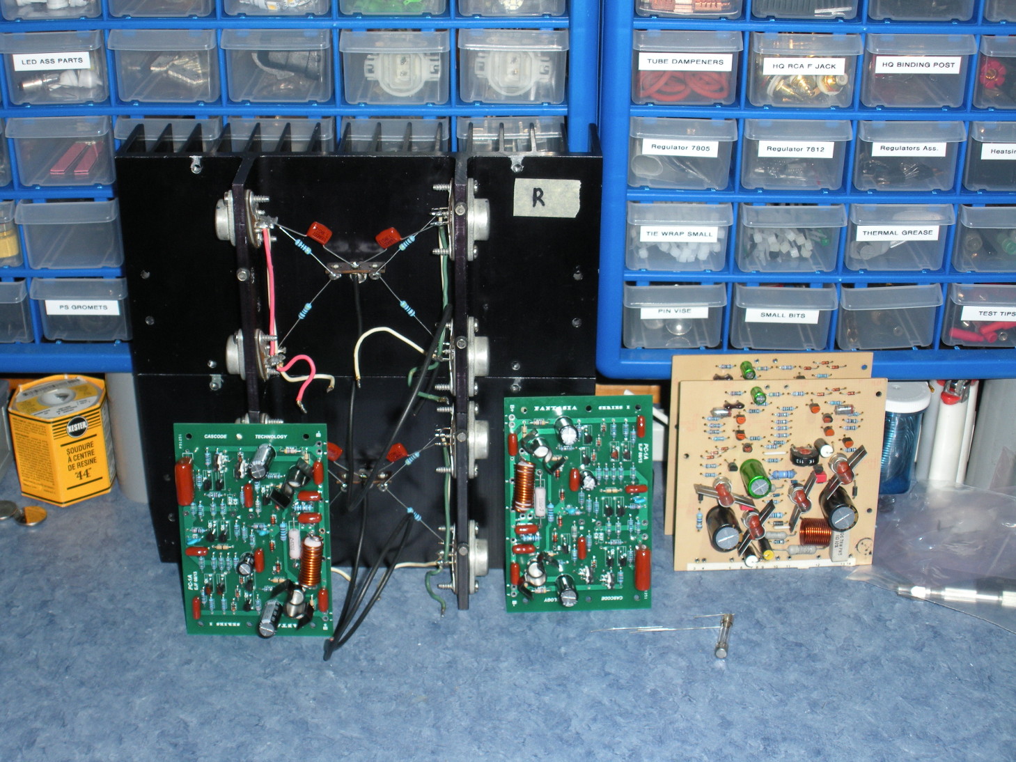

Here are a few photos of some of my past builds.
All of the amps I have built contain various mods, most of which I have learned from this valuable topic, thanks to Fab and other contributors.

Besides the various DH200 and DH220s I have worked on, some of the other amps that I have personally lived with and was able to compare to are Threshold S300, Threshold S300 MK2, Threshold S500e, Hafler Transnova 9500 and a Class D audio amp.
nice series of amps...
Hey msb64, very nice assemblage of your amp work. KUDOS! nice work.
For me building in multiples, allows for direct comparison of many different ideas... making the path of progress very clear, in terms of hierarchy of importance, where to spend the money and time... allocating resources.

Hi Ozark HiFi Doctor,
I'm not trying to start a war here, but I have direct experience with both the stock Hafler amplifiers and preamps, and also the versions designed by John Hillig. In every case, the original Hafler circuit is superior. The preamp designs are quite frankly completely botched, and are actually Hafler circuits with the buffer stage removed! The parts weren't even matched closely enough. The same issues go for the power amplifier designs.
It took a bit of work, but I was able to make the preamp stable and sound better. I had to increase some transistor case sizes to lower their case temperature as well as lower the standing current. The dual power supply option was just plain stupid, and improvements to the regulators allowed a single outboard supply to be used.
The Musical Concepts amplifiers mounted the main filter capacitors upside down using the terminals for support! In addition, I had to make some small circuit changes and completely rework the grounds to make them listenable.
My honest appraisal would be to avoid these "upgrades" like the plague. You can do better by properly servicing those original boards, and by matching the transistors. Its the matched diff pairs that make a Hafler (and most any other amplifier) perform at the high levels of performance you are after. There is no need to greatly increase the supply capacitance. Stick with capacitors that fit in the original clamps. Use original sized capacitors on the PCB, higher voltages will give you a better quality capacitor. I can't stress enough how far matching all the transistors will bring you.
Hi Rick,
I'd love to see your work sometime. I don't have a hafler 200 or 220 in here at the moment, but if it is the same schematic you should have a winner there. Did you use any of the smt matched input pairs that are available? That would boost performance. I can match smt transistors, but it is a giant pain in the rear end to do.
Hi msb64,
I don't recommend bridging amplifiers, and the Haflers are included in that statement. You will cut your damping factor in half right off the bat. If you want a real positive boost in performance, go with an electronic crossover and run each drive off it's own amplifier. You will gain in efficiency right away, and the drivers then enjoy full damping. If you do that, I doubt you will ever go back to a normal setup in your main listening system.
In all cases my comments were backed up with measurable improvements and client listening tests. Now I'm using the RTX 6001 for measurements which shows the changes in greater detail. Look at the attached results for his own amplifiers! You can see a drop in the noise floor, and all of the additional spikes in the "as found" tests compared to the completed corrections. I did not change the schematic on this. The improvements are in matching the diff pairs and correcting the ground wiring.
-Chris
Hi Rick,
Hi msb64,
-Chris
