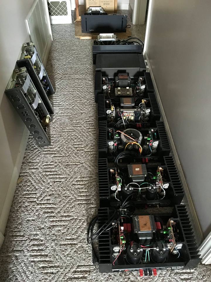

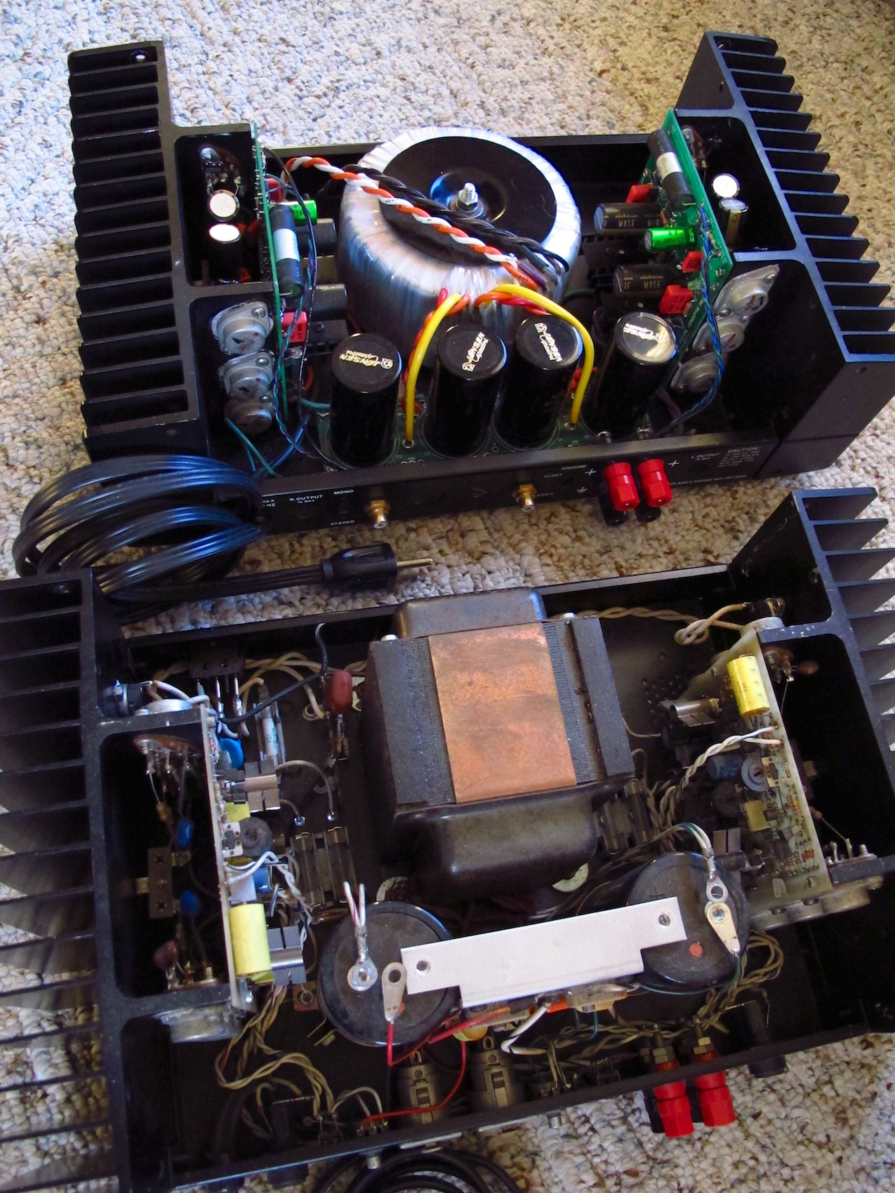

Of all of the choices, the MC-220 Musical Concepts PA4 boards [and honorable mention, MM200 Franken'amp with PC19c] driving the Maggies, produce such intense room compression, with an immense and coherent sound field, also 'seem to have unlimited power' (a sort of conundrum, to me). I have had concerns of equipment and hearing damage 😉 I can play this system far louder, than "practical listening" or that I would have imagined, ever dreamt of... I do power listening; in or for short periods;
Typically with most 'smaller amps' (for me) it often causes me 'nervous listening' worrying about drive levels... The 'optimized' Hafler DH200/220 based amps are amazing, challenge many other designs, each with their own merits... personalities. Most of my work / interests have been on power supply work, not trying to re-think circuit design or rebuild exemplary engineering.
The 6 MOSFET output versions in front, while they are amazing, they are in some ways challenged by the 4 output versions, power aside. The "Hafler 500" having ~15 volts more on the circuit, adds to the amps tonal weight and sense of authority, which the front left P230, (6) output version of a 220 does not mirror, *but it has a likeness... especially on the 'big' MG-3.5R panels.
Each are winners in their own right... Honorable mention to the heavily torqued Adcom 545II, gotta have a bi-polar design in the mix...

One of my next projects...
actually one of several. projects. (a good thing, not a complaint)
P230 with balanced inputs, such a gawd awful front end / interface musically, it's ~ ALL GOTTA GO ~ The front end music homogenizer... cringe. It is apparent how they beefed up the front end AC power and over temp sensor circuit (I rip all of that out anyway) but nice to see they finally figured some basics out this far in the game.
I am going to take my time and think on this, maybe build as a dedicated sub-woofer amp, use the [above pictured] Jensen capped amp on the top end...

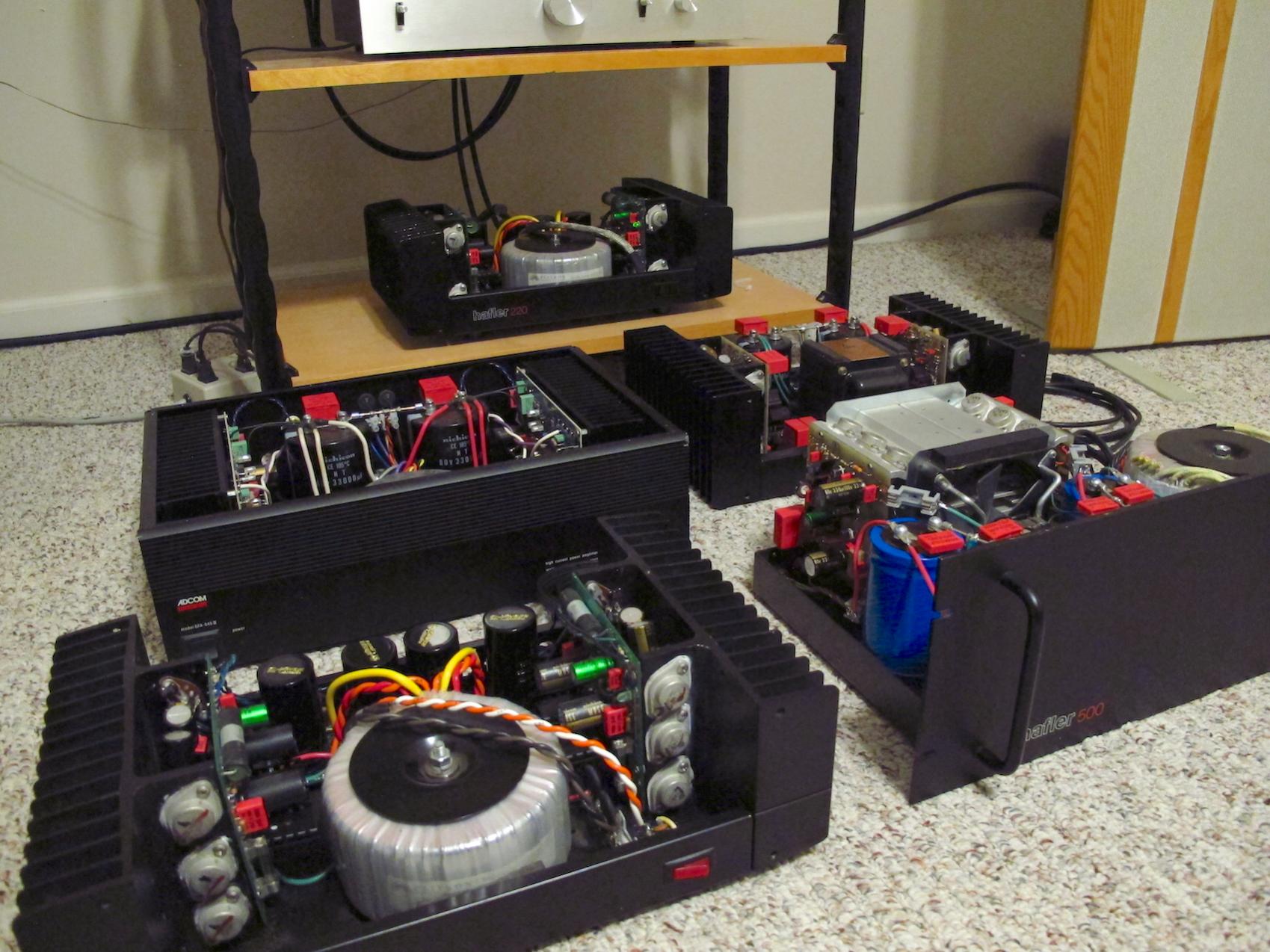

Good point Fab.
My Betas have a servo box to control the bass drivers, and all other drivers on the mid high towers have plenty of adjustments on them as well.
Over the years I have flipped a bunch of different amplifiers into place during tests, and take for granted that I can make the necessary adjustments, but I forgot that not all have the same capability.

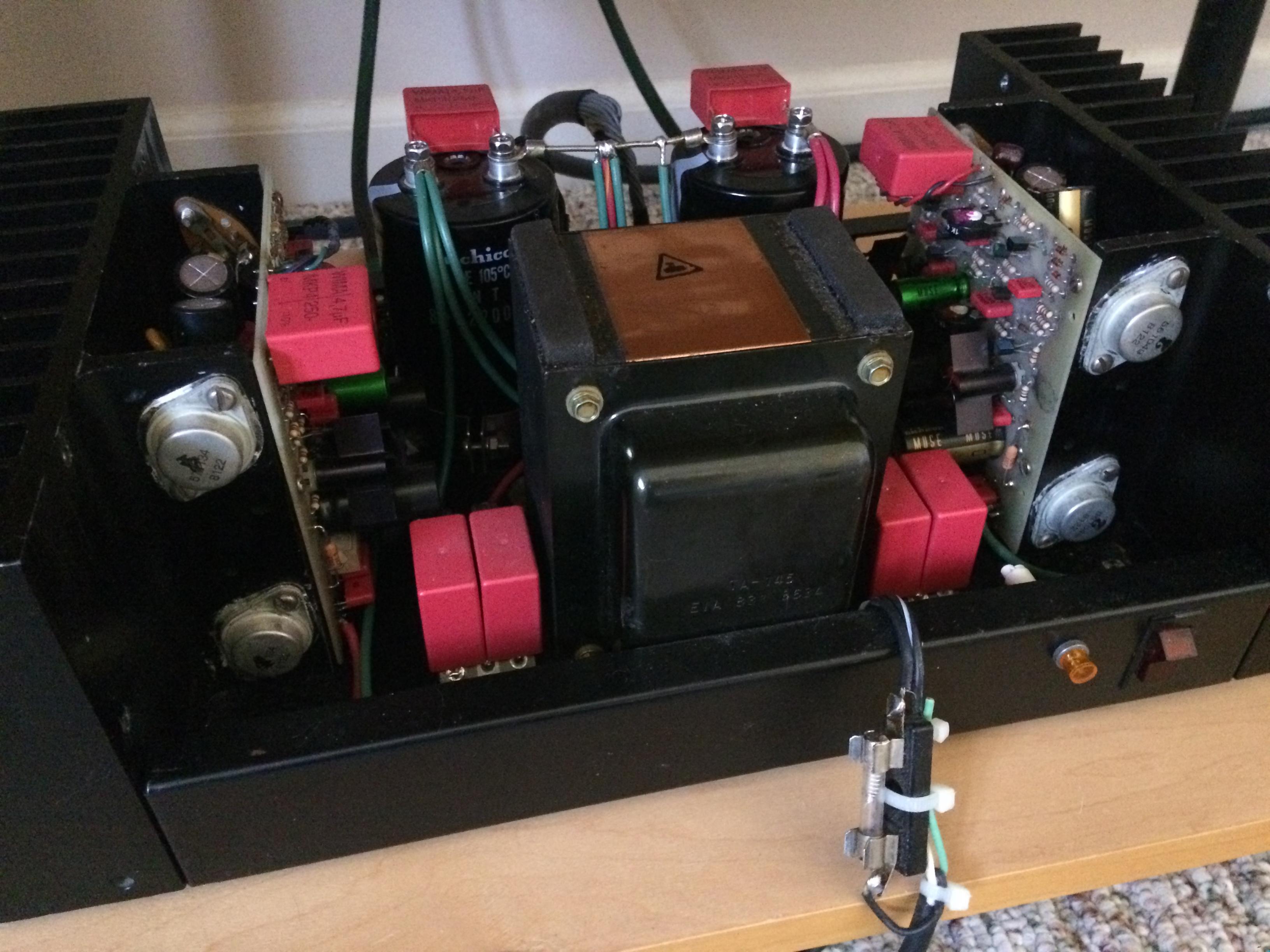

I agree that power supply changes make significant differences on the DH200/DH220 models as you describe, found that out when I did my first mod using the Pooge2 article.
With that I did an outboard power supply with a DC umbilical cord and it worked quite well.
I also know what you mean by clean but scary loud, there have been a few times when I had people over doing some upgrade listening tests, you turn to talk to the other person and you see their lips move but can't hear them 🙂

Btw Ozark, those are nice clean looking builds.
What brand are the square red caps you are using, are they Wima MPs?
There was some talk awhile back that running 6 outputs per heat sink was pushing the limits it if the bias current was turned up high. I remember even back in the early days some where pushing 425mA and possibly higher.
future projects...
Hey (thanks) msb64, I appreciate the comment, your understanding of what I am doing and the topic.
I used the Wima brand, have every value from 1000pF to 10mFd, in every lead spacing, from 5mm to 27.5, so I can fit them in many applications. I use them mostly (nearly entirely) for PS bypasses. I chose them, for scale of economy, occasionally use for coupling, as the big juicy exotic axial lead film caps would consume my budget... especially when working across multiple (10+ amp chassis alone) The Wimas have proven to be as consistent and neutral as any cap (with a sensible cost structure and range of options) that I have used.
My next project is to build an identical Franken'amp, 'mono' power supply, pulling fuses and only powering one channel, devoting the single supply alone to driving it... as a proof of concept to see hierarchically where the resources are best spent. I would rather have [magnetic's aside] 2 radical / identical stereo amps, (better for resale) than on a dedicated box... though I suspect the external supply will prove itself out. The dual stereo amps lends to prospect of active bi-amping, running one amp per side... like '2 channel mono amps' I realize a botched expression.
6 output, amps... I own (2) P230, (1) XL280 and (2) MC500 amps. I have experimented... but have much to do... beyond 4 output amps. A whole other topic and chapter, still being written.

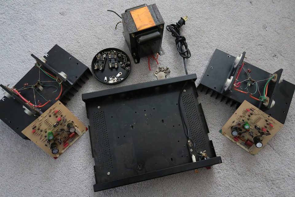

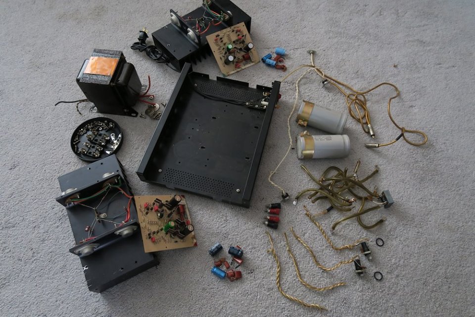

This is what an amp rebuild represents to me...
Scrubbing DIY audio boards and hard drives. Going over amp pictures, the pathways to now. Interesting to see the progression in builds and (frankly, the quality of my work) A friend and (I) built this amp in 1981-2? It needed to be recapped, reworked with 'modern parts'. I had a strict budget, so the work was modest... with considerable budget being I/O jacks the old 'had to go'
The discard pile was considerable, oxidized wire, original parts, wretched connectors. I built this like new, even though it was a lot of work (I did not charge my friend a penny) it was nice to have another chassis to experiment on... I like build them, as much (maybe more than😉 listening to them.
I see the debate over wiring. I have never had a Hafler amp over heat (as astutely expressed elsewhere) the front end thermal protection circuit [serving only benefit insurance/warranty purpose] is a such music and dynamics robbing prospect. Besides, I .hate. having AC / magnetics / noisy mess in the chassis.
I have also omit speaker protection fuses on all but one amp (over nearly 40 years of building, and making them sound better) My buddy literally nearly shed a tear, the first time he heard this amp... he was somewhat of a disbeliever of better parts and layout efforts... he got it.

Ozark, I know what you mean by oxidized wire and see it in your photo.
I also received some Hafler amps that had been built back in the day with the old tinted/transparent Monster wire, which definitely did not age very well from an asthetic point of view. As a matter of fact I still have some of that old Monster wire around from back in the day, for awhile it was the rage. After time it does look awful even away from any heated joints. It is cool that you have so many past builds, wish I at least had my original Pooge2 build.
The speaker fuse delete is a touchy subject for sure, back in the day I remember some would use brass slugs in the fuse holders and that was scary too.
For my recent builds, I put the speaker fuses right on the positive outputs and keep the fuse on the smaller size to protect my speakers.
I'd rather change fuses that replace hard to find and very expensive emims and emits 🙂

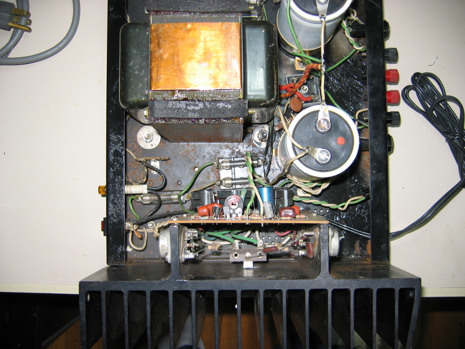

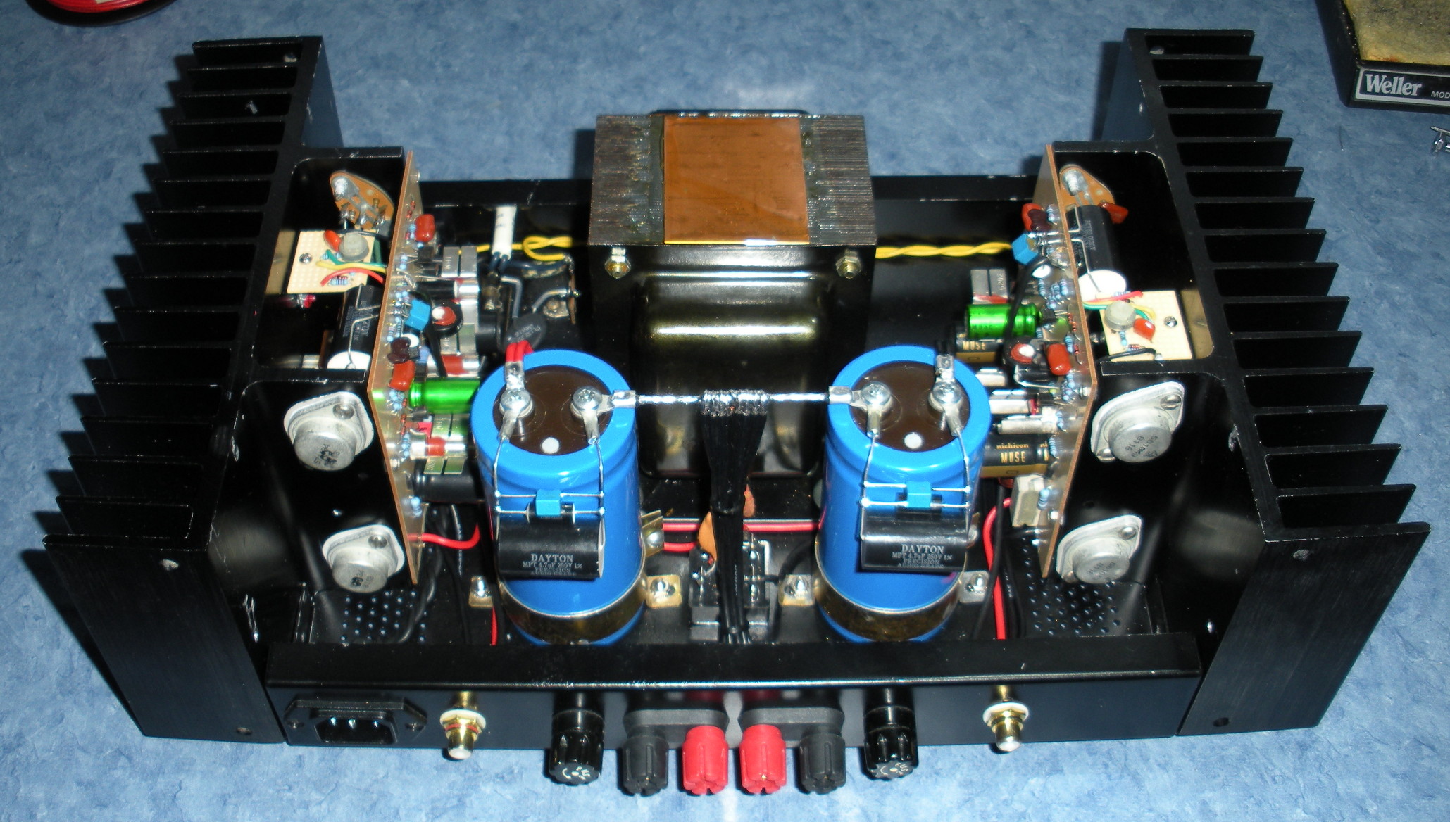

Ozark, here is one that I affectionately called DH200 Turd.
The chassis was heavily rusted and pitted, and someone spray bombed it to hide some of the rust. As you can see plenty of rust is still visible, which led me to believe that it may have been in a flood somewhere. Needless to say I did not even test fire that one, just took it apart as fast as I could. I had to toss a lot of even plated parts like fuse holders, and ended up sand blasting the chassis to make it usable again. I also had to remove overspray from most of the components, boards, heatsinks, outputs etc too. It took a lot of work but as you can see it turned out nicely, and is now playing music on a friends pair of Infinity Kappa 8s. Fortunately he also had a Halfer DH101 preamp, I overhauled that as well for him with updated components and cleaned up the wiring. It made for a nice vintage combo that was quiet and had power to spare, easily handling the Kappas low impedance loads.

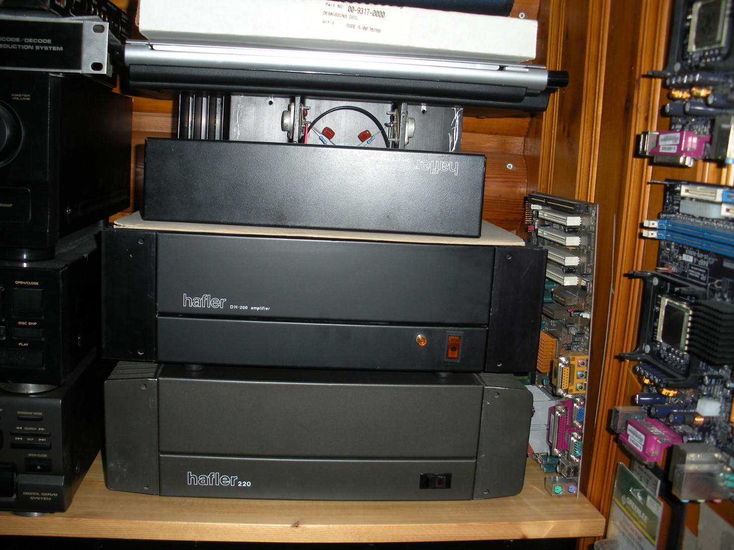

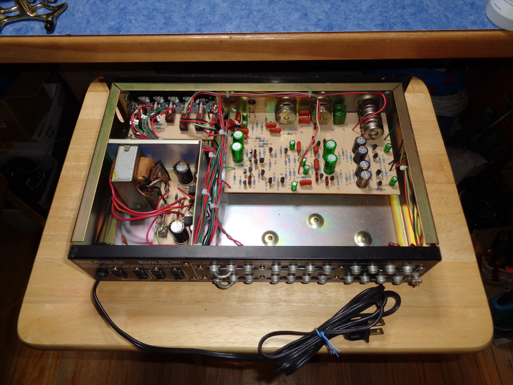

Besides my built amps, here are some of the left over parts that I plan on assembling when time permits. Multiple boards, heatsinks, chassis etc etc. I kept the original TRT Wondercaps from my original Pooge2 build, and would like to put them back into a build, although they are large and hard to properly support. Every 80s and up Infinity speaker and crossover/servo box I have looked into has had the same caps in them, I even had a Mod Squad cd player back in the day with them inside.
I looked through my photos but couldn't find any photos of a DH220 that I picked up years ago on eBay, it had massive Monster wire throughout it and was an absolute disaster waiting to happen. The large possibly 12 gauge output wires were soldered onto the board bottom edges, not through holes and supported only by the solder. Also the clearance between the bare ends of the wires and the chassis was maybe 1/8" at the most with no attempt at insulating at all. The amp did have some nice components in it though, so it was another one that I just took apart without testing.

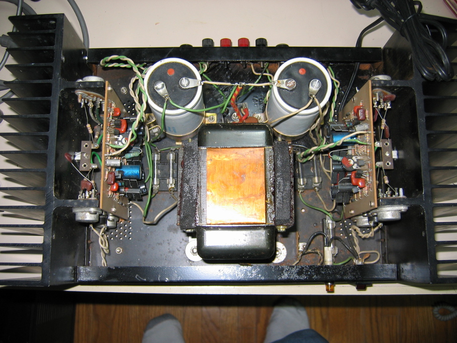

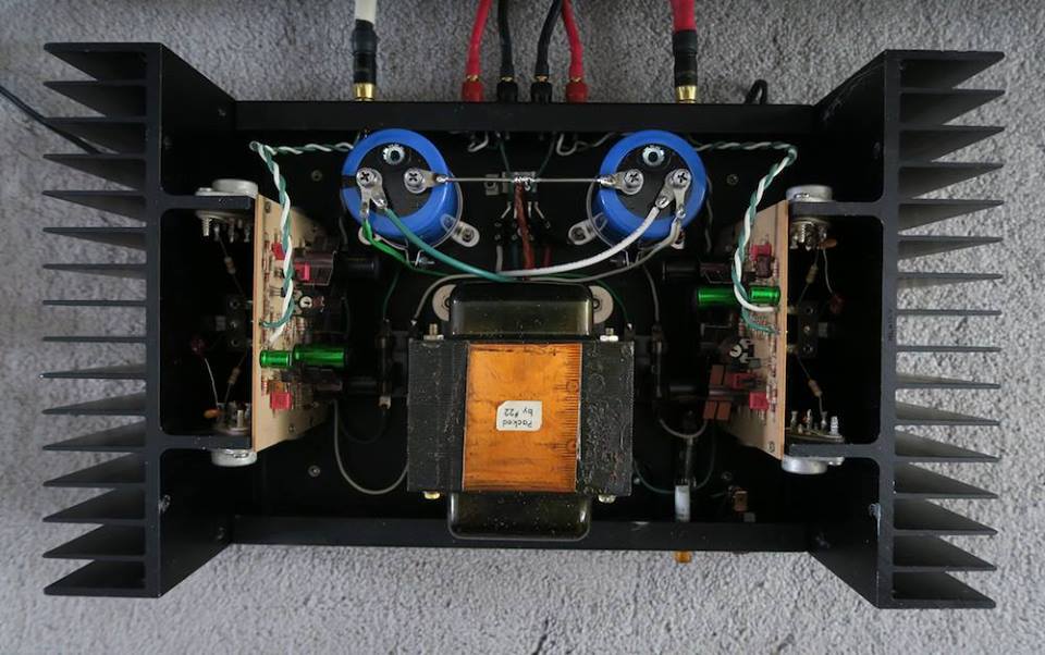

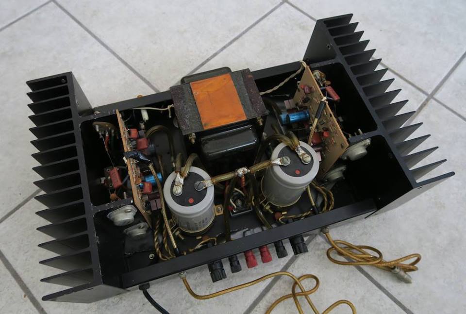

My DH200 (was named ungly duckling)
My heavily WIMA capped MM-200 was originally affectionately nicknamed "Ugly Duckling amp" it was so beat up, when I got it.
It was transformed to Franken'amp when it challenged a Spectral Amp, at fractions of its cost... my friend owning the Spectral was in denial by the comparison...
