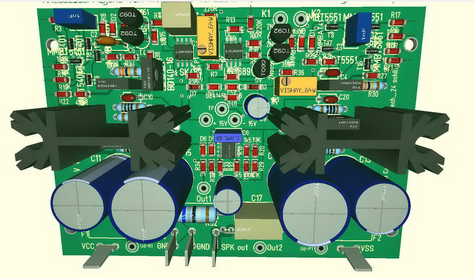

First attempt
The first attempt of Bob Cordell's DH-220C design adapted to the physical dimensions of the PC-25 board, built in the Hafler DH-120, is now in PCB production.
I am really interested, if and how it works .🙂🙄
Thanks again Bob for a great work
BR
