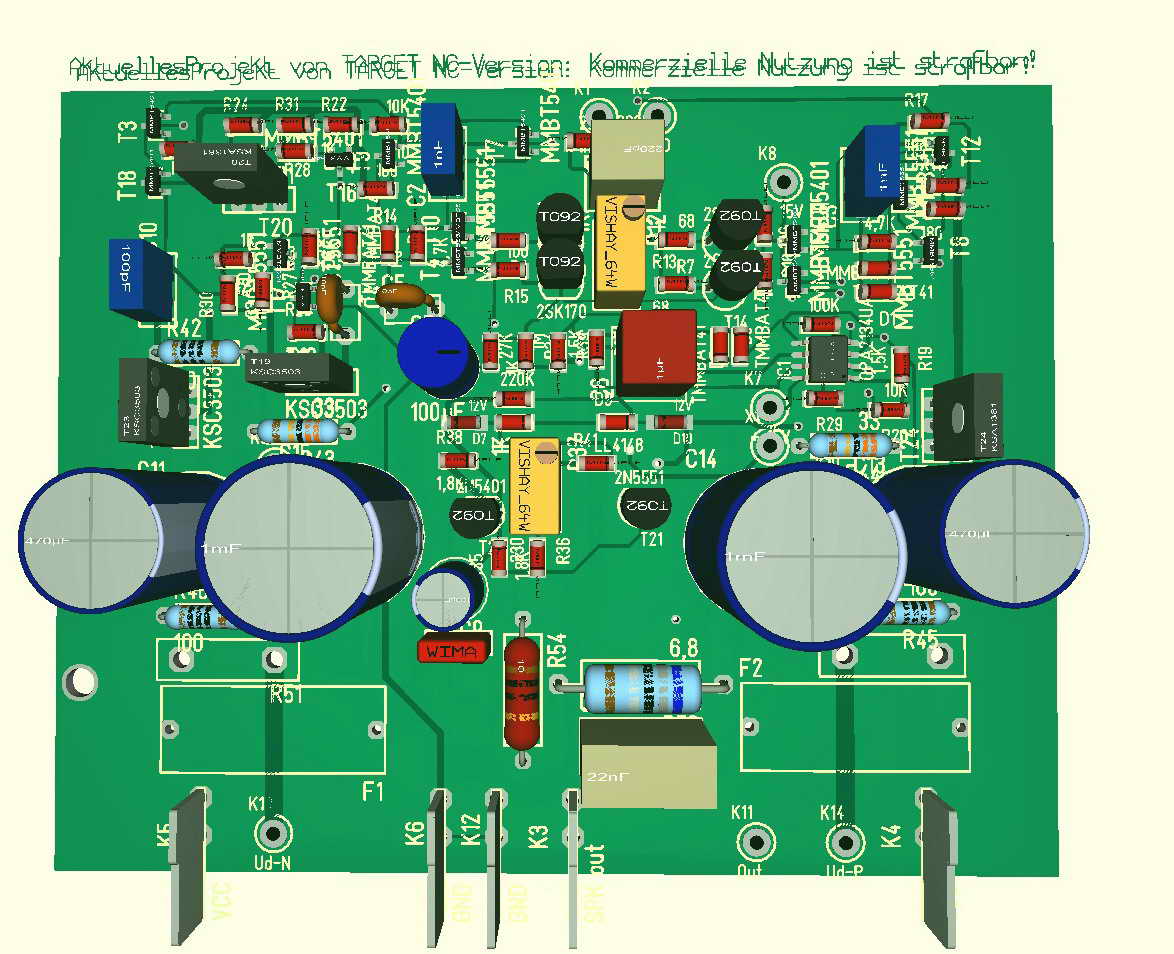

First teaser for DH-120C
Here is the first attempt and teaser of a DH-120 (PC-25) board, based on Bob Cordells design.
I will put it back in my desk, and in about 2 weeks i will go and review it again or cancel it, and start new again.

cool
a little hard these on old eyes.
i'm curious - looks like you're using a pair of singles vs. monolithic duals for the mirrors?
mlloyd1
Thanks,
as i wrote it's only a check if all device fit on the original board size of the DH-120. And it looks good for my 2 DH-120 to get tuned up, that i can still modify the placements.
For the final version it's planned to use the monolithic duals, but there i am struggling with two points.
a) i must create a symbol of the SOT-23-6L and/or the SO-8L version of the dual monolithics for my PCB layout program.
b) the availability of the LSK489 and the LSJ689 here in Germany. The local distributor asked for €120 for 5 of each device. So i must find someone in the States, who will buy these for me at Trensetter and send it to me (prize in US is about $60 +S&H).
The major plan for me is building a DH-220C with onboard 2x2SK1058 and 2x2SJ162 , since i have 10 genuine Hitachi ( no Renesas) pairs left over.
BR
Guenther

Here are a couple of things worth noting that I did in my design:
1. I did not confine myself to the original board size in the DH220; I overlapped the board at the rear end of the heat sink. In that area is where I put the input stage.
2. I just used discretes for the current mirrors; they have significant degeneration.
3. I mounted the VAS and driver transistors back-to-back, each pair, on small transistor heat sinks.
Try contacting Paul Norton at Linear Systems to see if you can get some LSK489/LSJ689 samples.
Bob

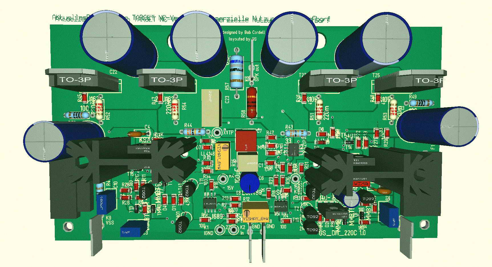

hi
this is my version of a DH-220C with 2SK1058 and 2SJ162 power stage. The power transistors will be mounted under the PCB and the PCB will be fixed on the heatsink
Bob Cordells design modified for my use.
BR
Günni

hello philnext,
if you want the schematics, i think that is no problem. The layout of the pcb is not made for replacement of the existing PC-6 (DH-200) or PC-19 DH-220 and DH-500) from Hafler.
It's a design with already integrated power transistor, which are not seperately mounted on the heatsink as in the DH-200. I also replaced the 2SK134 and the 2SJ49 (TO-3 cases) by the 2SK1058 and the 2SJ162, which have the TO-3P cases (totally different mechanics).
Best regards
Günni
