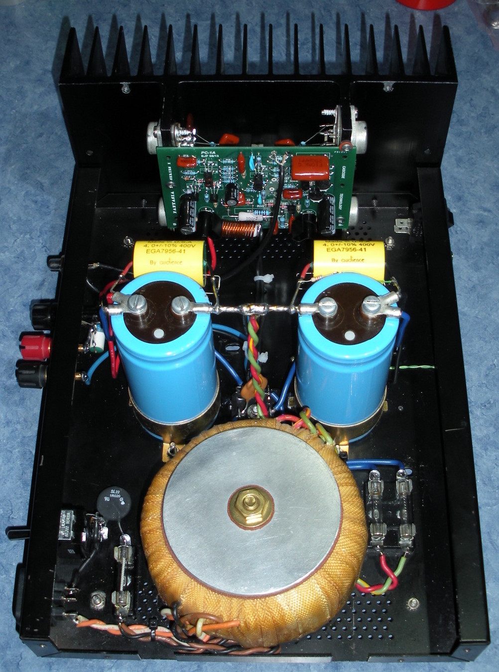

Take your time and follow the instructions and you should be fine.
His kits are pretty good, and contain everything you need including good solder.
Don't use any unknown,leftover or poor quality solder that might be kicking around, as that can cause you endless endless grief, especially if it turns out to be acid core 🙁
His instructions are good and I found him very open to answering questions I had.
Btw, here are pics of his DH200 boards in my mono amps.
I could have went with either model, but preferred to use up my DH200 heat sinks.
