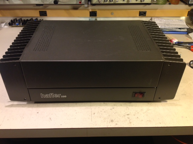

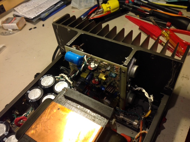

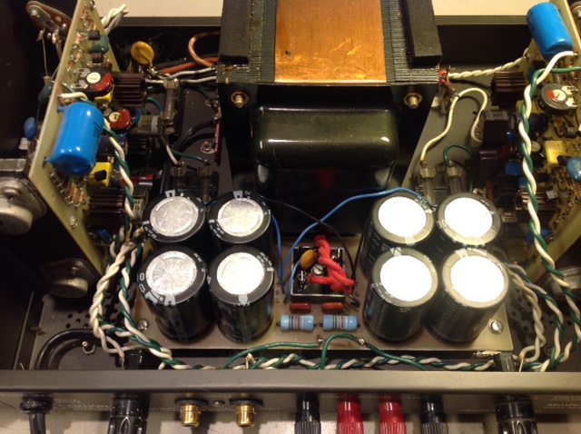

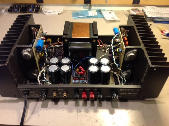

Hi. Who said that helping people doesn't give you anything 😉 I helped the father of one of my acquaintance a few months back, and look what does he gave me! Two Hafler amps in perfect working order, a DH-200 and a nice DH-220. The kit construction is very nice, the power transformer is huge and heavy. Bias is close to 0.3A (measured on each supply rails). Serious piece of a kit.
I'm an happy man 😀
I already put the DH-220 to service within a nice little sound system for my wife's office, rotel CD, NAD tuner, VSE SVP-2 tube preamp and the Hafler.
I'm an happy man 😀
Nice score Sylvain - looks like the one certainly had "some work done" to at least the power supply filter bank stage, and input jacks - so perhaps some of the numerous mods for these over the years as well .
Yup, one of DH's out of the park home-runs in terms of performance / value, and certainly spawned many an aftermarket upgrade / mod/ tweakers career.

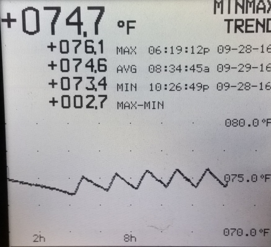

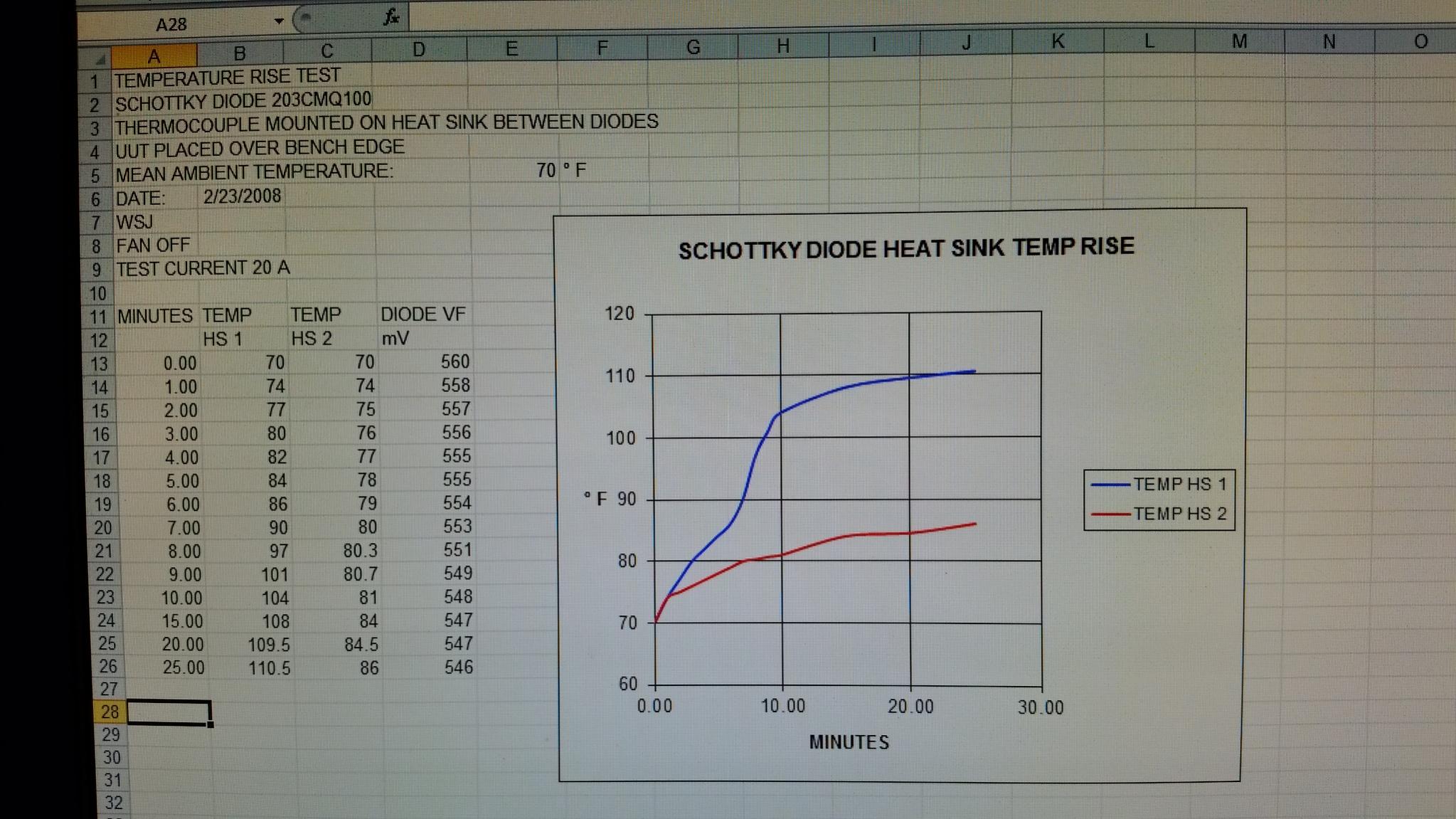

Does anyone know the heat sink ratings for the 220 ? I am interested in the actual thermal resistance.
That is easy to measure, just clamp a power resistor to the heat sink in the center inside opening and apply a fixed amount of power, then measure the heat sink temp rise. Done this many times, works great.
Heat sink temp rise test. Data recorded for use with Excel. Pic #2.
I'm using similar equipment to evaluate my Aquarium heater. Heat source, 200W, heat sink is the sides, top and bottom of the Aquarium. Pic #1
My Hafler Amp mods: http://public.fotki.com/WAYNEWANG/
Fluke 96 Scopemeter and Fluke 80TK Thermocouple Module

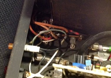

Do I need to replace power switch with lamp failure?
I believe the neon lamp inside the power switch on my DH-220 has given up the ghost. Background - I don't actually use the switch, the amp is plugged into the switched outlet on the DH-110. Symptoms:
While I'm looking at the schematic I have a second question (also probably a function my limited understanding). It seems to me that even with the amp switched off, there is a closed circuit through the transformer primary (albeit with high impedance??) via C407. Is there any purpose for this, or is C407 just acting as a snubbing circuit for any arc within the switch?
Thanks,
Alan
- normal operation on both channels
- several months of lamp operating when system was switched on for some hours, then intermittent, rapid, randomized flickering, then off
- finally a transition to never lighting at all
Thanks,
Alan

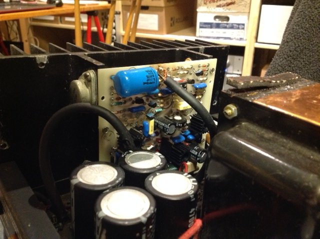

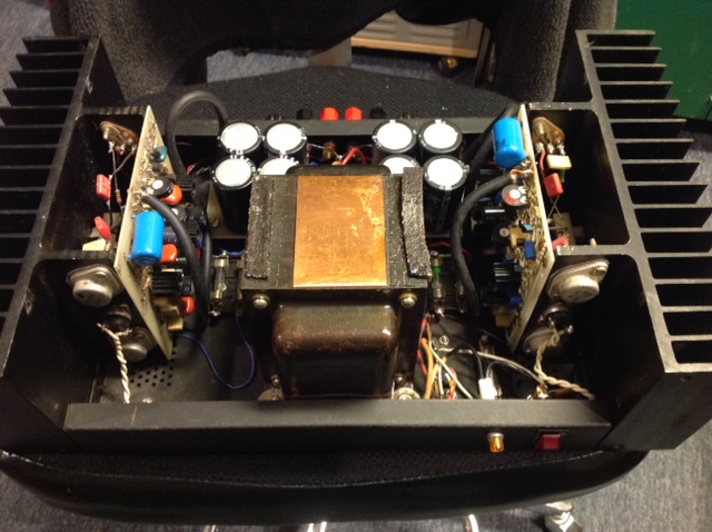

Images I posted were for the DH220 with the newest PC-19c PCB and indeed the RCA and speaker binding posts were upgraded. The Supply caps also with a neat pcb assy, with snubber and electrolytic film cap bypass.

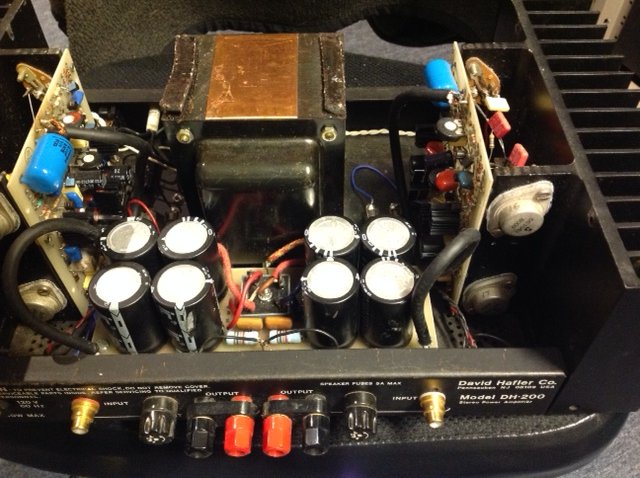

But what was my surprise when I opened the older DH200, it was upgraded too 😉 Check the pictures. Mods include RCA & bindings posts replaced with better quality, signal coax input cable between RCA and PCB, same multicaps power supply upgrade pcb, and the pcb seem to be the two sides PC-19 as well, with quality film caps, two pots adjustments (offset & bias), etc.
Also the gentleman that had these amps came from HK, and his amps have the optional multi-voltages primary version 😀
I'll just add a Surge Varistor at the transfo input to protect the power-on switch and no other upgrades will be necessary on these babies!
C407 is there to remove the 'Spark' sound when turning the amp off. It is installed on most power switches for this very purpose. On the DH-220 if one of the over-temp switched mounted on each each heatsink opens (over temp fault), the amp turn-off, and the lamp is off at the same time...
On the DH-200 there is a separate neon lamp on the left side of the power-on switch, normally it is off, in case of over-temp fault it turns on.

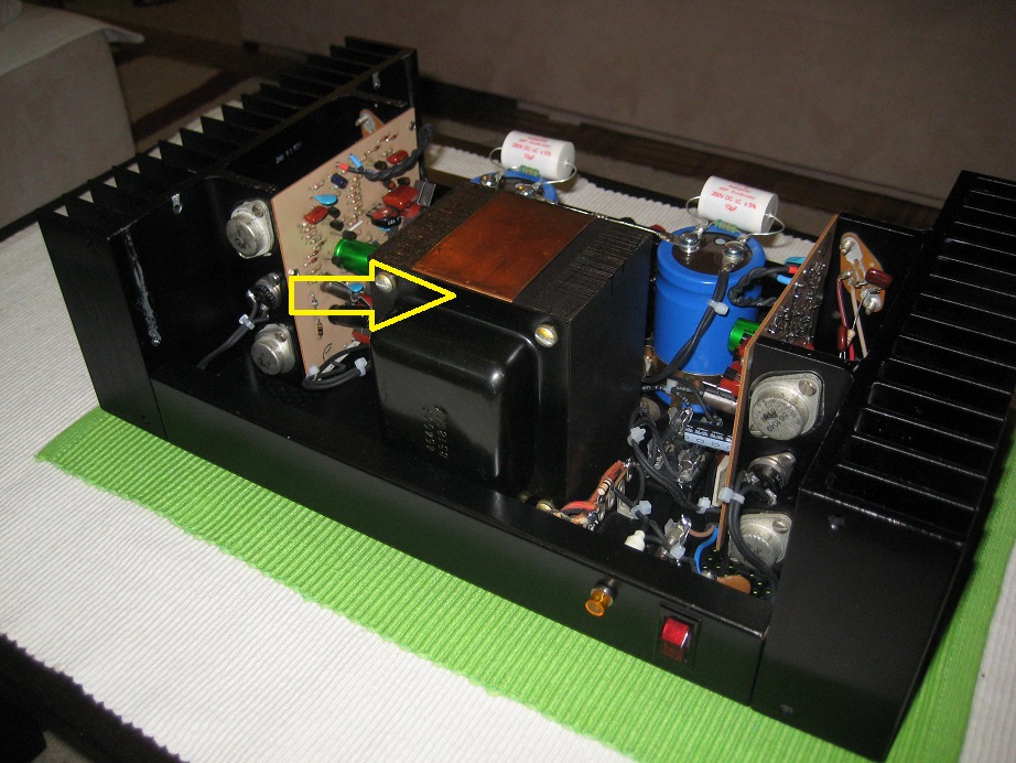

No, that is the way they came.Hi guys,
Can someone tell me what that copper shield is on the transformer ?
Is that a diy improvement ?
Sent from my SM-G930V using Tapatalk
A copper shield like that reduces some of the stray magnetic
fields from the transformer so you have less hum. The Audio
Amature talked about doing that in one of it's DH220 mod articles.
Is it possible to upgrade my amp with such a shield ?
