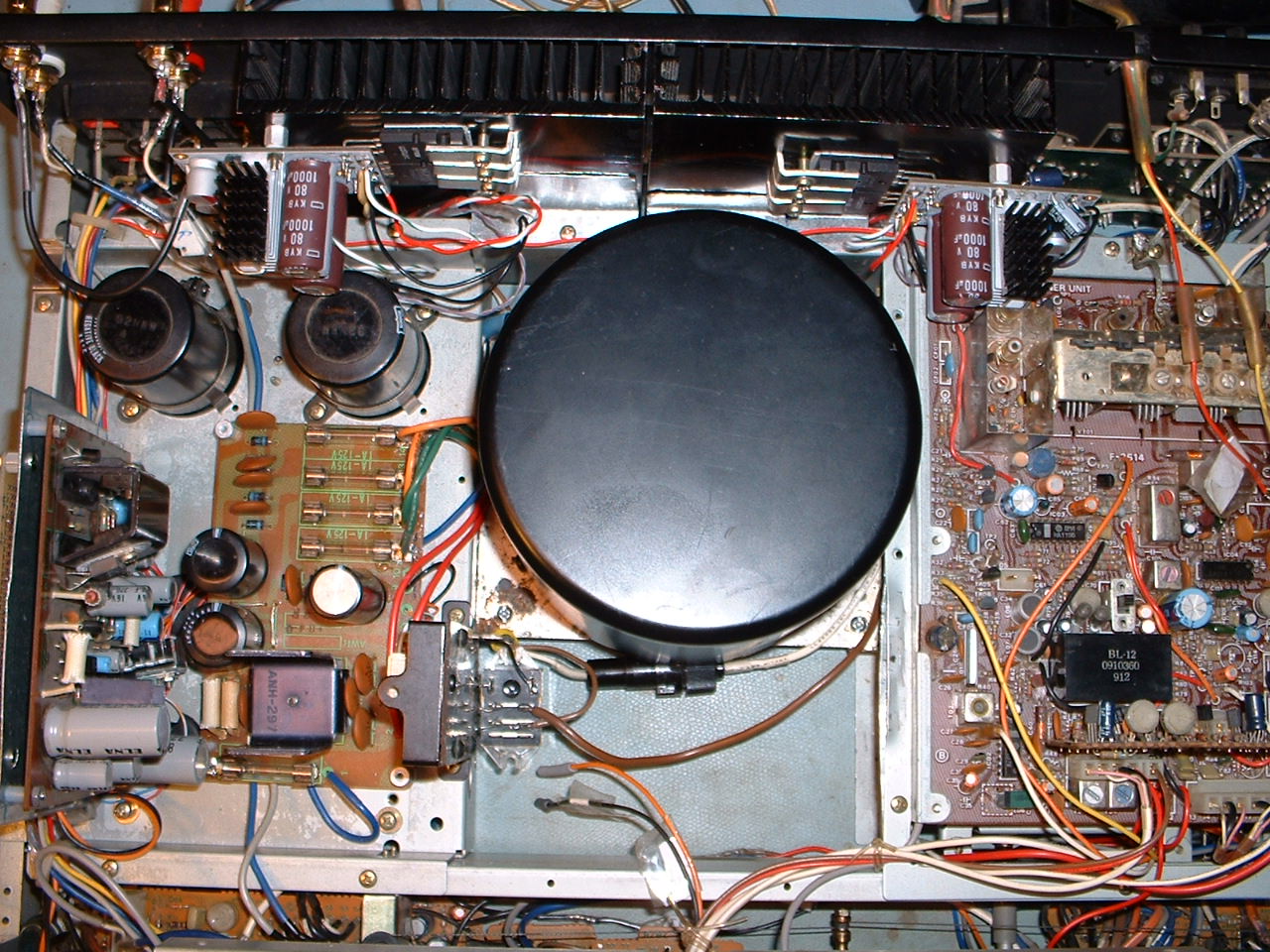

I am using the alf16n(p)16W in a old Sansui G-7500 that was upgraded with a pioneer sx-1050 p/s and opc lme49830 wire amp pcb. It sounds great, only blasted it once or twice. I measured its performance, got the 120W out of it, 620/650ns rise/fall time was impressive, not sure if any bjt's can go that fast.
agree I do not like the long leads to the mosfets, but I believe that Bob C. got it to work, I do not know the details of the construction.
yeah, certainly does not look like a hafler in any way and a bit of an off topic discussion.
I had to put in a different HS to make it work. I had a sx-1250 trans to try out, but that was not going to work because it was too big and I could not get enough HS in the chassis.
I guess you also noticed it is still running on the orig ecaps. I have a bit of faint hum, isolated to the pre-amp section. I put inpre-out/power-in jumpers on the back, so I can isolate the gain stages.
Hopefully in 2017 I can recap and eliminate the faint hum. Not sure if it was there to begin with, since the unit smoked its orig transf and main pcb.
