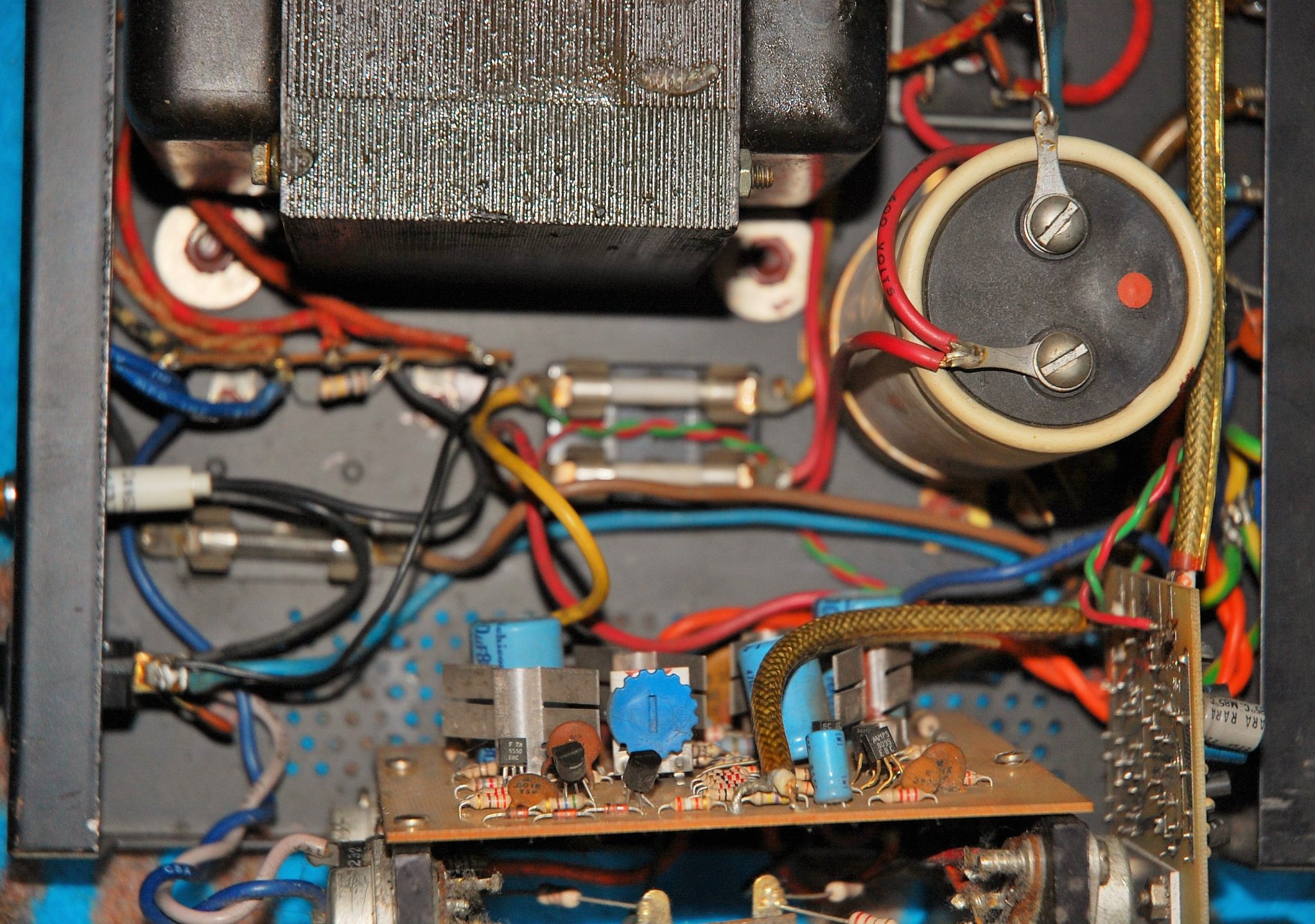

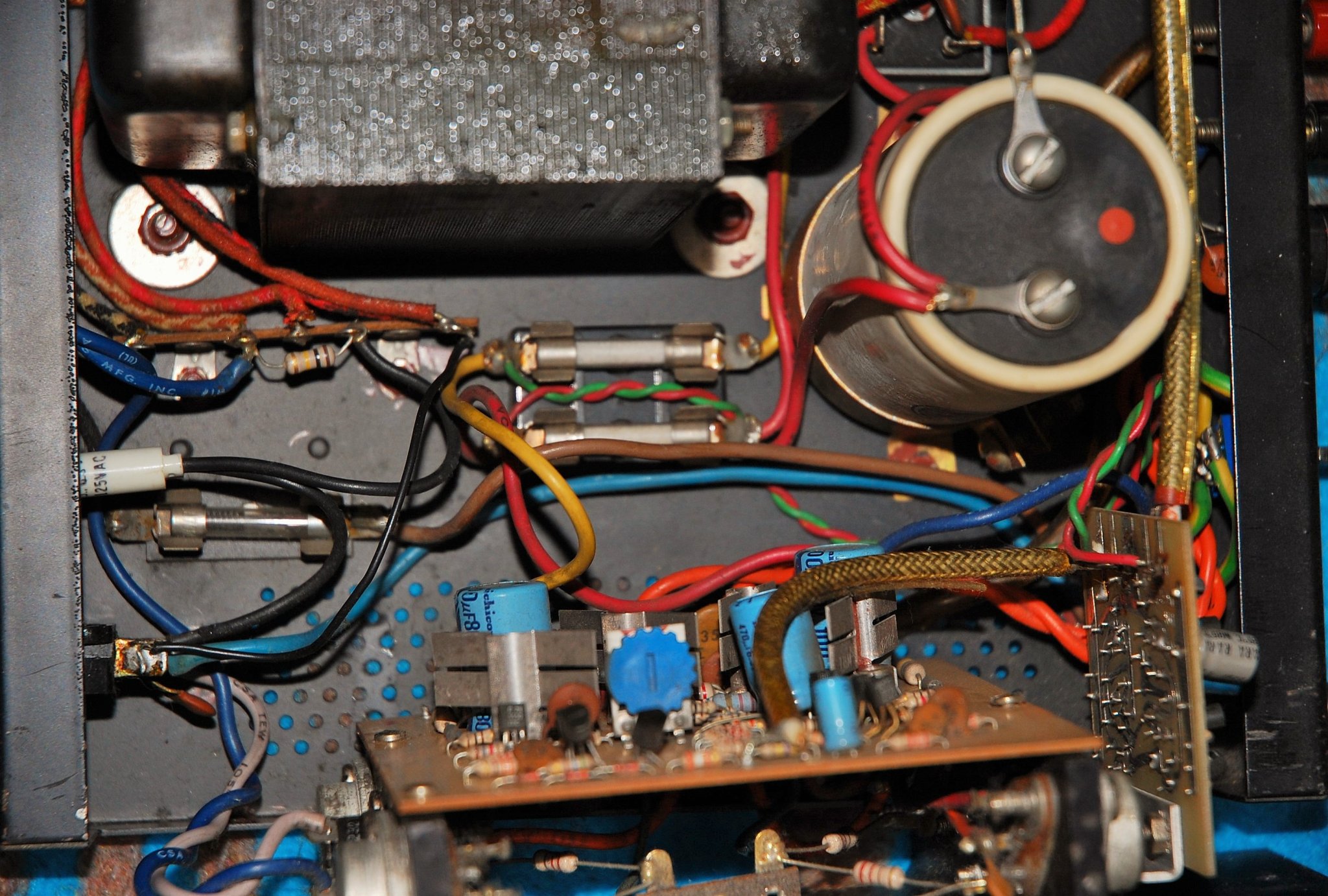

Hi everybody:

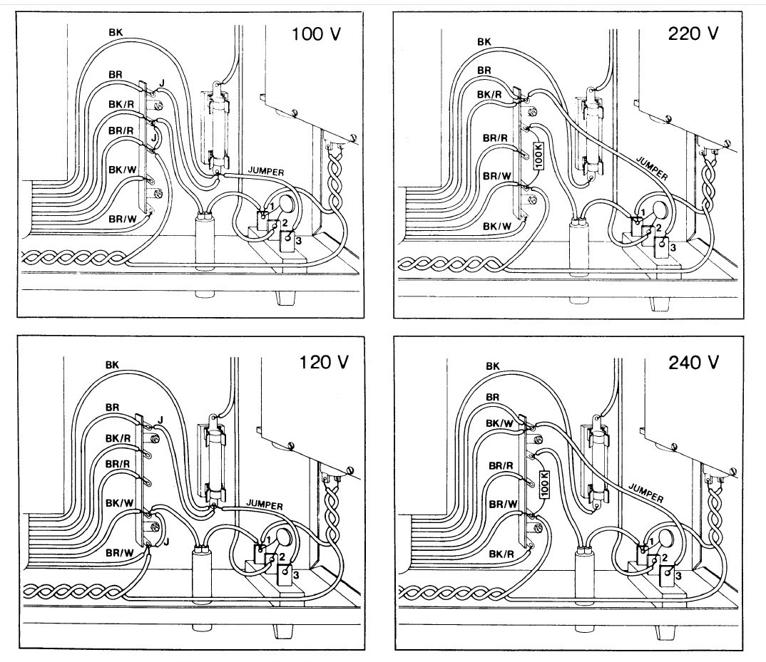

Anyone of you could let me know how to wire a Hafler DH-200 to run at 220 voltage?
I recently purchased a unit on eBay.de, it seems someone try to mod it, but, apparently, abandoned the job in the middle.
I'm afraid to power up this old beast and kill it.

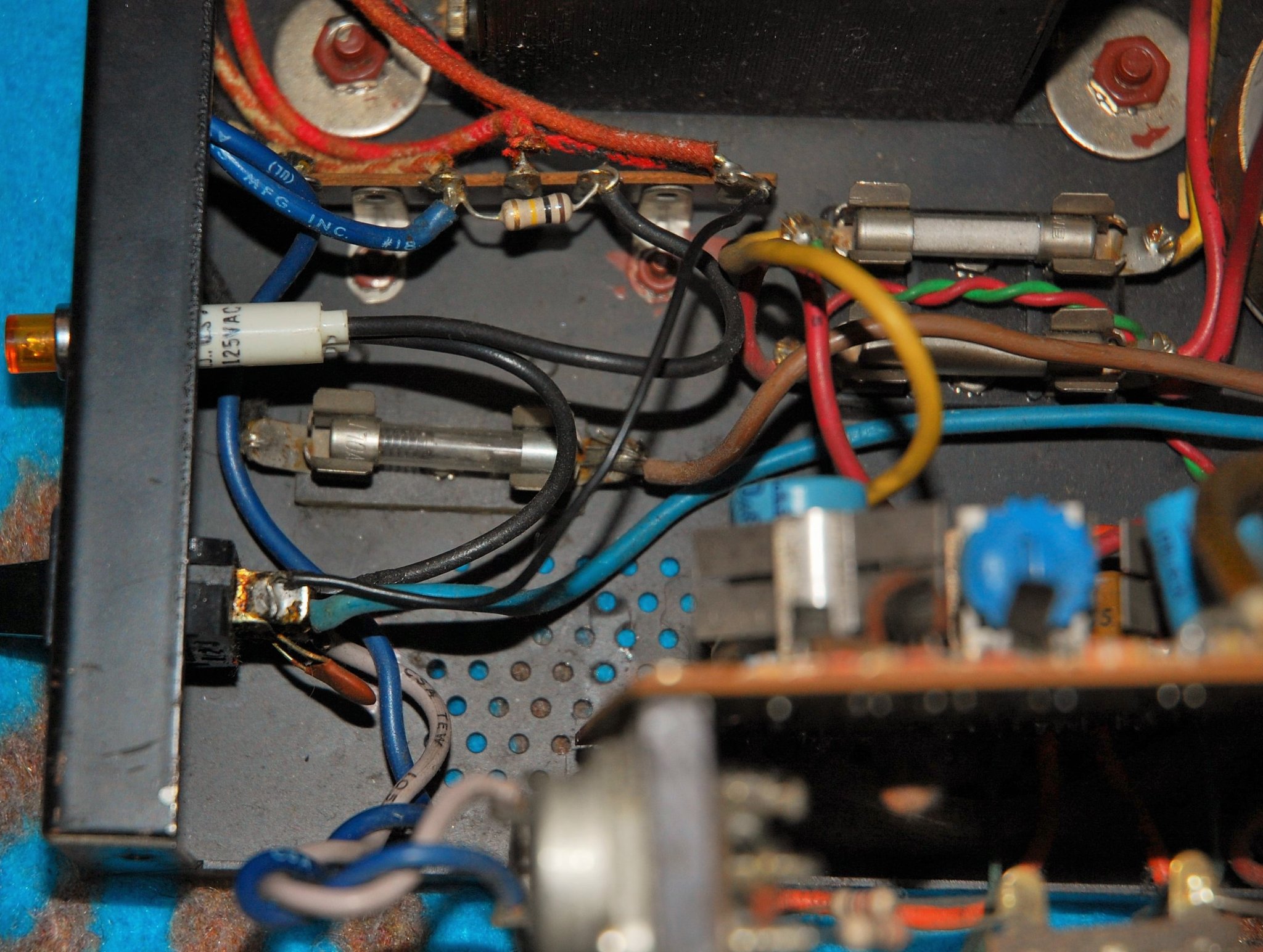

Hi: The pictures are taken by me from the amp I grabbed.
I saw the burned main fuse are rated 2,5A/125V!!!!
Maybe the person who tried to rewire it for EU voltages forgot to change the fuse accordingly...
2.5 A and 125 V calculate to a maximum power consuption of just 312.5 VA. The fuse appears to be not up to task, as I expect some higher power consumption, especially if the amp plays loud.
