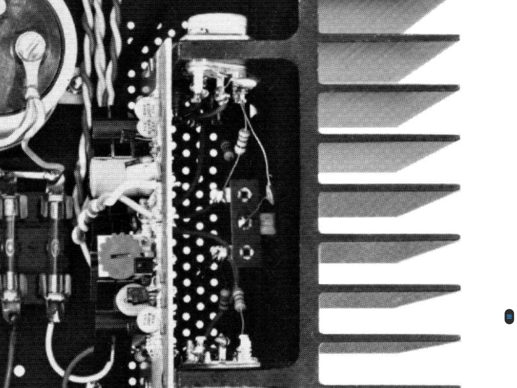

well, I thought what if there is leakage from the two on board caps to ground, I fitted panasonic 220uf 100v, and they are bypassed with vishay 0.01uf 100v 1837's. so I unsoldered one leg of the vishay, and now I'm seeing 7mv......
ffffffffffs.... maybe it wasn't me! I am surprised that one of these caps could be bad though...
short lived joy lol, there is still something else causing dc, all I did was straighten up the heatsink on Q8 and it jumped back to 220mv. I have already removed Q8 and measured it with ok results.
Mechanical failure on PCB? Check PCB for hairline cracks in the copper traces. Any aeras where copper traces has lifted from the PCB?
Pay particular attention to aera around Q8 and a any thru-hole/via points on the PCB.
Any aera that has seen excessive heat or has been soldered multiple times? If you find a weak spot, check same aera on opposite channel.

A couple more things to check. Look for a good ground between the heat sink/circuit board assemblies and the main chassis. It relies solely on the contact between them. I removed some of the black oxidation finish and snugged up my mounting screws but others have suggested a good ground jumper wire between the assemblies and the main chassis.
Likewise, the terminal strips that C18 and R40 connect to are grounded just by the contact afforded by the mounting screw. The black finish on the chassis and heat sinks acts as an insulator. Bare shiny metal between them and under the terminal block mounting screw helps.
And there shoukd be tiny insulator orings between the PCBs and the heat sink, under the three PCB mounting screws.

plastic washers check, ground check, tags are bolted on and checked for good connection. I thought about mounting them on nylon bolts and running ground wire back to my new central ground I fitted for the inputs.
sink to chassis good.

Today I received a transistor order, some 2N2222's, some 2N5415s (ST Taiwan) and some NOS 2N3440 motorola (this is what the supplier sent me, interesting the motorola measure all over the place, all 4 are quite different from each other).
So following on with my gut feeling from the weekend, I removed the 5415 I was feeling iffy about, and replaced it, DC went from 220mv to 20mv.
Now interestingly the bias went up to 500ma with the new transistor in, I had set it at 290ma while the old 5415 was still in there.
Maybe I disturbed the original transistor and it may have been starting to degrade or had a fault, leaking dc? I dunno, what do the experts think?

So I want to find another 10mv at least, could be the matched pairs are not as close as they could be, I guess I should pull the 470uf cap again to check the pairs balance?
Have resoldered every joint on this board, checked everything, checked continuity across pins to check for track cracks, nothing else appears to be an issue.
One thing I did notice, with a new multimeter (picked up a pair of Micron on special so I had a matched pair for doing bias, dc etc) some of my matched 2.2K and 100ohm resistors are measuring further out compared to my old meter, how much do these resistors affect the balance of the differential pairs and hence dc offset?
