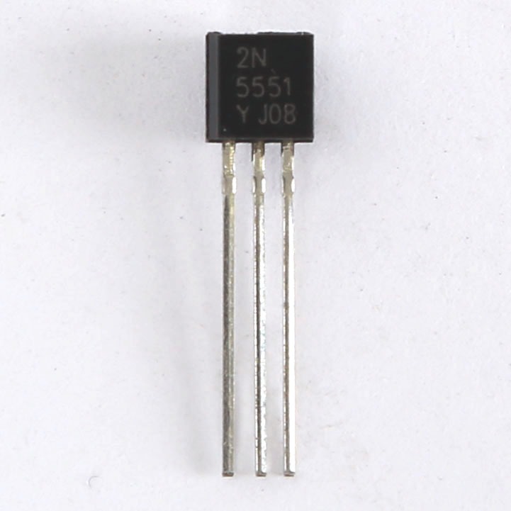

Here is a pic sent to me by a local supplier, didnt realise they stocked these semis, they say they dont know the brand but their stock comes from a large German distributor. Looks similar to what I bought.

Hi Sonic Art,
All I am going to say is that I refuse to take chances with parts. It simply doesn't pay in the long run. You may get lucky - and that's great.
Top notch parts will be less noisy, and last longer compared to knock-offs, remarks and total fakes. As far as noise is concerned, you often won't notice it, but you can sure measure it sometimes in a complete circuit. We can measure noise of individual parts, but that test is a pain to set up and characterize. Of course the big concern is device failure.
Often an under-rated part can survive for a while, maybe even years. However when it does fail, it can take out a lot of far more expensive things (including speakers in your case). So given the cost differential, it simply makes zero sense to even touch a part you have any doubts or concerns over.
When I was young, I couldn't afford anything. I got all my parts from old Television sets and radios. I measured them to make sure they were good, but at least the things were real. We didn't have any problems with fakes, pulls or remarks, that probably started in the late 1970's with TV parts. I know the Sony SG-613 was the one part I heard of that had a real problem with fakes and remarks. That and TV horizontal output transistors. Later we saw remarked audio outputs, then drivers and on to signal transistors. Even IC circuits!
Today I do not trust anything that doesn't come from an authorized distributor. Earlier remarks and fakes were obvious, today this isn't so. The markings are very good these days. The only eal defense is to buy from verified supply chains, and this is a lot less expensive than risking a fake.

100% I get it, I have searched for original devices high and low, even Mouser shows various brands, but no photos for comparison. I will get more and swap those 6 out just to be safe. Am going to measure the old ones today just to compare.
So what does everyone think about the second pic I posted of the single 2N5551? That comes from one of the biggest suppliers here in OZ, and they took the actual photo and emailed it to me when I asked yesterday, pretty decent service. They say all their stock comes from a German distributor, so do I trust these chips? they are not expensive, 30c USD or so each.
Hi Sonic Art,
I don't know them, so I can't comment. I would be measuring beta, interelectrode capacitances and breakdown voltage at the minimum. I use an HP 6186C current source for that, 300 VDC compliance voltage (rated). it goes a little higher, and I have very high voltage supplies if I need. Most people can't do that, so it's easier to buy the real thing or a current replacement type number.
For me, even though I can do some basic tests - it simply is not worthwhile. Luckily I did buy enough stock when they were current to be able to avoid some of this. But even then, I'll simply select a current device that will work as well or better.

I have to order parts today for another job so will get 10pr from the local supplier, check them out and if they measure as good as the "other ones" I will swap the 6 out.
I measured the old devices, the 5550 all measured the same, the 5401 measured a little different, two were close, one was a bit out, maybe 10%. I guess I could pair up the two close ones and likely get the DC under 10mv like that!

Hi Sonic Art,
I don't know what to tell you. I don't want you to waste money, and I do not know the companies you are dealing with. They may be perfectly fine.
It really comes down to knowing who you are dealing with with certainty. I have many decades worth of experience with components and fakes - remarks. Many of us do and that gives us an advantage. When you're starting out, it is simply very hard. THese pages are perhaps the best source of information you have. They sure don't teach this is any school!
Without having the part in hand, no one can tell you with certainty unless they have had the same part exactly in their hand, preferably from the same vendor.

I get you, been in audio commercially for a long time but haven't had to deal with old stock ic's much in the post
past.
the supplier here is about the largest local one, they deal with a lot of stuff that has to be complied for Aus use, I trust what they tell me but cannot vouch for their suppliers of course! one would hope that the German distributor is selling them quality parts.
