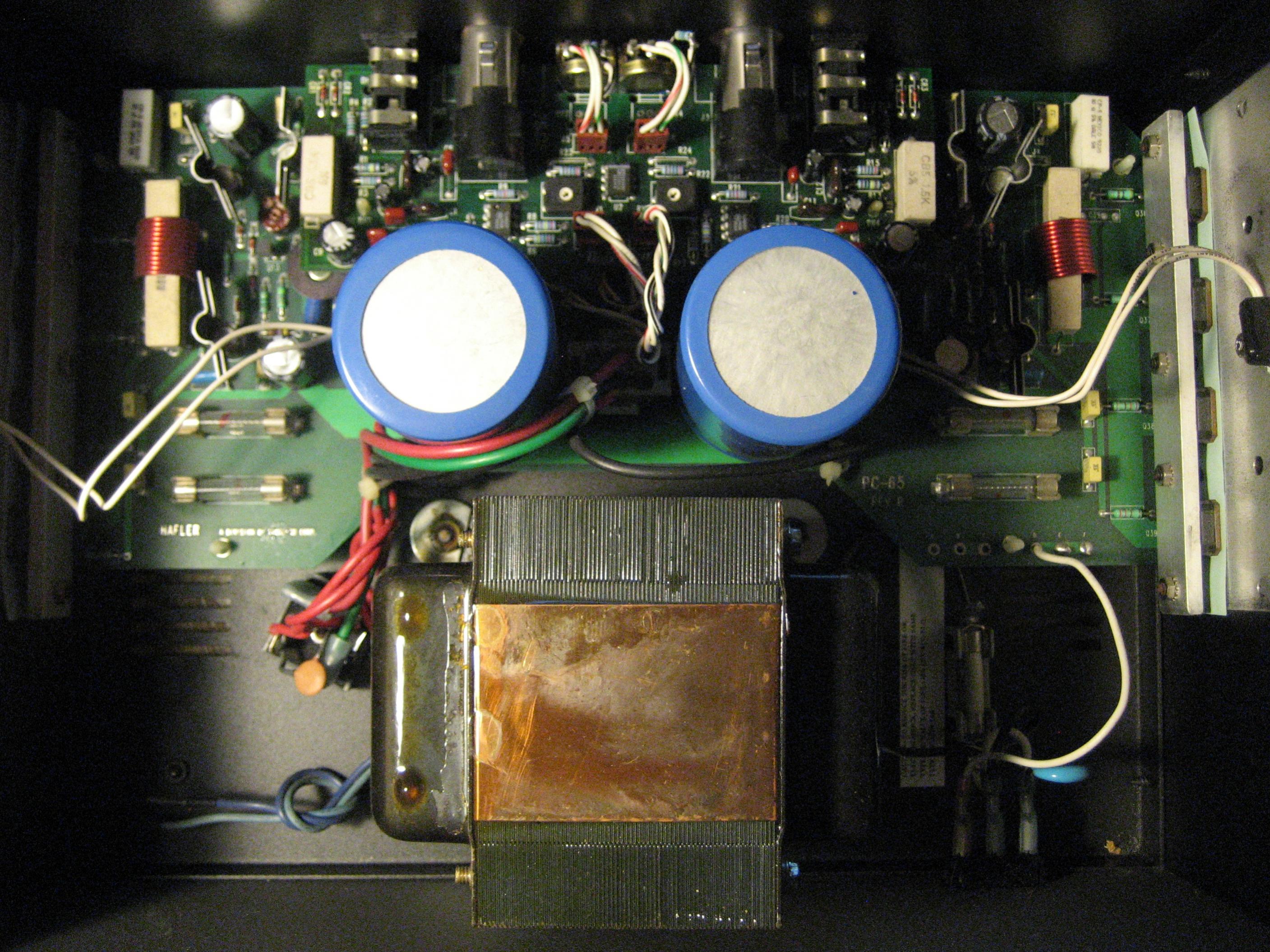

Sorry for the late update. Work completely consuming me for a while. Still trying to solve the right channel sawtooth distortion and motorboating. All component changes suggested earlier have been done to no avail. Though they are new I am going to replace Q1 and 2. The sawtooth distortion is evident there, though I don know if that is conclusive since the feedback circuit could be to blame as well. Don’t have enough circuit theory knowledge to be sure. I will report back when I get the chance. Thanks for the advice.
well the DH200 is back together, I ended up replacing all the resistors that were listed in various posts in this thread, the ones around the transistors.
I think I might have some trannies that are slightly off, left channel 44mv, right channel 8mv.
have set the bias at 290-300ma. it's only on the bench right now with some ceiling speakers to check it with, I have 2 meters on the outputs looking at the offset, and one on a channel watching bias.
it's very quiet through the speakers, have to stick you ear against one to hear anything, so that makes me happy, just the offset on left channel to get lower now.
update, was getting some crackling through the left side when moving the new shielded input cable around, moving the edge of the board side to side slightly had the dc moving up and down, went down to 25mv, then right down then up, seems something not quite right. unscrewed the sink and board and looked it over again, went over solder joins that looked like I hadn't touched them, cleaned it and put back together, now I have 50mv!
any suggestions as to what I have missed? right channel still at 7mv +/-.

I restored the fuse network back to stock some time ago and all fuses are intact. The sound improved, but only marginally and the sawtooth wave on the positive side of the RH channel output remains at frequencies above about 2.5khz, and power above about .05 watts. It is everywhere in the positive circuit after Q1 and Q2. They are new as are nearly everything else on the board. My rookie mind says replace Q1 and 2 again, but thought I’d wait until more experienced minds chimed in.
I also replaced the caps on the mosfets with the appropriate types as suggested, as well as reducing C1 to 390uf. No change resulted.
Hi Sonic Art,
Match the complementary differential pair!
yes that was next on my list 🙂
prefect timing my 30 "fairchild" 5401/5551 pairs arrived yesterday, last night I measured them all with my trannie tester, I did 4 test runs on each device to keep the tester active and settled, matched the hFe and Vf and ended up with 2 groups for the 5551, and 5 groups for the 5401.
I have posted a pic of the ic's in case anyone recognises them as Fairchild? supposed to be genuine old stock? or are they still making them?
just now I finished replacing Q1-6 with my matched parts, and am now looking at -4-5mv on the left channel, +6-7mv on right. that sound ok?
