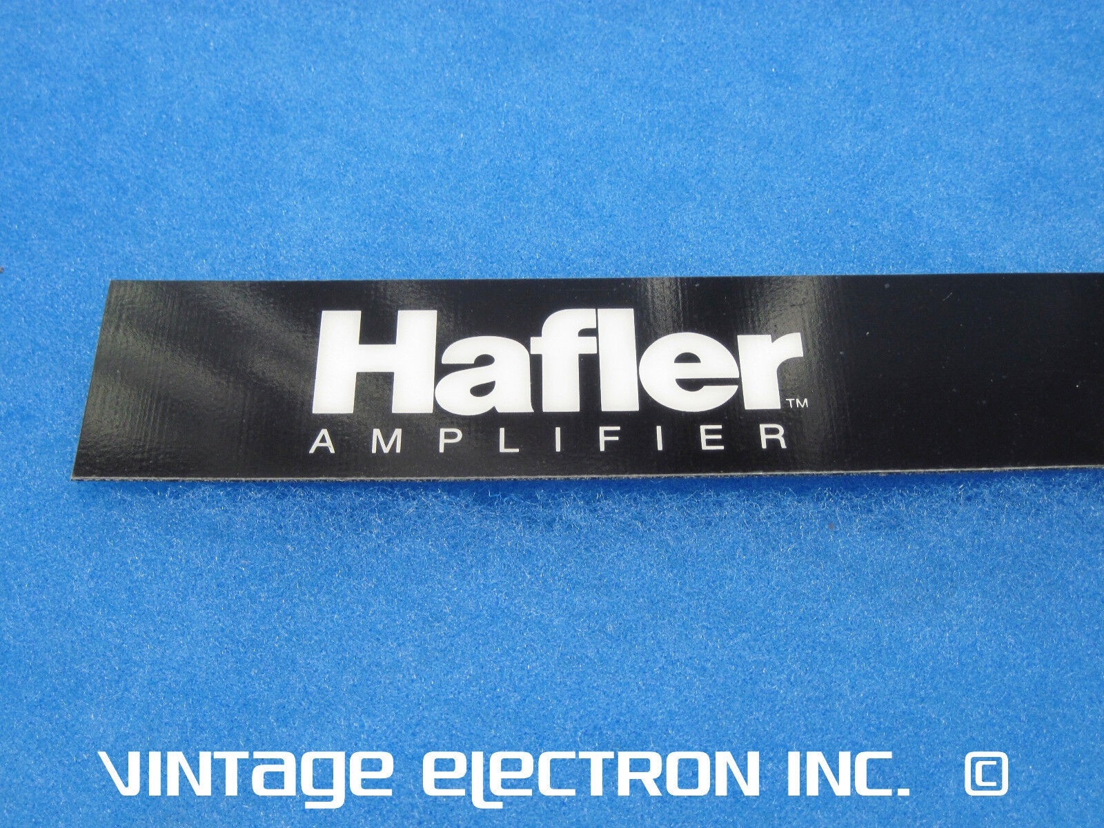

Too bad that machine will not work...
On reflection, I remembered this logo :
and it is still available
https://www.ebay.com/itm/3726329126...QNeQkEW5Pn2A3N+KID63H3q/sC|tkp:Bk9SR8jwzbf0Yg
HTH,
David
NOS HAFLER "Hafler Amplifier" Front Panel Self-Adhesive Logo Strip: ($13.95/ea)
HTH,
David

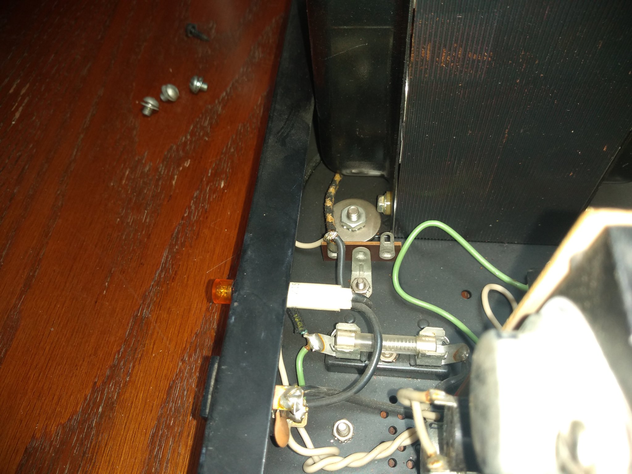

Hello all. Brand new here. I haven't messed around with component level electronics repair in a loooooong time. Reading through these pages is a serious refresher course. I'm amazed at how much I remember but even more amazed at what I have forgotten. Sad.
I got ahold of a working DH-200 35 yrs ago and stashed it away until last week. No output. Went through some checks, cleaned things up, reseated/greased the mosfets and it's working now.......yay! Checked the OPS bias (235 ma/270ma) and DC offset (15mv/23mv).
I do plan on upgrading but for now have a problem with the 10000 uf PS filter cans? It sometimes sounds like it putting a half second of 120 hz on the outputs on cold power up. It plays ok after that. I can't find a source for the original cans. I had Electronics training in the military 42 yrs ago but haven't used that training since then. I simply don't know what uf to get. Dont want to over current the bridge or burn up an already marginal designed archy-sparky power switch. Anyone know of where to find suitable replacements? Maybe send me a link?

Seems more like a bad solder joint than the supply capacitors, or else a loose screw terminal, or input cables.
Yes, the 1/2 second humming/buzzing on power up is on both outputs. Sounds like 120 hz from my days of running live sound for bands.
I've checked the PS connections, everything is tight and shiny solder. Touched up the P-6 wiring input and output connections as well as others that were questionable. Really though, it was soldered by someone who knew what they were doing. I don't think anything that I did was an improvement.
There IS a missing component however, the .005 uf C14 cap for the neon over temp circuit. Appears to me C14 is to bypass the neon light during normal operation then if one of the temp switches opens the power is sent through the over temp neon light. There is a resistor shown for neon light on the schematic however it has no nomenclature nor shown on the parts list. I have to assume the neon resistor is part of the neon light assembly?
Anyway, the way it's wired, without the C14 bypass cap, I would assume the neon light would have been lit continuously, and burned out long ago. I don't feel the C14 cap has anything to do with the buzzing noise on power up BUT like I said, it's been many years since I've performed any component level trouble shooting.
Will old dry filter caps buzz on power up until they charge up? Will they get better or worse over continued use?
Sorry about the dumb questions fellas, I know this isn't a trouble shooting thread. I just want to get a good kit before starting mods.
Lonnie

Then if the screws on the capacitors are tight, there is some other problem to track down.
But clearly it is in the power supply area. I suppose the two main capacitors should be checked,
if not by measurement, then by substitution.
Or you could burn it in for a few hours, and then see if the problem has changed.
Although I've built a few of these, I never had a problem. Wouldn't worry about the lamp and small cap though.
Thanks, rayma.
The 1/2 second buzzing issue on power up has disappeared. Not exactly sure what fixed it. Recap is next.

Update, figured out what was causing the buzz on power up, the Monster Power "Green" surge protector. Apparently the inrush current from both the Onkyo 818 and Haffler DH-200 freaked out the active components in that surge protector. Not a peep during power up since I moved the Hafler to the wall socket.
