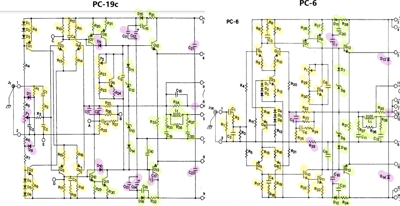

FYI. See attached schematics of PC-19c vs PC-6 where components and/or junctions are denoted as follows: a) yellow = common function; b) purple = new and/or different component/topology junction; c) unshaded = tbd. Note: differences in OEM component values are not noted/identified (i.e., only presence, lack of, different topology junction are noted/identified).yup got you! 🙂

Looking for input to arrive at a concise/accurate listing/sketch of what's required to mod a DH-200 with the DH-220's offset adjust circuit.

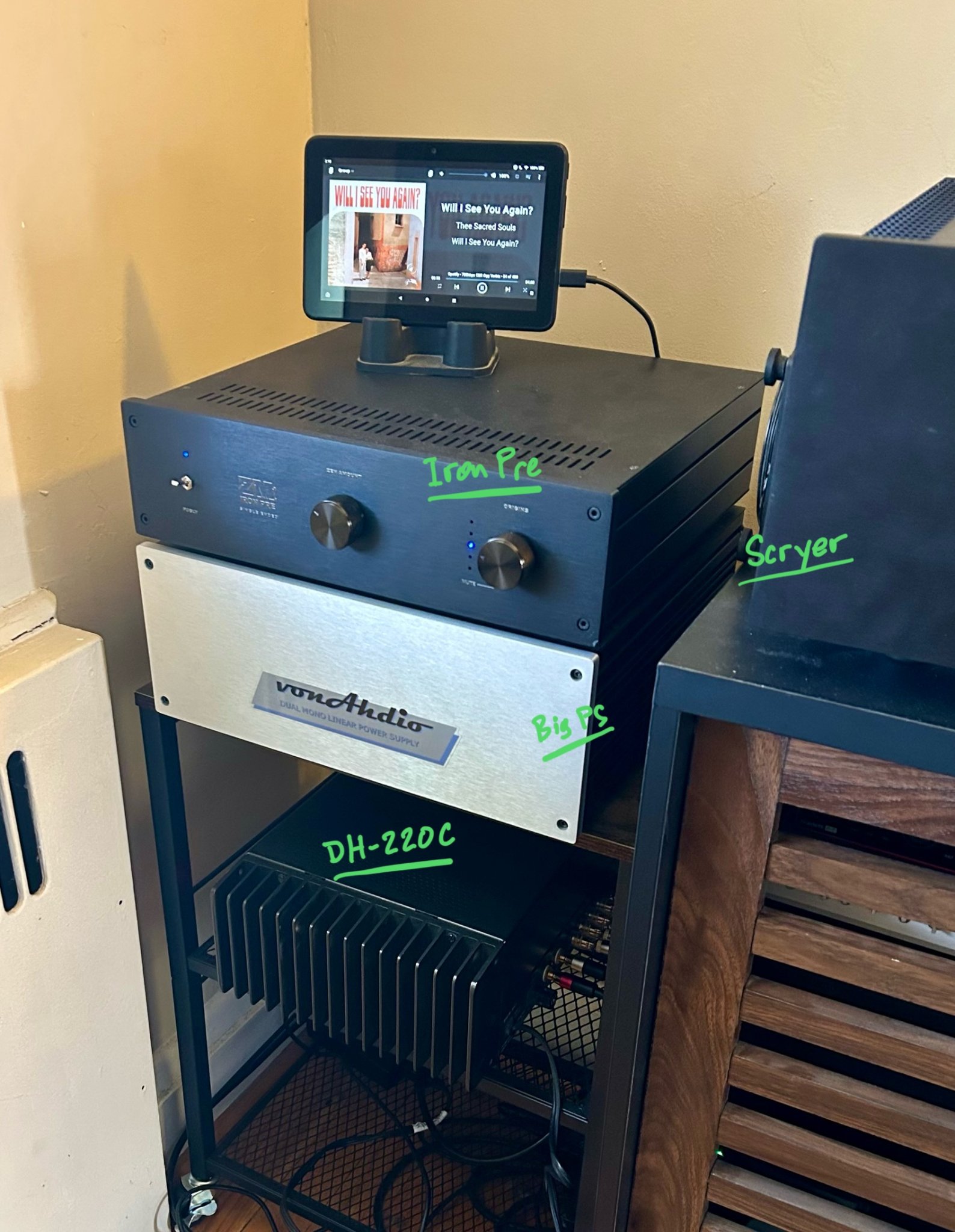

Starting my DH-220C journey and am impressed with the amount of supporting information that is included with the PCB's. I find chassis preparation and BOM building to be the most time consuming aspects of DIY projects. Having the BOM's already completed is a huge time saver! Well done Rick, thanks. 😉
@von Ah, your amplifier was part of my inspiration! 🙂
Scratch build with Bob and Rick's pcbs. Still undecided what chassis in my stash to use, but needs to fit a dual mono power supply.
Nice von Ah!
I'm going to assume your running the original spec'ed bias current, What temperature do the heatsinks settle in at? Thanks.
Yes, I set bias per the build guide. Heatsinks settle at about 50C. Toasty but not really hot.
My SMPS measured +/- 67VDC unloaded, so my implementation may be a smidge more voltage than the original power supply, but all is well. I have faint hum at the speaker, but undetectable by ear more than a foot away.
