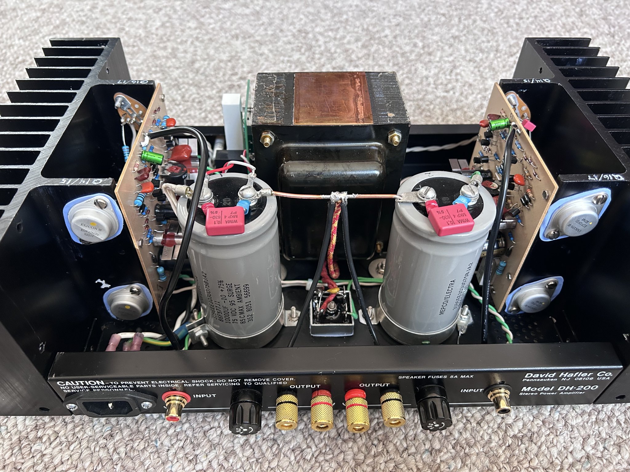

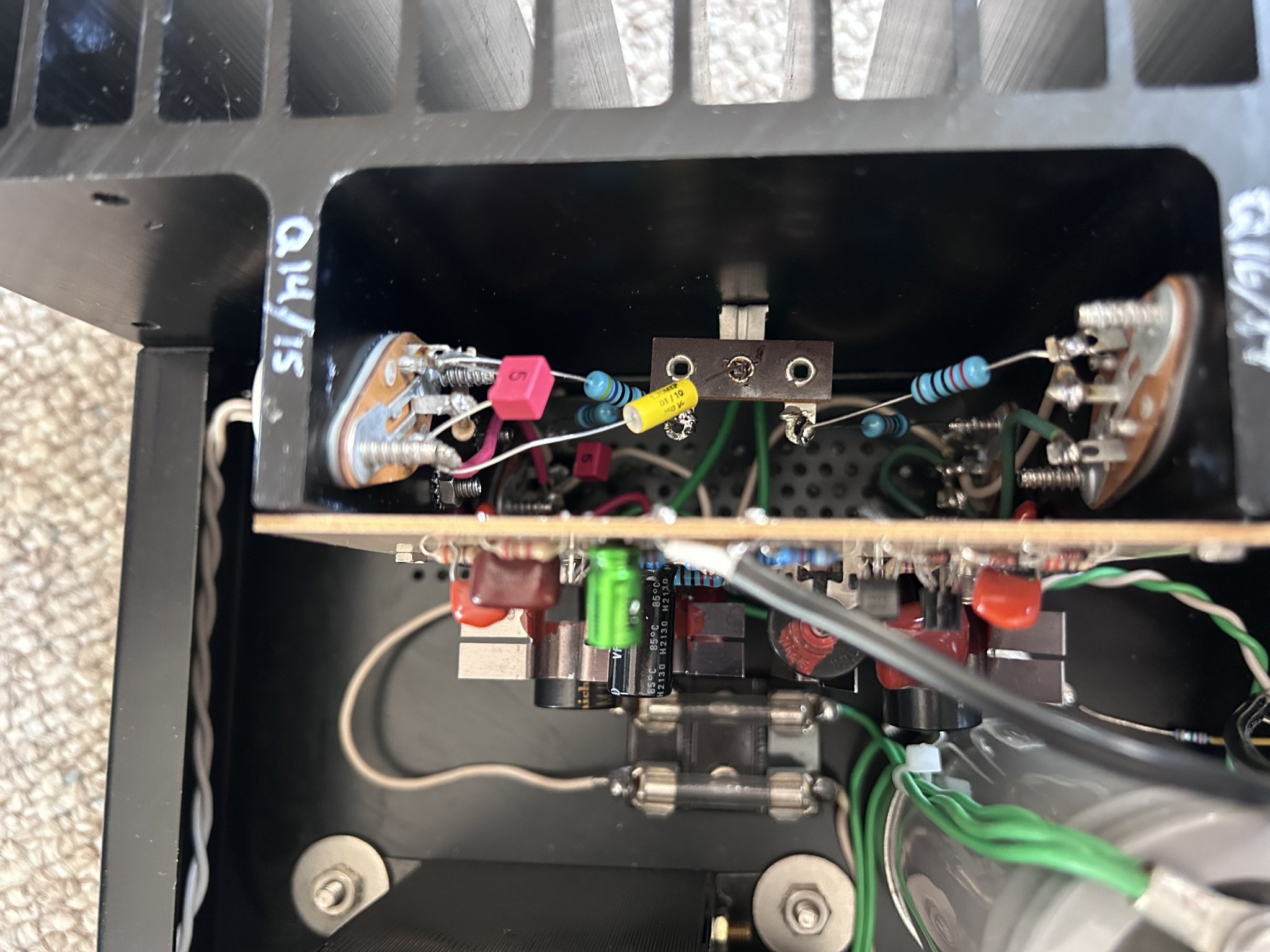

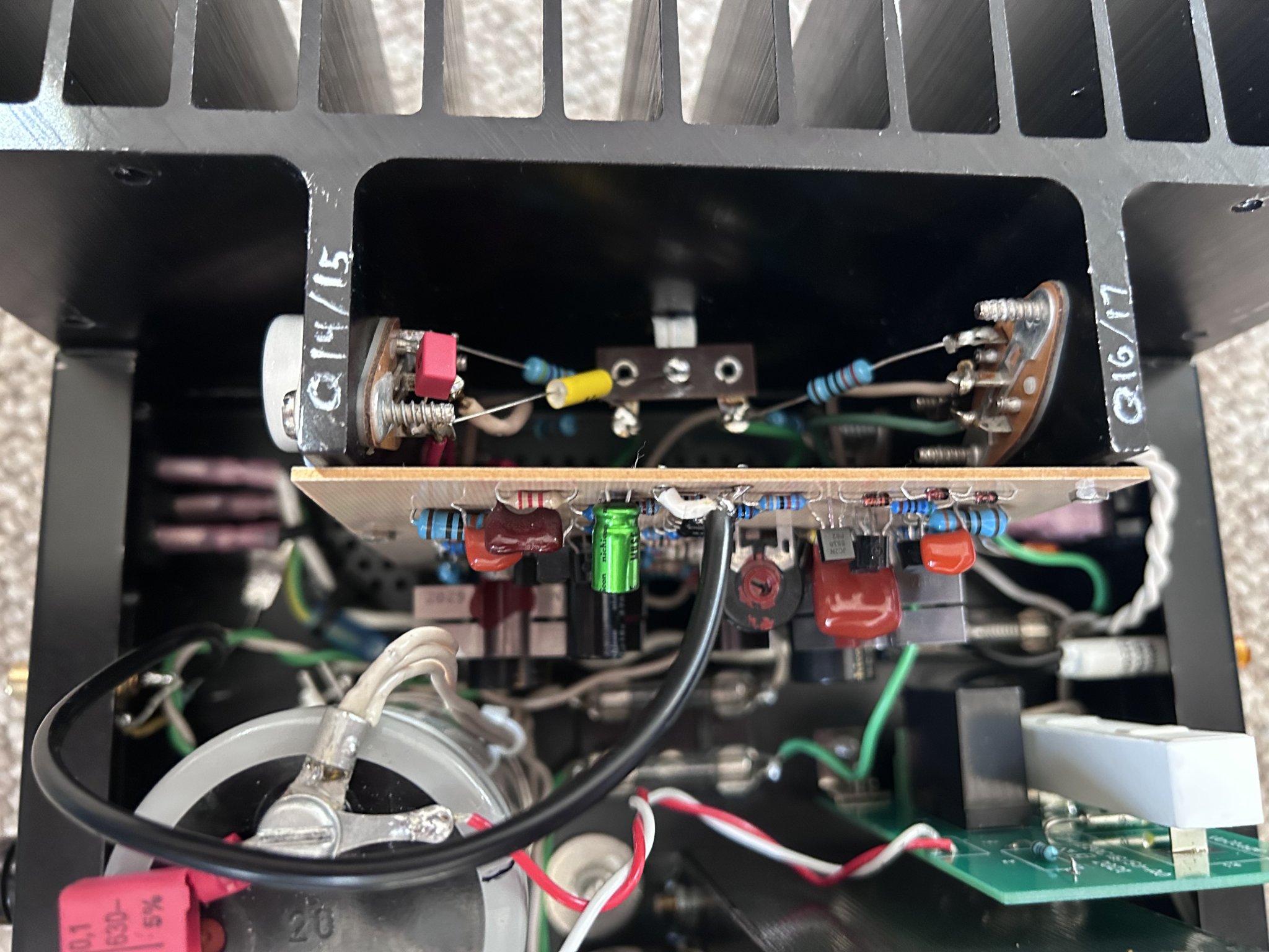

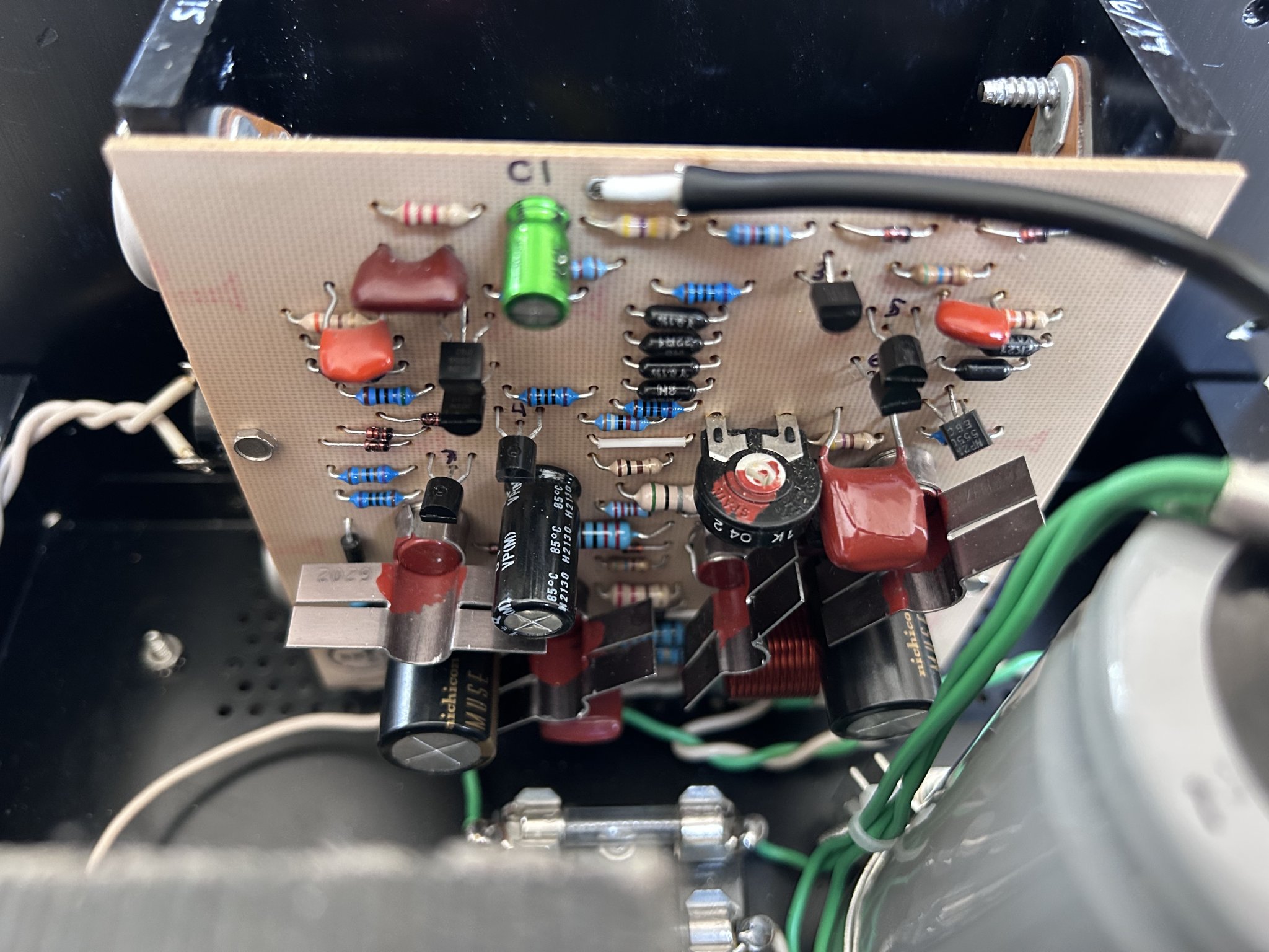

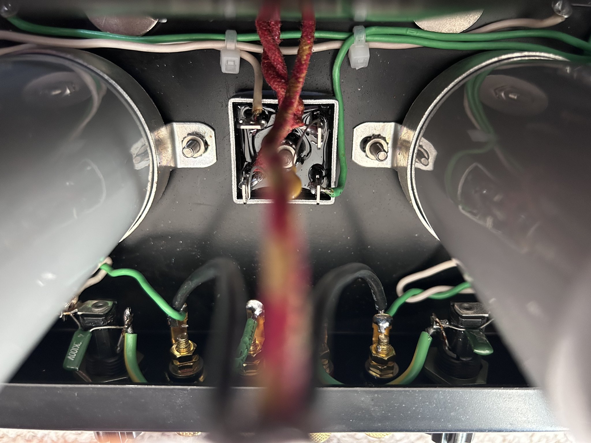

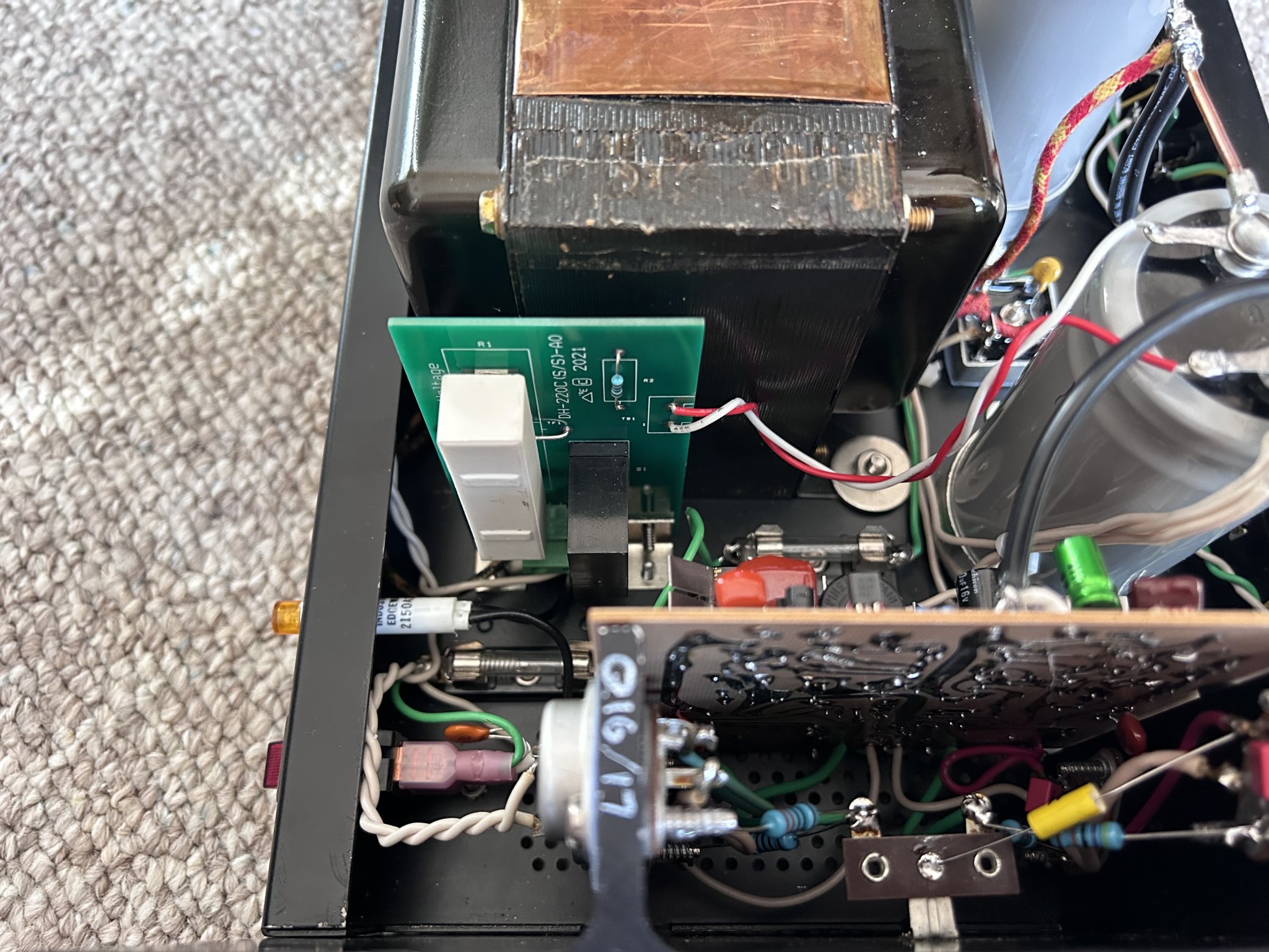

Finished refurbing my DH200. Initially it lacked bass but the rest of the spectrum was very satisfying. DC offset was -17mv and +34mv and bias was settable but unstable.
Replaced virtually all components on both original PC-6 boards, with minor mods; 33pf cap across the Q15 and 16 gates and drains, shielded cable from floated inputs to boards, small bypass caps on the original filter caps (the filter caps tested very well on capacitance and very low ESR), thermal pads instead of paste on ORIGINAL mosfets and thermal switches, 2.2 ohm resistors on both outputs returns to ground, gold plated input and output jacks, IEC mains with ground to chassis, new power switch and finally Rick’s superb soft start circuit. I painstakingly matched all pairs of components and 5550 and 5401 transistors. The only components I did NOT change are Q8,9,11,12 and 13. I ordered a set of Exicon matched (S type) mosfets but haven tried yet since, except for the lacking bass, the amp sounded good. Before listening I scoped both channels just with 1khz sine as a quick function test and found output flat and roughly expected gain from 10hz to 25khz.
DC offset is now 6mv and 11mv, bias is very steady starting at 275ma decreasing to about 265 after an hour of warmup, and no hum.
The listening results however, are disappointing. There is still a distinct lack of bass, mids are clean but the highs are now crystalline sharp and fatiguing. I’m driving highly efficient VOTT A5X speakers, nominally 12 ohm impedance. Volume is not an issue. Borrowing a friend’s McIntosh 75wpc amp for an AB comparison, sounds great.
Before I plug in the new mosfets, I was hoping someone could comment on what else should be looked at first. I know larger filter caps may improve bass, but there is no way the original bass would have been this weak. Could the Qs I did not replace have this kind of effect? I was under the impression they were more associated with bias and power supply than signal.
Thanks in advance for any and all suggestions.
Jeff
Edit: I forgot one other mod. Per one of the mods suggested here, I jumpered pins 8 and 11 and fed output pin 12 through the speaker fuse directly.

Can you show a picture of your boards and also whole amp to see if there is nothing obvious.

Thanks Fab. I don’t have any unrealistic expectations for the Hafler versus the McIntosh. It was the only known good amp available for an AB comparison. The sibilance was noticeable before the restoration. It got worse after restoration, and now even worse with the Exicon mosfets, though the midrange improved. But still extremely weak bass. I even tried parallel 4700uf caps on the filter caps with no noticeable change. The original caps test at 9900uf and .1 to .2 ohms ESR so I haven’t bothered yet to upgrade them. Supply of decent 20000 or so caps is thin at the moment anyway.
Pics attached, thanks for your response.

Hi Jeff
I do not see anything obvious from tne picture.
you seem to have a scope and a frequency generator from your previous post. Can you verify the low cutoff frequency at -3dB of the amp Since it should be around 1 Hz. Input cap is supposed to be 10uf according to BOM. Also feedback cap C5 should be 470uf.
EsR of 0.1 to 0.2 ohms is quite high value. It should be about 10 times lower for good big PSU caps.
you may also have very high frequency small oscillation that could cause tonal balance issue…
is it a soft start circuit that you have added to the amp?

Some corrections and a smoking gun.
The ESR on the PSU caps was when I first got the amp. I reconditioned the caps by charging to 70v for an hour or so and slowly discharging, several times. Testing today on my DE-5000 shows 9400uf and 0.0 ESR at 100hz.
C1 is 10uf non polarized electrolytic though I had been considering a smaller foil cap as recommended a few times in this thread. C5 is 470uf non polarized electrolytic.
I am not well versed on db measurements. My DMM has the feature but its minimum AC measurement spec is 3hz.
So I noted voltages as measured by my scope. The amp‘s left channel is amazingly flat 5hz to over 30Mhz. With a 100mv sine input and a good looking output on the scope, I get the following on the left channel:
1hz. 1.5v
2hz-25Mhz. 1.89v
25Mhz. 1.875v
30-40Mhz. 1.85v
Output wave looks good at 1v input as well.
The right channel has a problem. I will send pics of the scope trace next time I can get to my bench.
