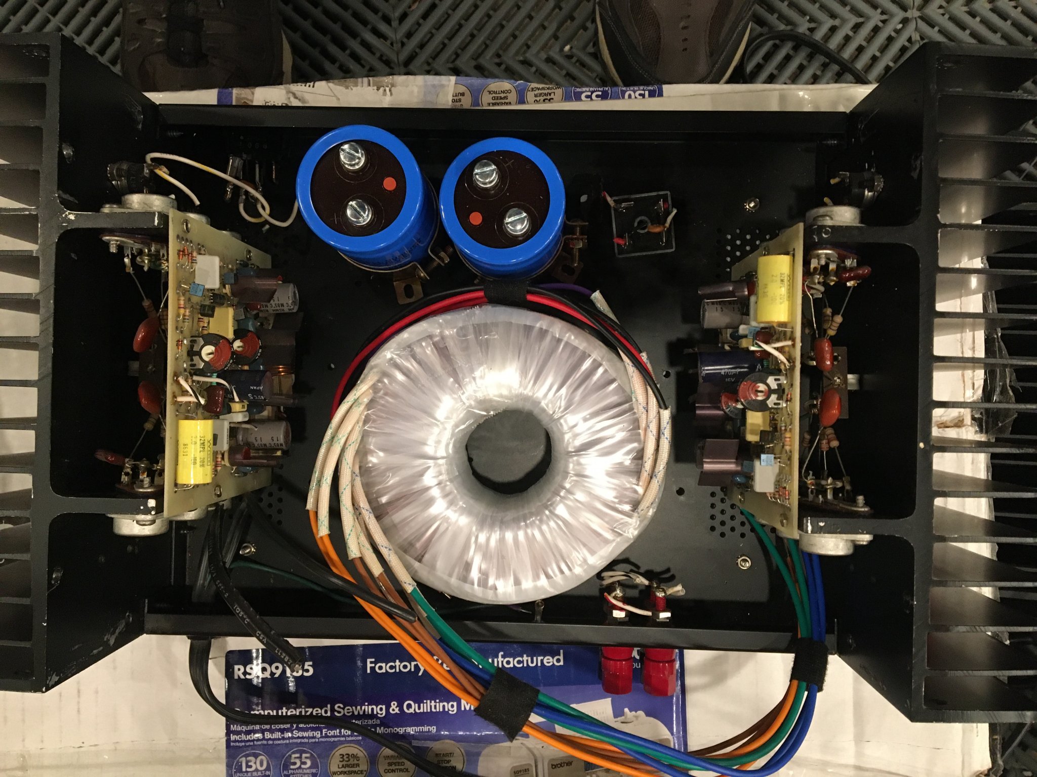

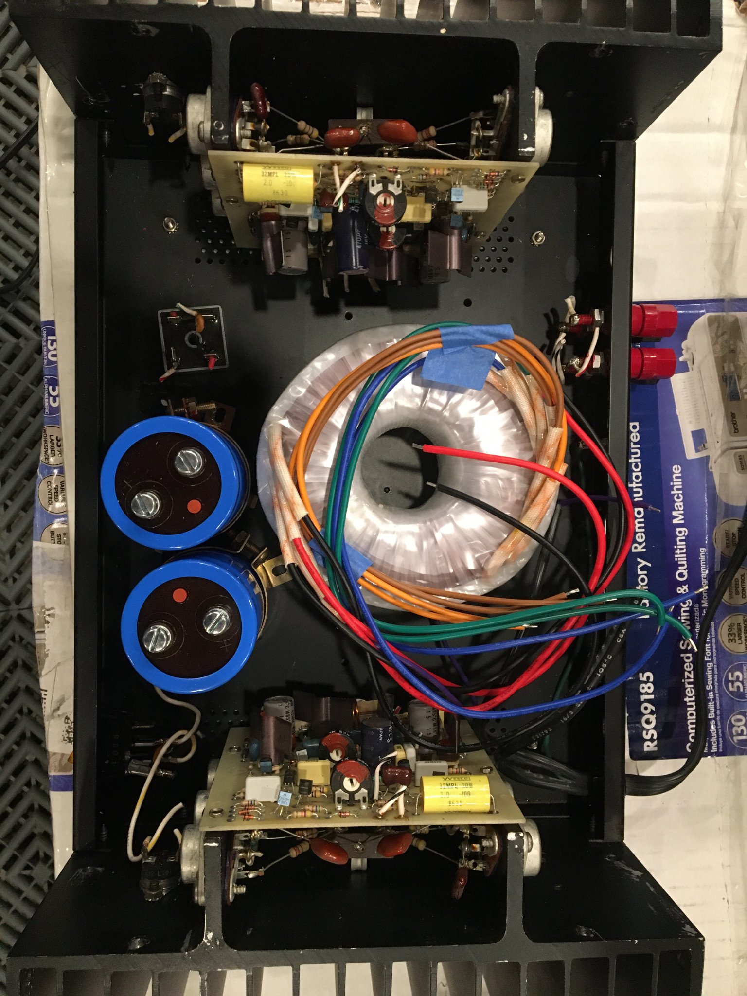

Had these parts around, and thought some photos may help, reading left to right:
1) Smart Theater Systems version of DH220 with toroidal transformer. Similar dimensions as Antek 300VA.
2) AnTek 300VA, in Hafler chassis. AN-3245 seems similar to Theater Systems part. AS 3445 has a shield and dual 15volt windings added
3) AnTek 400VA, in Hafler chassis. AN-4445 and AS-4445 are larger than the Theater Systems part. They both have dual 15volt windings added.
AS has a shield. The larger size should give you slightly more horsepower, but are closer to the high gain area, and more magnetic noise may result from that proximity. The 15 volt windings can be used to provide a cleaner and higher voltage supply to the voltage amp.

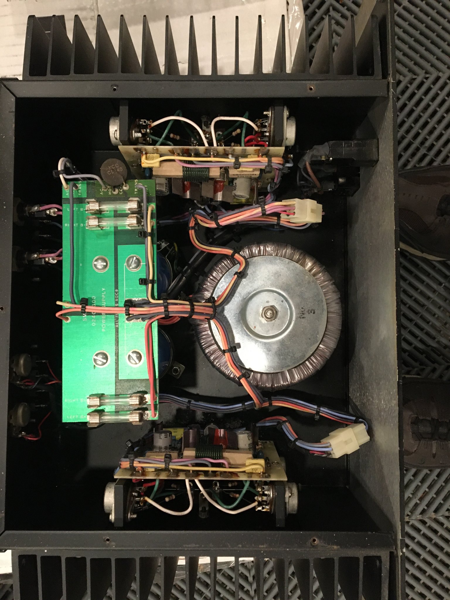

Hello,
Does anyone know the value of the output inductors pictured below? Labeled "L1 Output Inductor" on the parts list. I have a "modified" unit that I would like to rebuild and the inductors were removed.
Looks like 13? turns on that resistor of #18 or #17 AWG enamel copper magnet wire, so just wind your own and not worry about the value, which is usually around 1-2uH

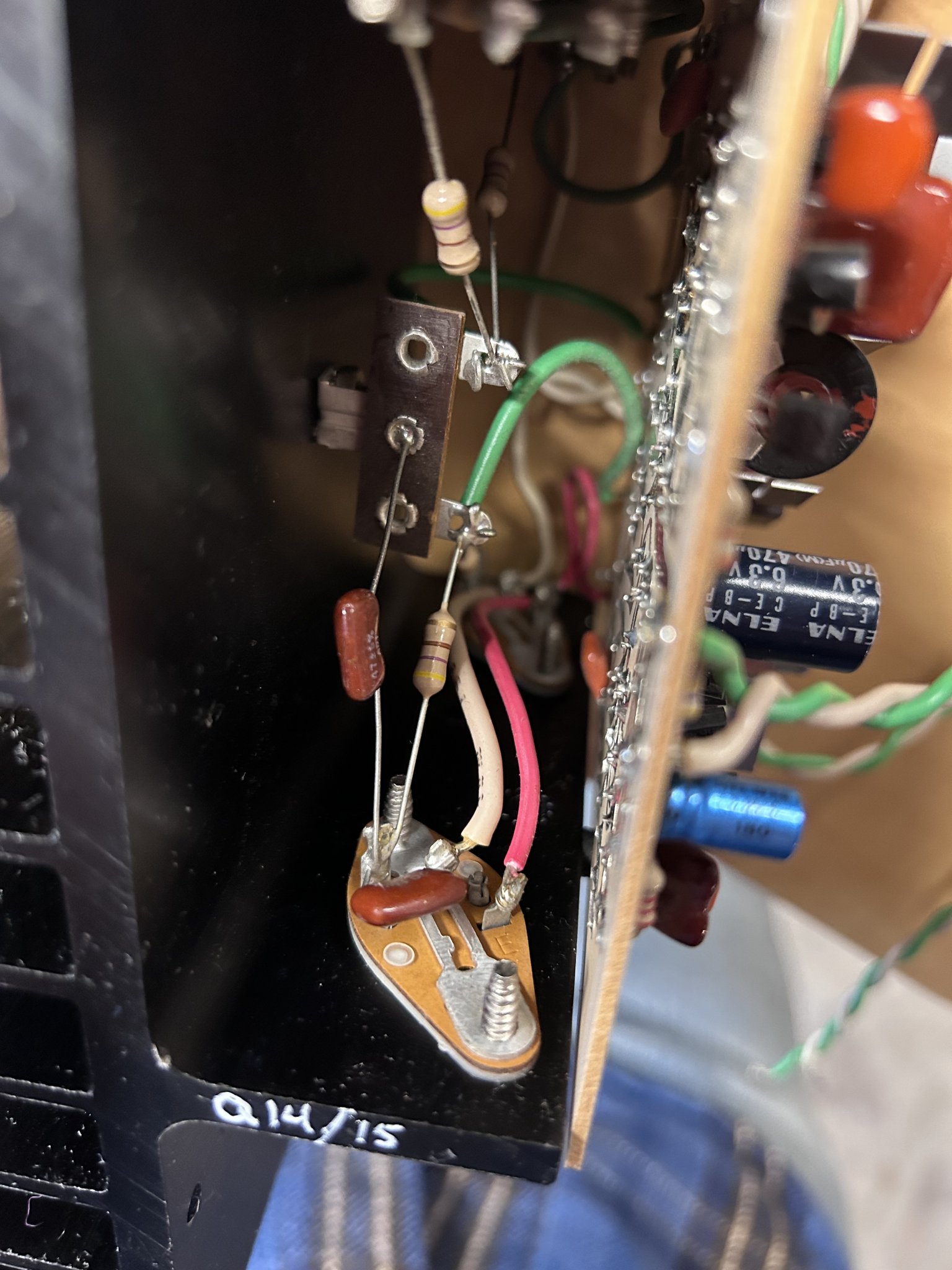

Ok. Thanks Rick. Now I see another anomoly.
According to the schematic, C18 is supposed to go from drain to chassis on the Q14/15. Does the attached picture not show the cap connected to the gate and since the gates aren’t paralleled, it’s only on Q14?
Also, the 390pf C13 is between gate and source and the consensus is a 33pf should go gate to source instead on N MOSFETs only, correct?
I see at least one or two pictures of these in this thread from other members that also appear to have C18 between gate and chassis! ????
