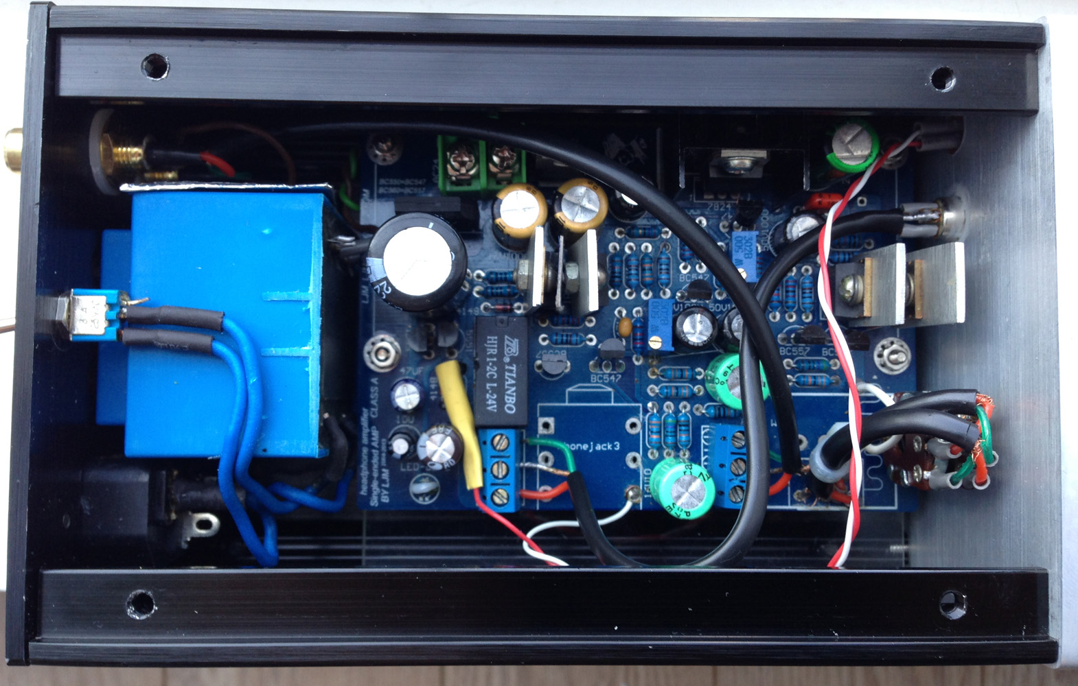

...done,working -had a blown irf610 nice mids into 150R headphones
just need some caps upgraded -in rest ok

Dear XSlavic, was necessary to insert those 22pF? You have high frequency oscilations? Why is better now the sound?

Yes,it did the job .Now the sound is perceived like a straight line more or less not an arc as without it with lows and highs at its ends.Did not try zobel for mosfets yet.
