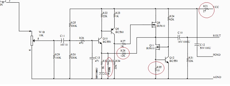

HI !
resistance of 64 ohms my headphones
Designer I bought supplied 22-ohm resistor is written 600 mV / 22 Ohm = 27 mA.
but on medium began prisuvstvovat distortion, I raised the quiescent current to 50 mA distortions became smaller, but the output transistors become much bask in design offers the radiators are not provided.
And so I ask - is there a dependence of the resistance and quiescent current of headphones? How do I choose the optimal mode quiescent current ..... listening?
What is the quiescent current to typically IRF610 -?
The project is completed!
quiescent current of 50 mA

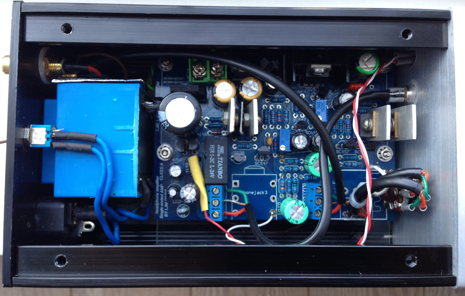

I bought this board from audiophonics. The high gain is a but ridiculous, however I would say it's a good amp for high impedance headphones. I plan on doing a few mods to it. It comes with 20k stepped pot which I will switch out for a 10k ALPS, like the schematic. I'll also bring the gain down to something sensible.
When I have the volume high it seems to clip too. Probably because it runs out of current.
Thinking of making a case at lasergist and also using a 24V wall wart to power it. That way it simple and cheap.
Not all sources are 2Vrms and not all music is mixed to for maximum loudness. 6x is perfectly in-line with the high gain mode I have for other headphone amps I have.
Plus I don't want to have the opposite problem where the pot is pegged near max instead of the pot near min.

I have the old version. There was a lot of ripple, very audible. I improved this making changes to the power supply to use a 7824 regulator. It has improved, but there is still some noise. This is normal? Is there any way to eliminate ripple?
Assuming there is no bad ground wiring, I'd bump C7/C12 to 1000u (or more, if they fit the PCB).
This bring cutoff of the RC filter down to ~5Hz instead of ~60Hz.
Many thanks for your suggestion, my friend. I replaced the capacitors with 2200 uf. There was no improvement. There are no problems with grounding. A low frequency noise persists. Not too loud, but noticeable when there is no music. I will try to change the font filtering as LM317 instead of 7824.

Recently my improvements on the HA - PRO.
After test. I found that the performance of the BJT is better than MOSFET.
Recommend to use 2 sc5171. Replace IRF610.
I will use the new version of ONSEMI TIP41C
Add a cap multiplier using IRF610. It will have 4v dropout but ripple will be -50dB.

Every product can be improved and modified. This happens. But, is not the case this headphone amplifier. It was released with gross and inadmissible errors. Much low frequency noise, lack of heatsinks for power transistors, bad design, among others. Haste is the enemy of perfection.
I made the proposed changes. Before, I had switched the filtering from the source, replacing the mosfet with 7824. Conclusions: it remains a mediocre headphone amplifier. I have a 47 headphone amplifier for $ 8.00 which is a lot better.
Another thing: when the power is turned on, the DC current at the output reaches more than 200mv and goes slowly down, for several seconds, until reaching acceptable levels. I do not know how much harmful this is to my headphones.
