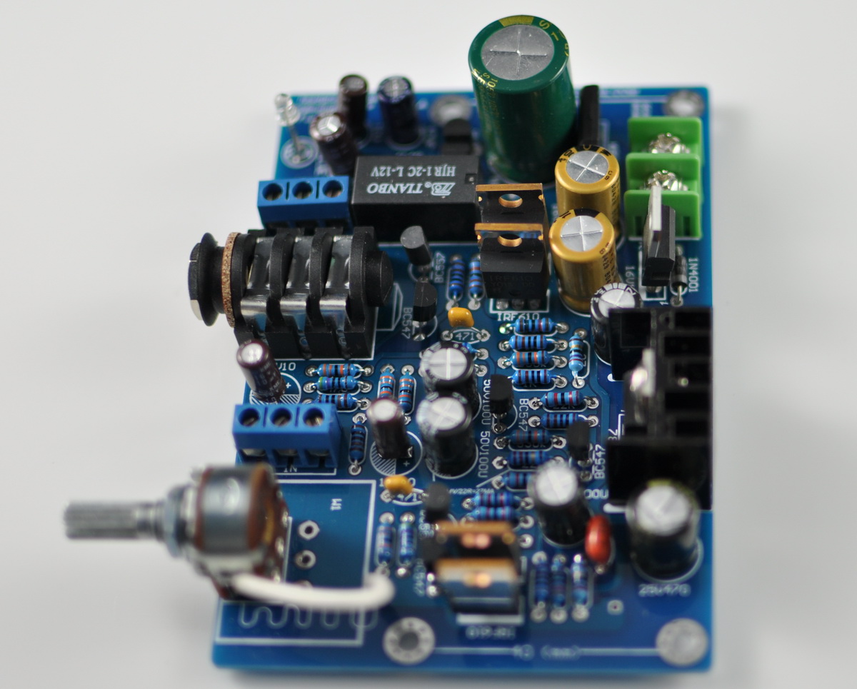

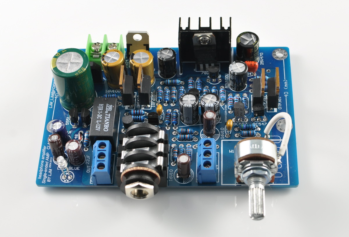

HA-PRO Single-ended MOSFET
I made the proposed changes. Before, I had switched the filtering from the source, replacing the mosfet with 7824. Conclusions: it remains a mediocre headphone amplifier. I have a 47 headphone amplifier for $ 8.00 which is a lot better.

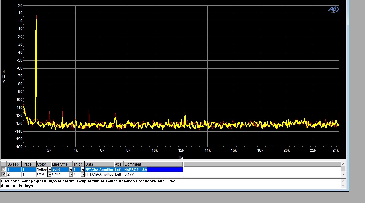

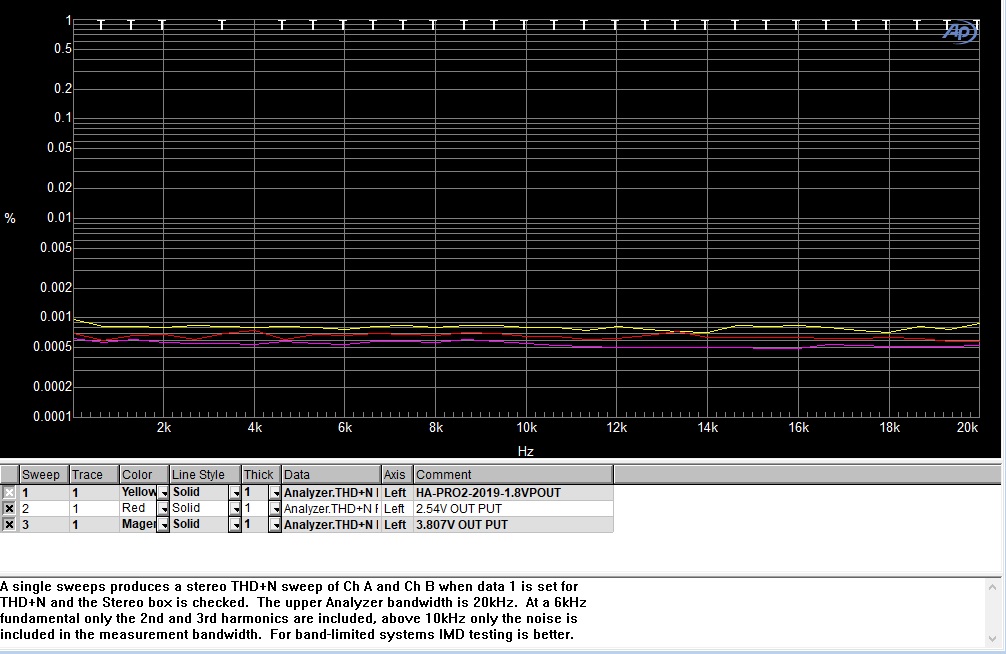

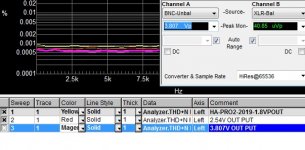

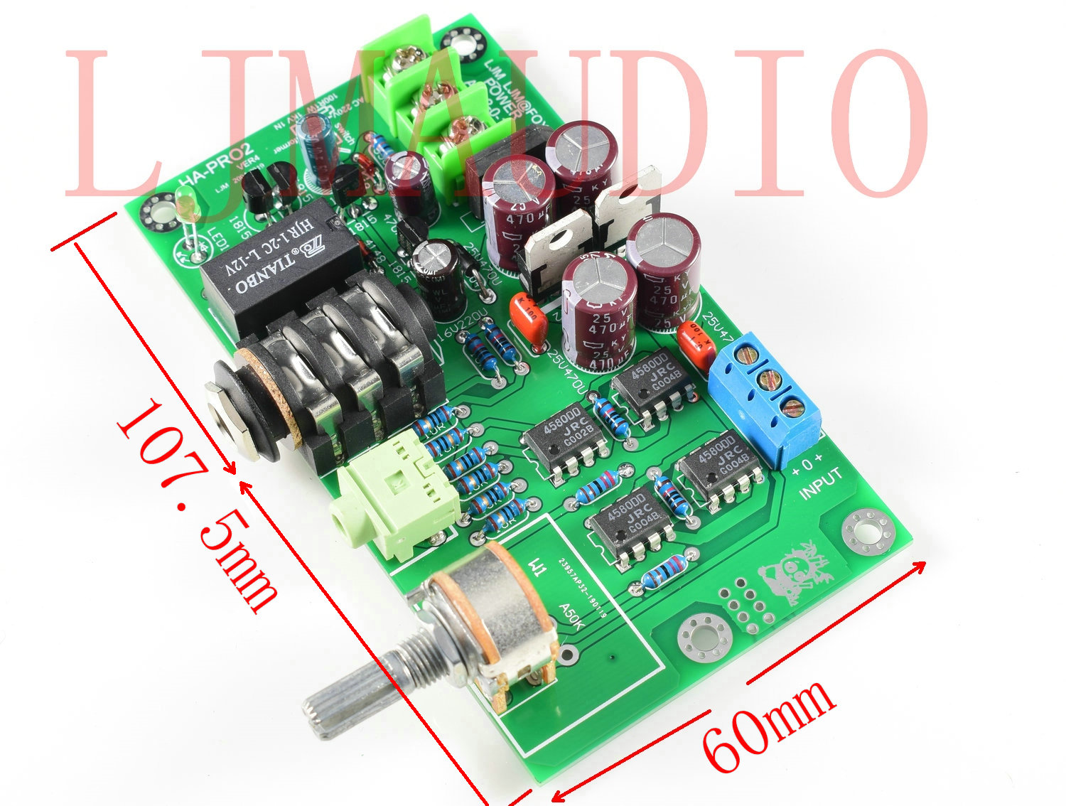

In fact personally, I prefer the operational amplifier. Production of headphone amplifier.

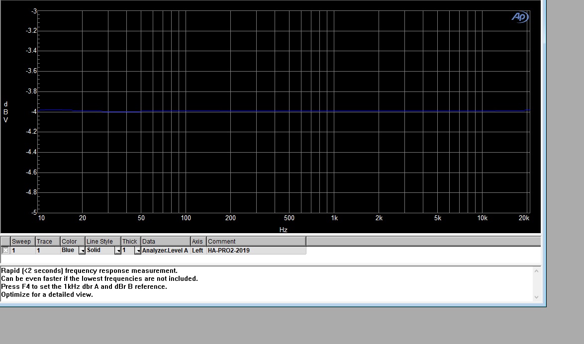

HA - PRO2 is my design, high performance amplifier, low distortion is composed of eight single op-amp.
It's very small distortion and noise. At least 10 times better than 47 headphone amplifier performance. This is my test results.
But in fact. There are still many people do not like the operational amplifier. I have a friend, he used a lot of amplifier, finally still like HA - PRO single-ended amplifier. Is TIP41C version.
The single-ended amplifier has many shortcomings, but his voice is very special. Some people don't like it. Because it has no low distortion and noise. But there are many people like the sound of it.
If someone need to other test data can email me. I really very slow landing site.
Three minutes maybe can open web pages.
Here I send a HA - PRO2 test data of low distortion amplifier.
Audio Precision 2

Many thanks for your suggestion, my friend. I replaced the capacitors with 2200 uf. There was no improvement. There are no problems with grounding. A low frequency noise persists. Not too loud, but noticeable when there is no music. I will try to change the font filtering as LM317 instead of 7824.
I didn't use LM7824 in about five years ago. But the LM317
Of course. The original photos that long PCB.
Less. The latter is a kind of double sided PCB. Can reduce the noise.

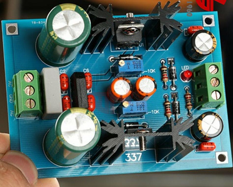

Well it is a couple of years too late. However I have the original long board and a simple solution is to power it from regulated +34V. I use +/- 17V from a low noise LM317/LM337 board.
So I use the + and - outputs to get the +34V regulated (low noise) which is connected to the screw terminals for the AC24-28. The polarity must be correct or it will not turn on the diodes and the bridge.
I left the IRF640/TL431 regulator in circuit. No modifications to the old long board. So if you have the old original long board and you don't like the hum you could try this. The attached supply is only $6 on AliExpress and is very useful and low noise.
Not strange at all!
34 = 24*1.414
That is the same voltage the filter capacitors charge up to when you hook up 24VAC which is what LJM specifies for the design.
The only difference is that the diodes are not switching and there is no (or almost no) ripple anymore. Quick and easy fix resulting in a very clean supply.
