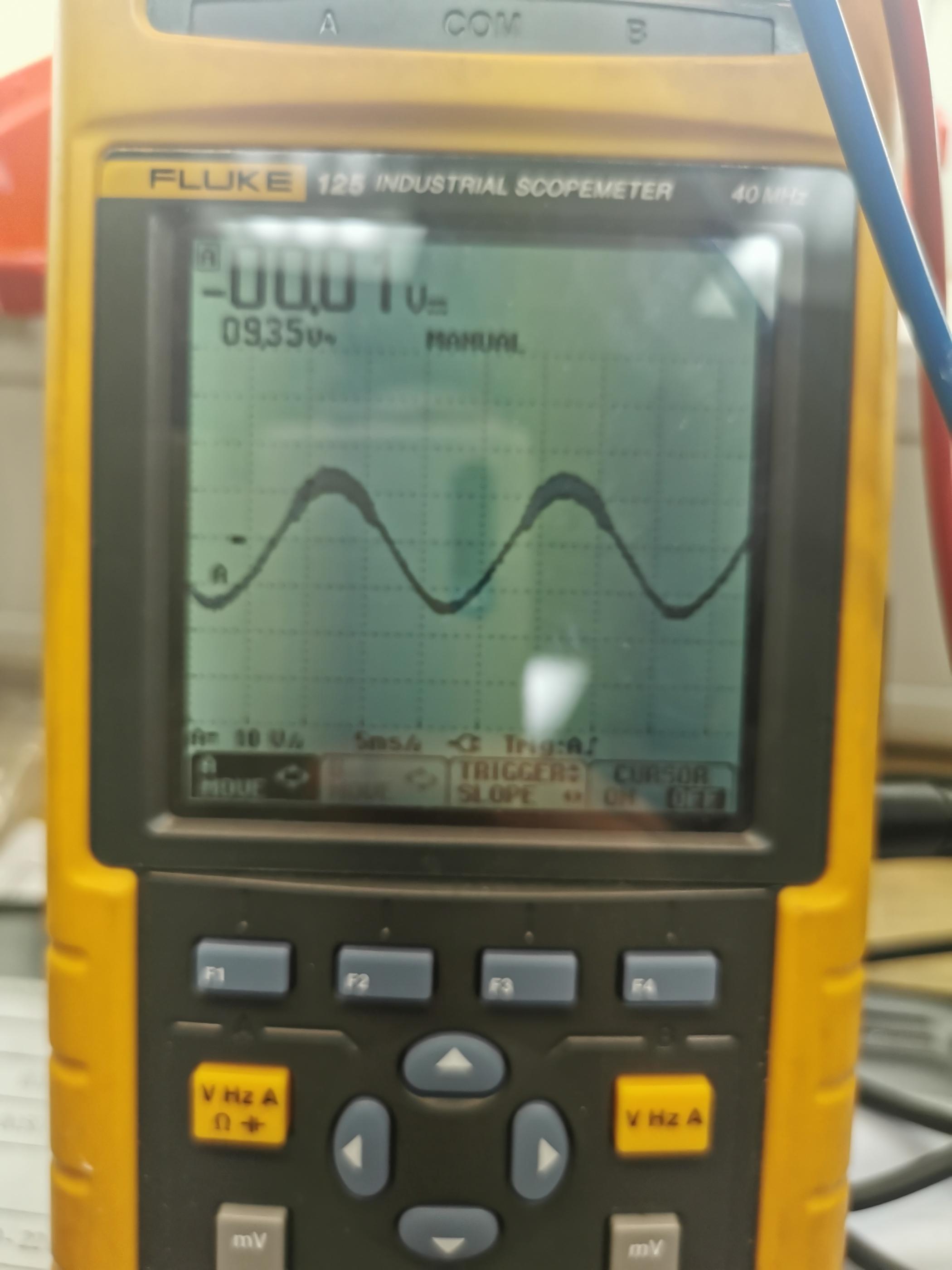

I will evaluate it later. Without load connected, everything is fine, i can go into clipping.
With load 1,2Ohm connected, and even small input it is allready disturbed. Also the rail voltage dropped very quick, and the oscilloscope cant recognize the voltage anymore.
That occurs allready with 12,5V DC and 7Amps input.

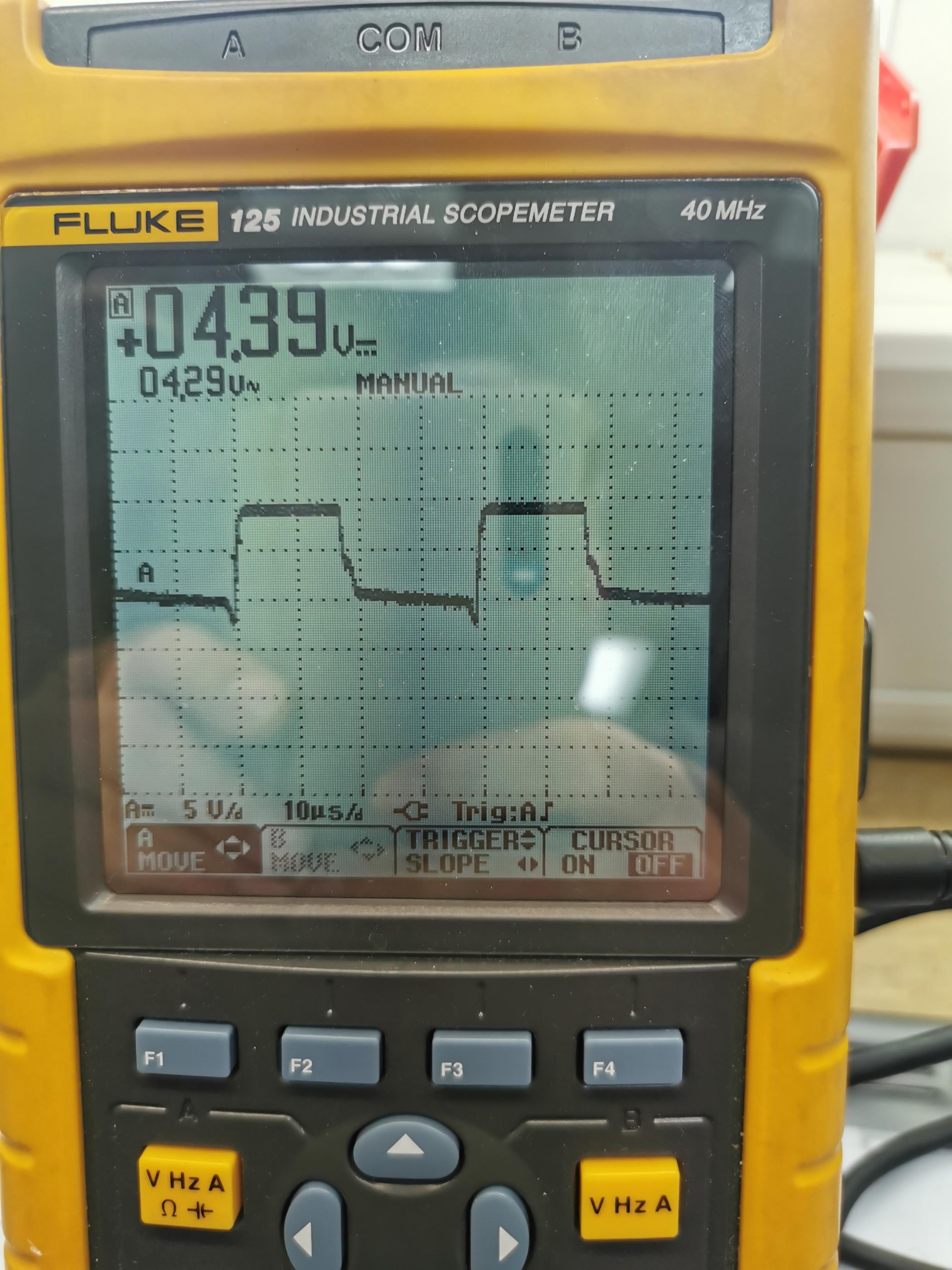

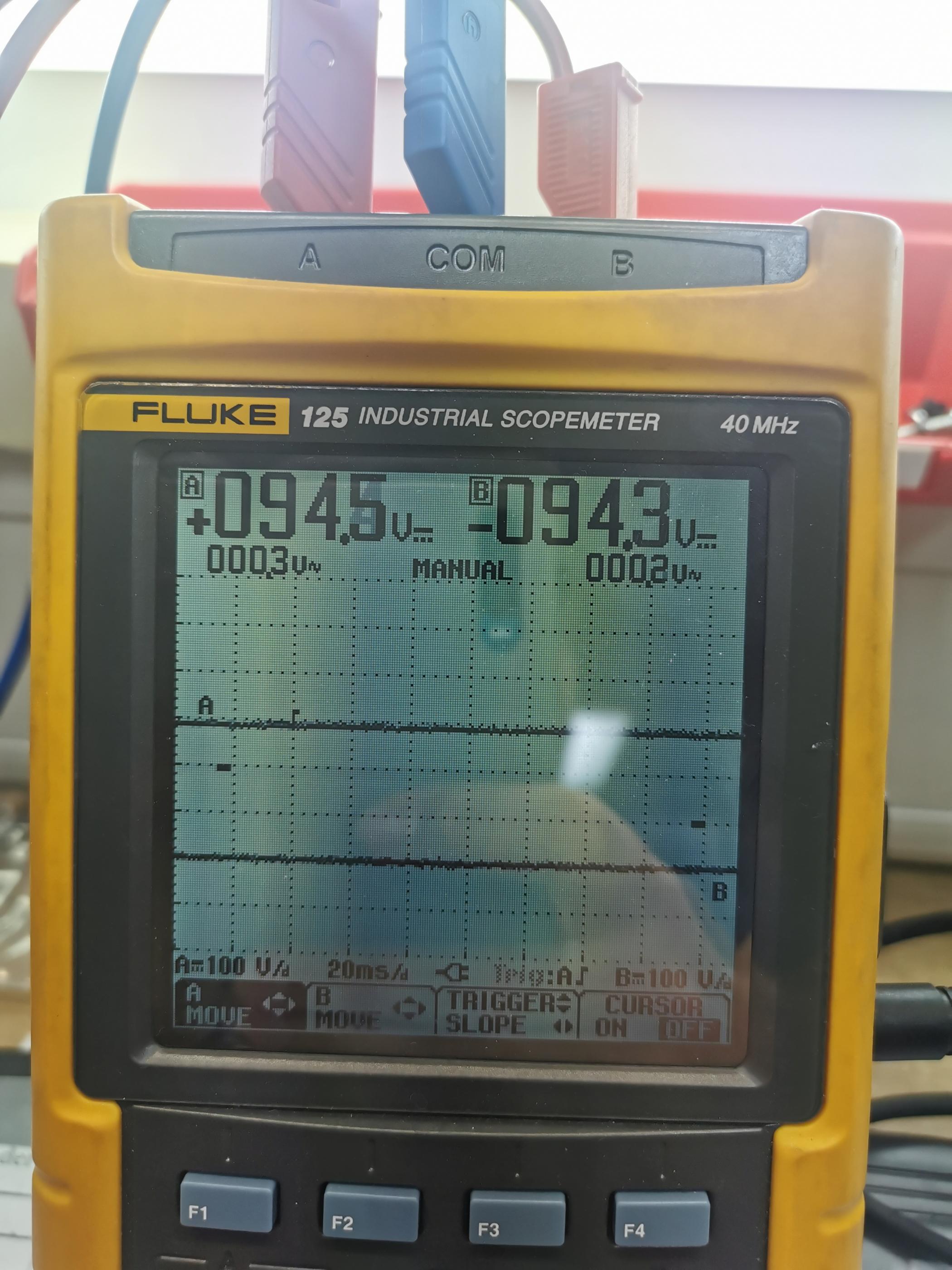

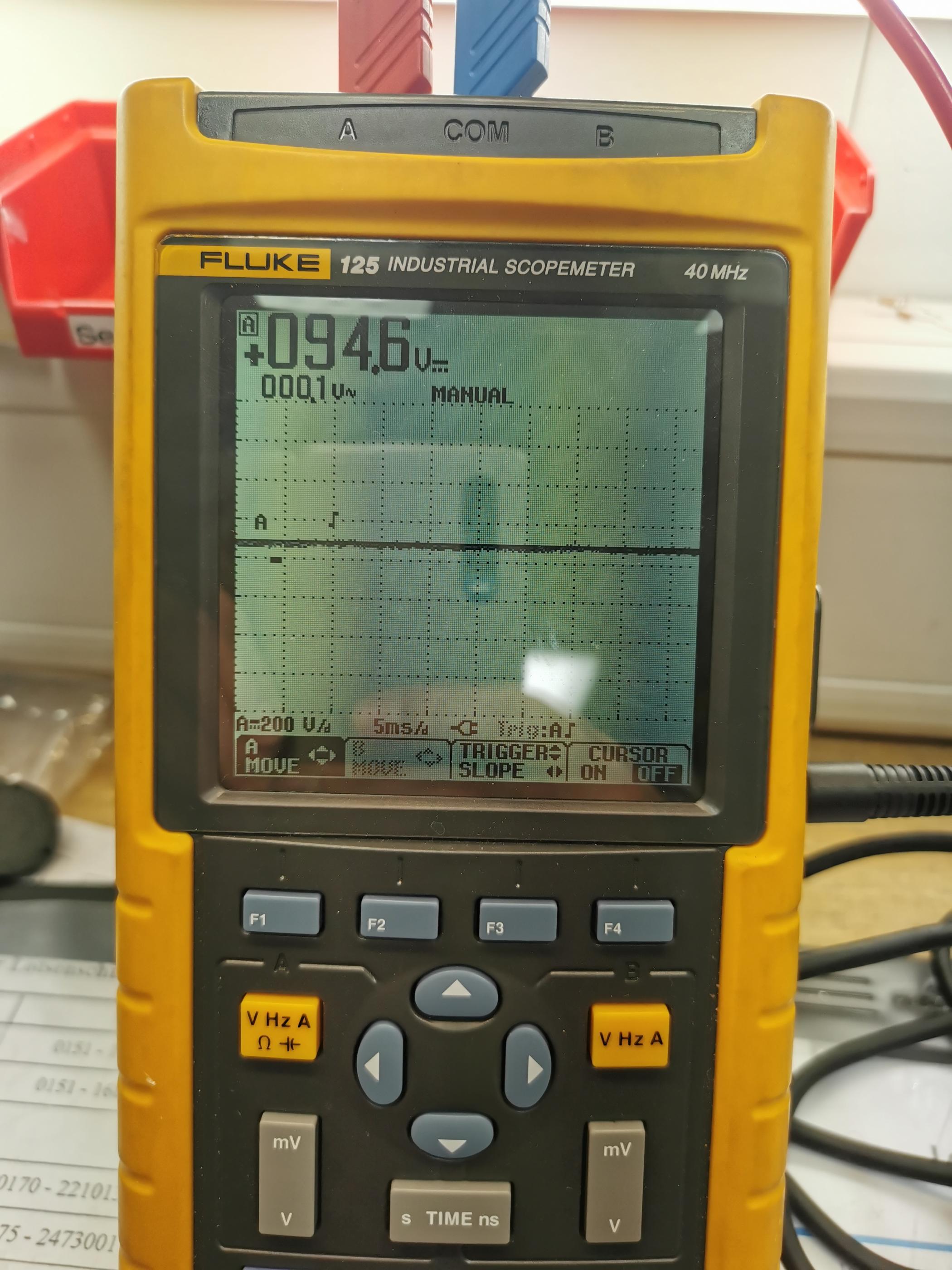

So here are some pictures. Hopefully it will help. 95v with gain at minimum. The other picture with gain at little higher. Input 10 amps.
The last picture is pulse from ps fet
Stays stable all the time.

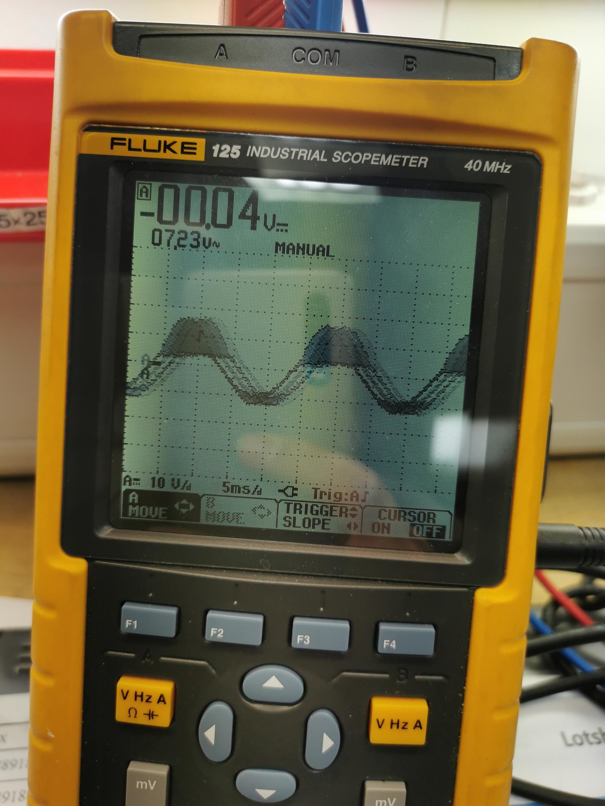

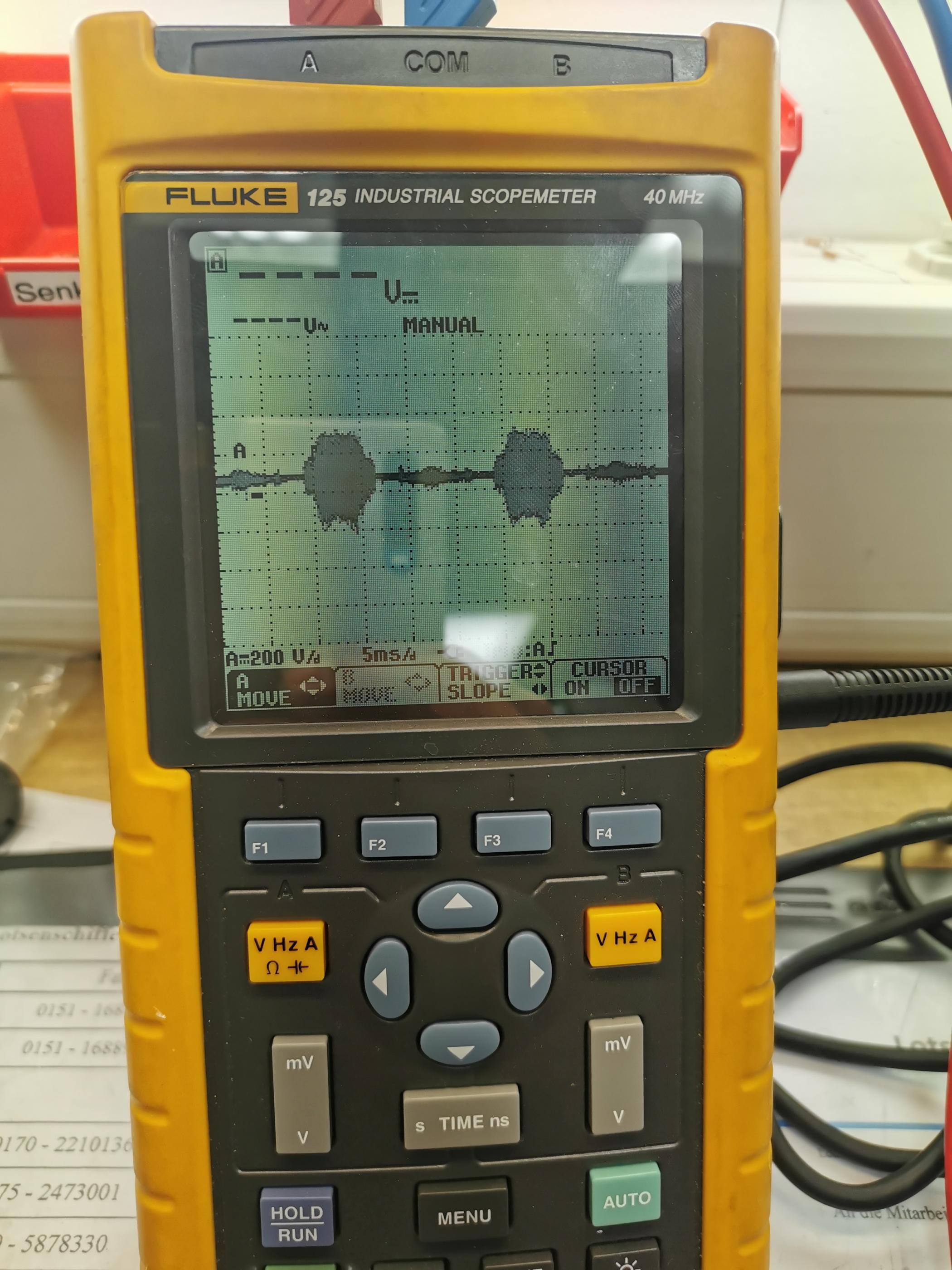

I don't know.. If I connect the measure cables on common sec and rail plus, the output is strong distorted, without, it looks like the previous post, last picture. Anyway, if I go on the limit from my power supply, first it breaks down the positive half. Then the amp switch off with protection

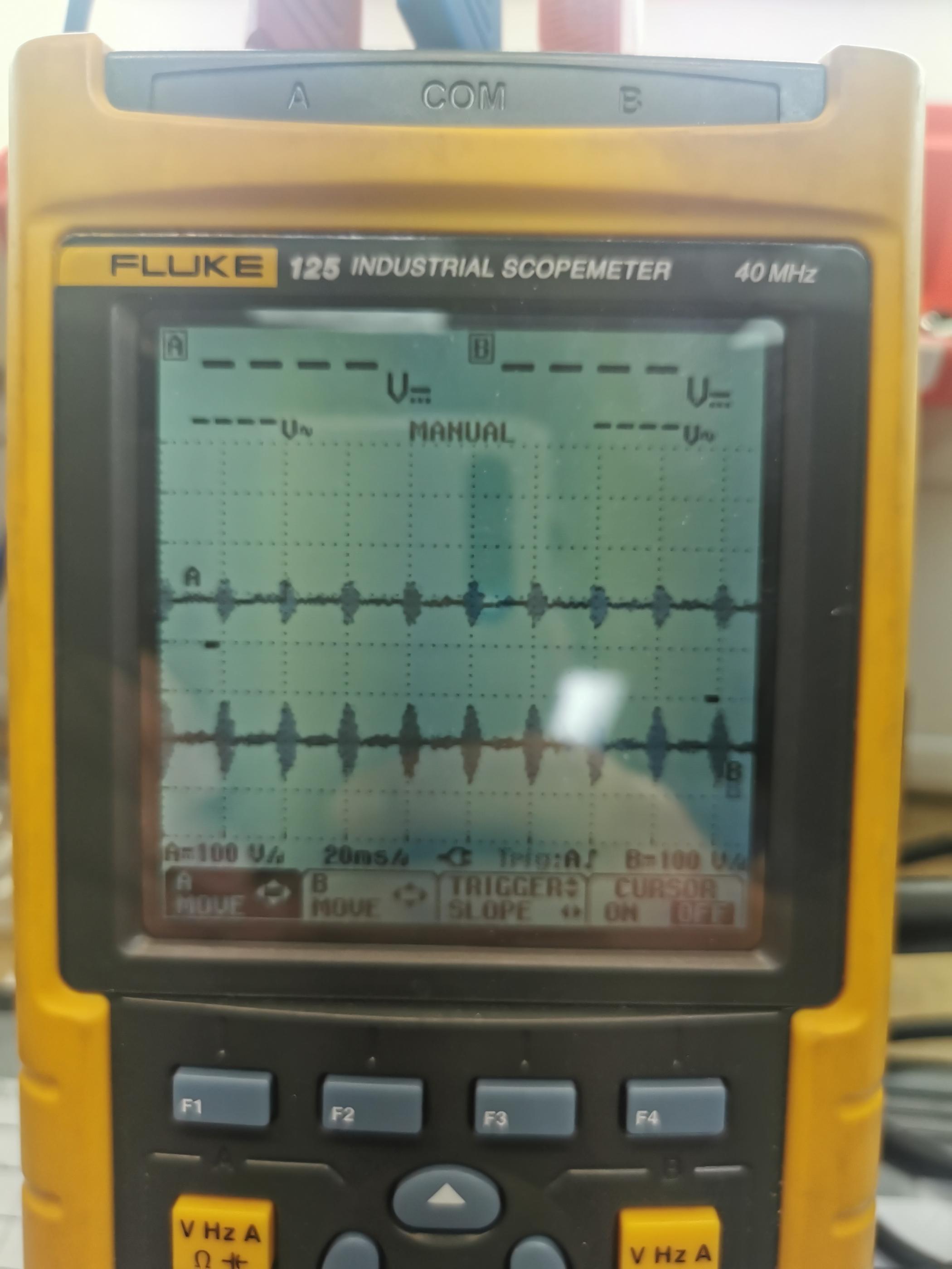

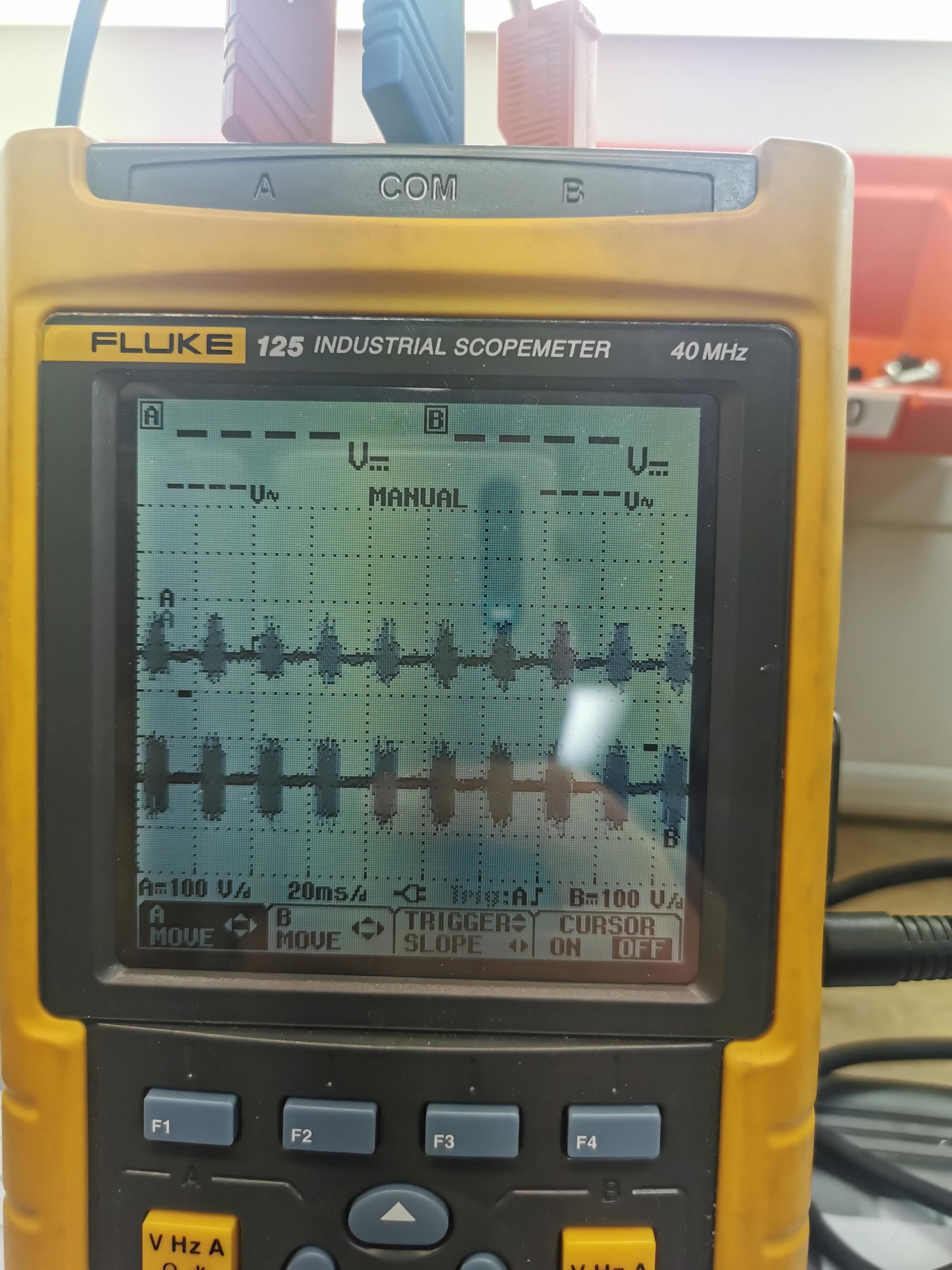

Compare the positive rail to the negative rail. Do they look approximately the same or is the positive rail really noisy in comparison?
Upper one is positive, lower negative. They are nearly the same. I made pictures at different input levels.
I have tested also before the audio input at the driveboard, with driverboard dismounted. The singnal is clean, which is going to the drive board.
Is the noise on the rails going all of the way to ground? Assuming that the dash/rectangle is ground for the nearest trace.
The low side looks worse than the high side but there is no noise on the negative part of the output signal. That too is odd.
On the negative rail, its going completly down to ground. I will try with another power supply, but the other has only 5 amps... Maybe i can reproduce it, so that iam shure it comes from the amp.
