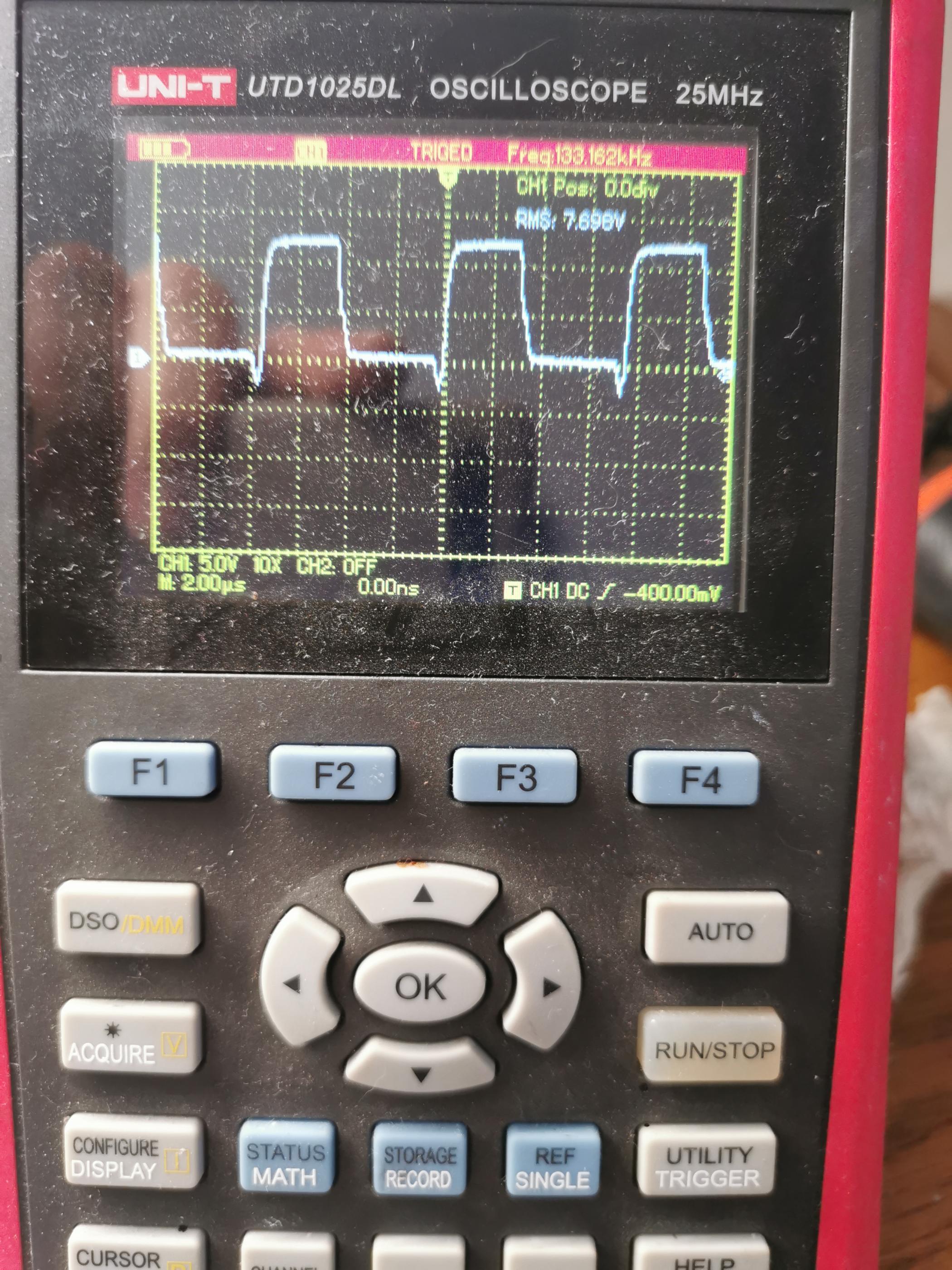

I don't think, that it is correct, to have the sine wave on the +-5v input for the drive board.. Can someone explain please.. It's also on the +-15v but only if I increase the gain. but only, if I use signal ground. If I use secondary, then it's normal.

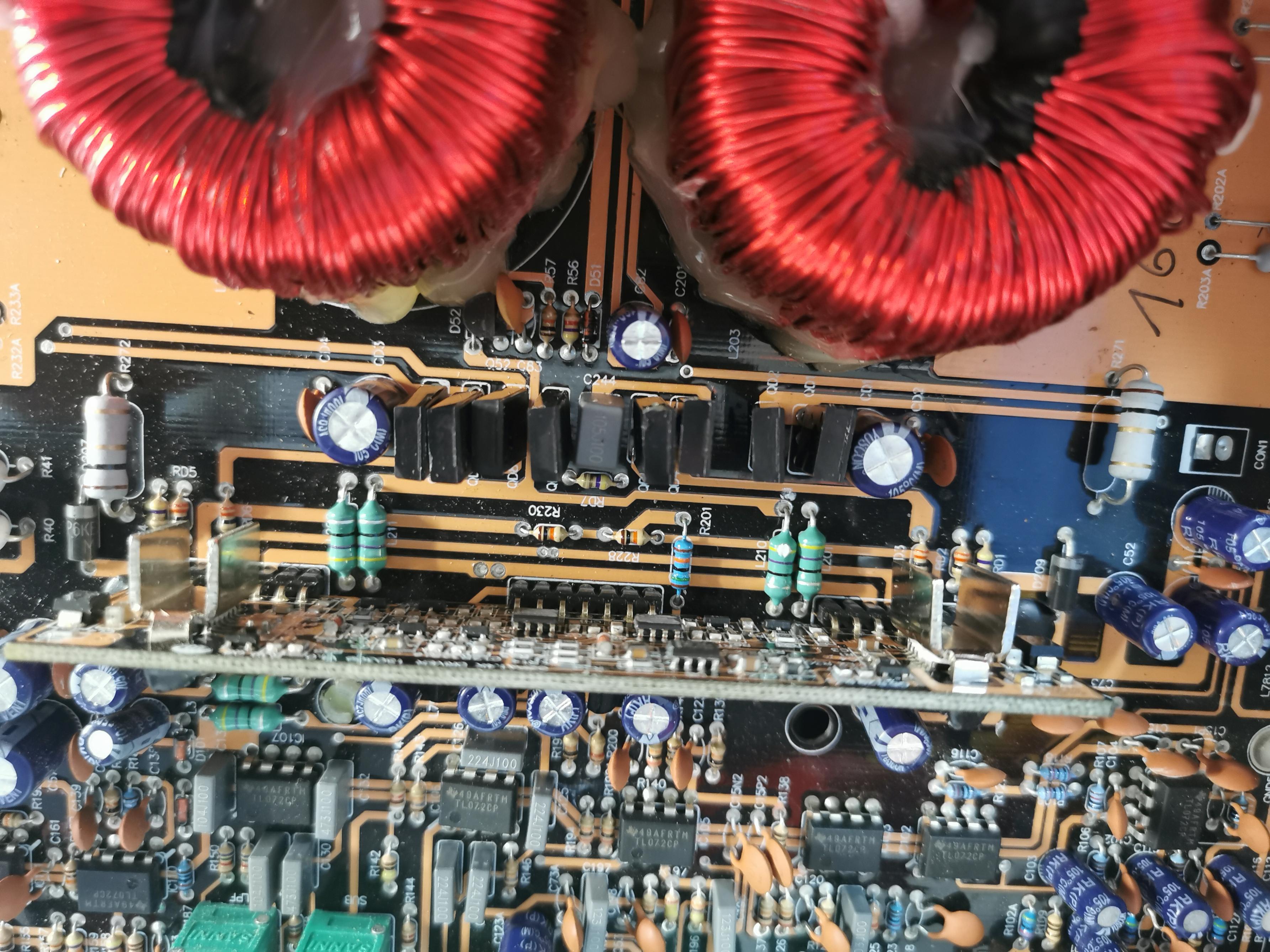

Did you ever check the value of the filter caps for the high-side B+ of the 21844?
Did you install a feedback resistor on terminals 1 and 2 of the TL072 when you were checking its signals?
Are you using a signal source with a grounded shield?

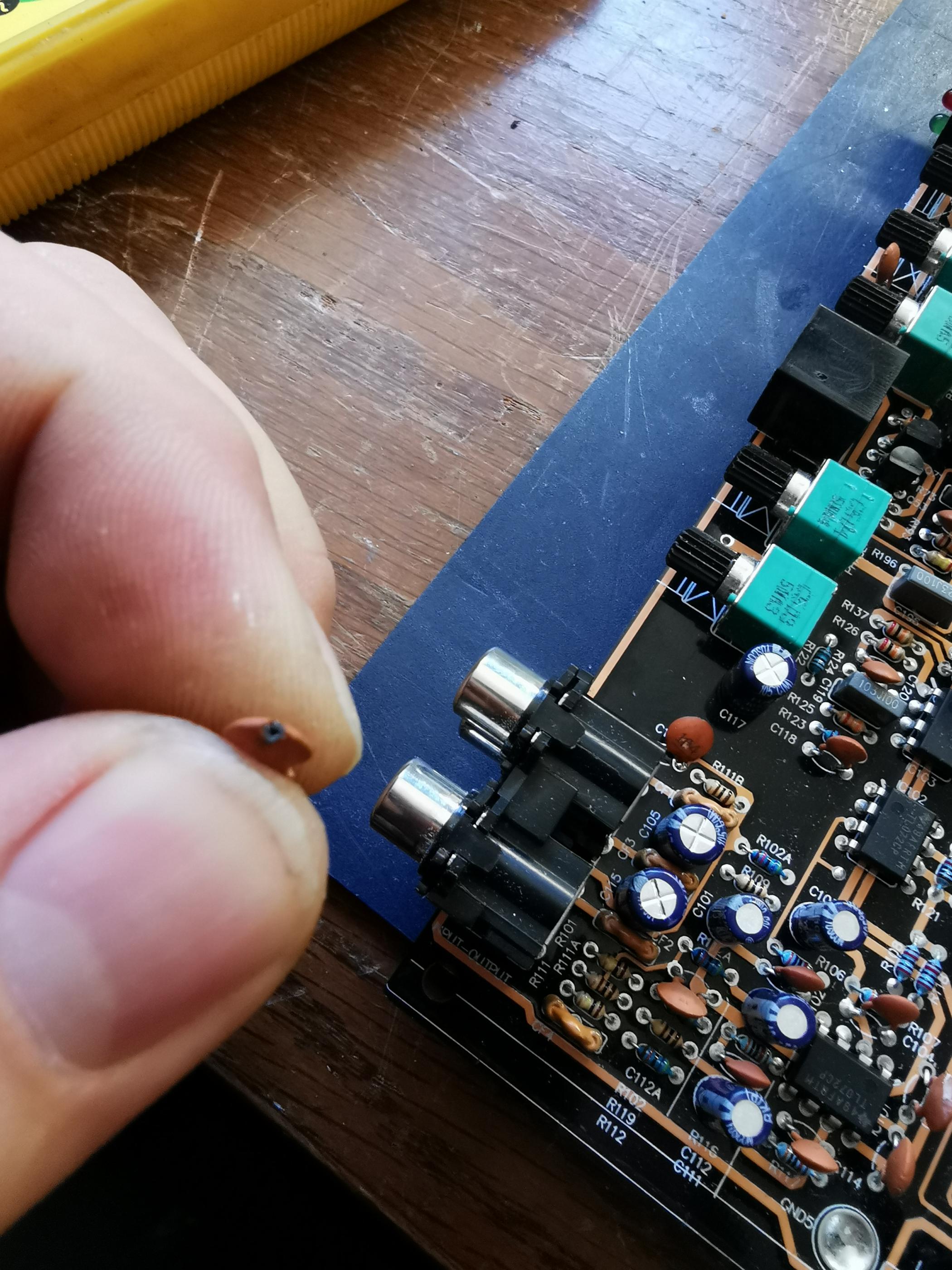

You mean this small caps on the driver board? No, i dont. which value should they have?
No feedback resistor mounted. I always use a smartphone as audio signal. At home i have a fequency generator.

With some amps, an ungrounded/floating shield can cause problems.
The caps for the high side have been from 4.7uF to 10uF. 5.6uF and 6.8uF seem to be the most common.

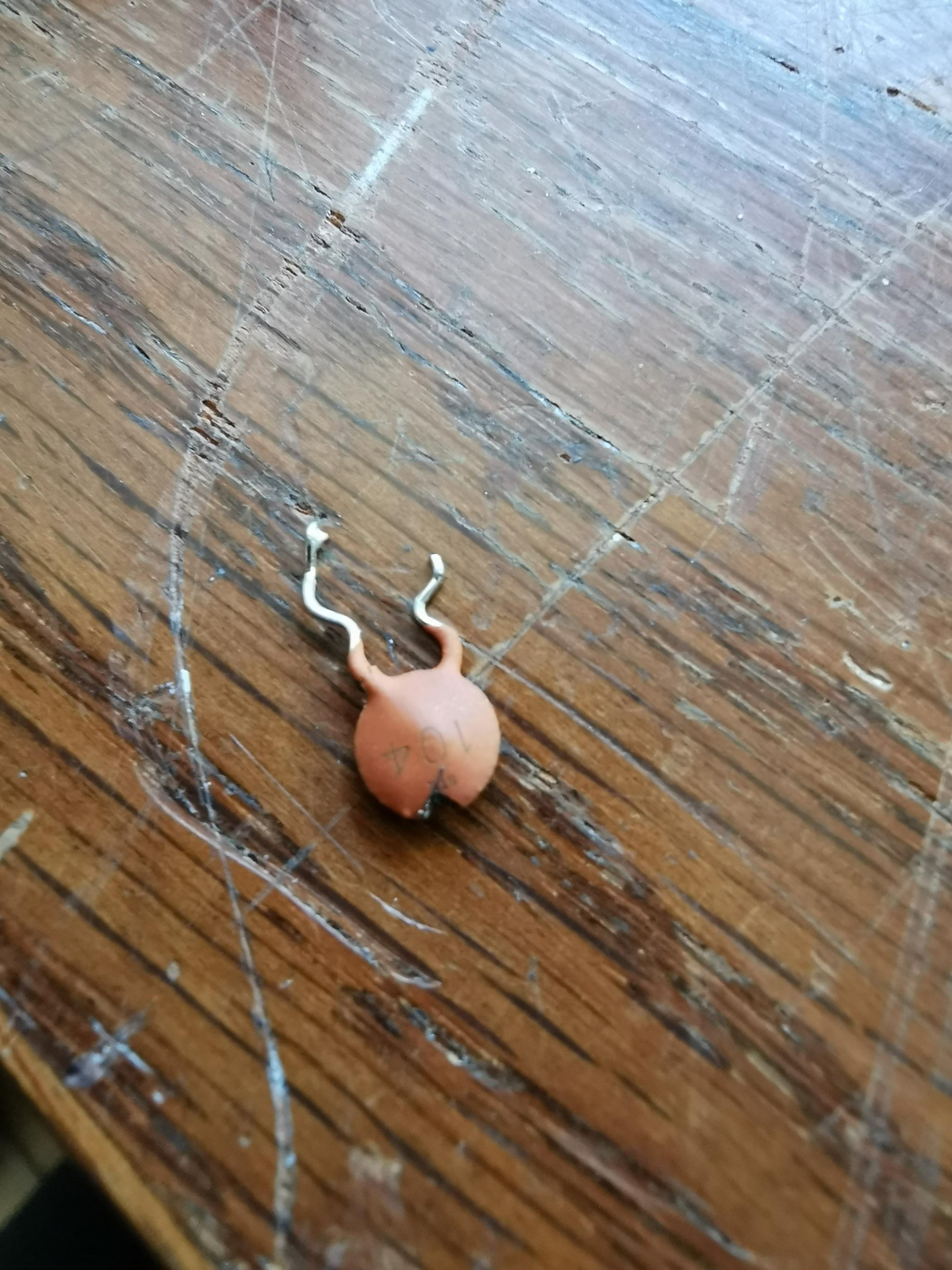

I checked the caps. One has 4.4uf the other 4.6uf..i think it is OK. Do they have a specific direction?
Most are ceramic which aren't polarized. That doesn't apply if they are tantalum or something other than ceramic.
