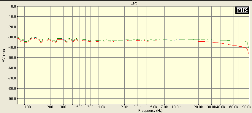

Will try to measure the Tracker with crapiest leads and pot I can find at top sampling rate to report back. Tomorrow.

Here you are, this is Emu Tracker Pre at 192kHz 65536pts FFT, no flattening compensation file, looping itself in pink noise at 1/12 Oct resolution. Green is crappy 1.5m coax they throw in $29 DVD players, looping alone. Did not make a change to 10cm RG179. Red is plus a pot set at midpoint, and thin 30cm aligator clips to connect it. Pot is corroded open metal case $2 100K Ohm carbon. 100K is the most usual value to be found in a tube preamp. Thus red is 50K Rs driving 1Meg input in essence. Miller of a tube or Cinput of card forms RC. For neutral measurements of this kind, buffering is essential. Else, passive components interact freely with the loop parameters, for nominal values and/or extra capacitances they may carry.
Thank you Nick. This confirms my data. Your explanation makes perfect sense on the importance of the interaction of cable capacitance on when dealing with higher impedances.
Even in DCB1 I spec 22K Log max because it limits BW (although far higher than here) and its a JFET buffer. Those high gm parts always have elevated Ciss & Crss. But the cable wasn't the problem in our example above. The high source resistance that the pot lend was. That is why buffered pots are better. Be it a DCB1 or my 6V6 bootstrapped cathode follower. Same story. Better than a pot alone.

Passive is fine, provided the pot has a low resistance and the output cable is short. It also requires the next stage to have a high or linear input impedance - not always true. As in everything else, OK when used appropriately.
And then there is the drive thing. Even a 10K pot means 5K Rsource at half value setting. Keep that or current boost that, matter of application and receiver's demands.
No. 10K pot at halfway is 2.5K source, assuming it is driven from lowish impedance (which will normally be the case).

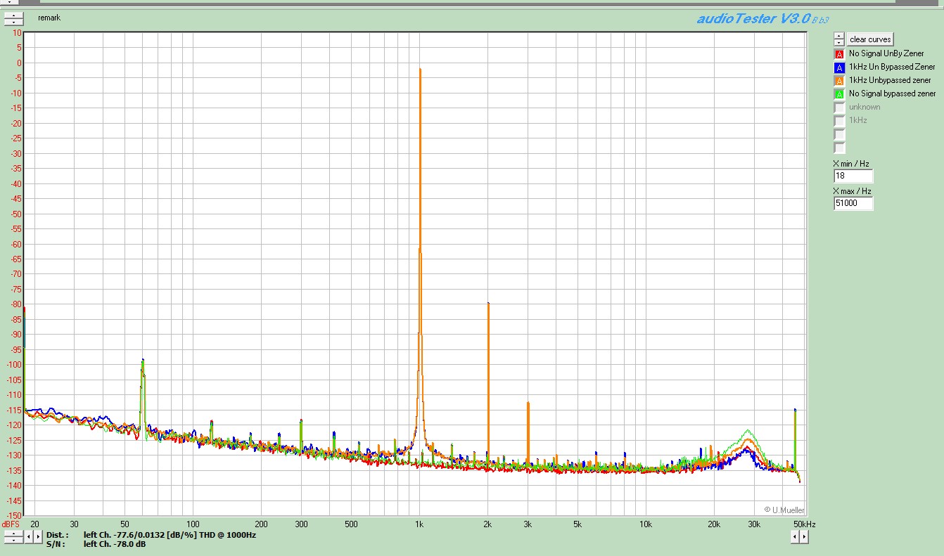

Salas, In response to your post earlier regarding the noise of the zener. I did a little experiment before I switch out the zener with a couple of precision references. In the attached FFT plots, I compare the zener un-bypassed and bypassed. The cap used was a 220uF FC panasonic. 1V=0dB. I did not see a difference in this. I think I have a couple of precision references but haven't found them yet. Will post that when I do.
I am not sure what the hump is beteen 20k and 30k, but the unbypassed seem to perform better. The hump is part of the noise spectrum of the circuit. It is not present in the background FFT when I turn it off.
Looks like being in the anode load circuit the lower circuit (tube) dominates for noise. Did you bypass the LEDS to also see?

LEDS are still bypassed. I will run a couple of sweeps with and without they LED bypass. I could also incorporate a decent bypass for the caps and see if there is a measureable difference.
You got a very nice result for noise floor and THD anyway. But lets see all the parameters, its about knowing the circuit's practical behaviour.

I don't know why DT accuses me of being OT, as driving impedance for capacitance is one of the things we are talking about in this thread. Halving the impedance doubles the roll-off frequency.
