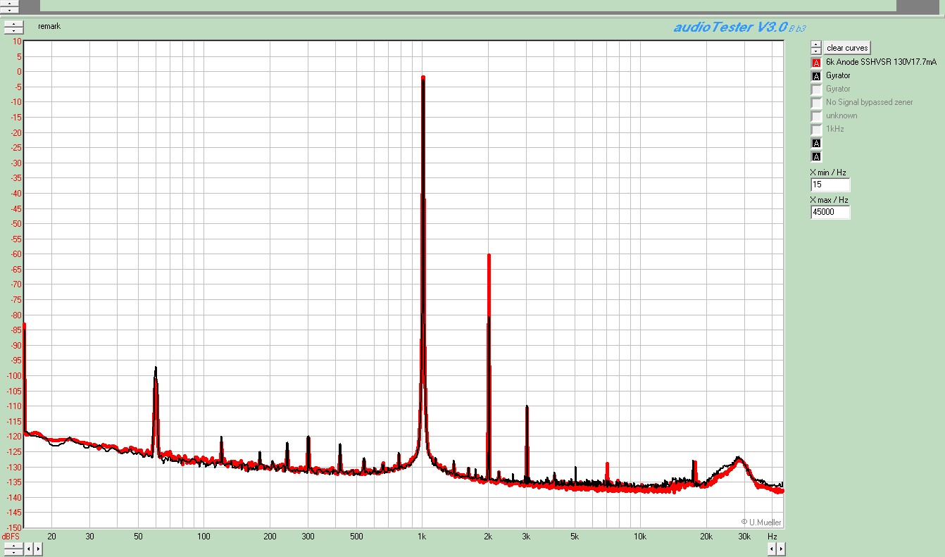

The FFT above was taken with a GE jan12b4a NOS with a Gyrator load. The B+ is supplied by a SSHVS with incoming voltage of 300V and total current of 63mA
B+ =210V
Anode = 130V
Vb = 15.2 V with a series of 8 LED bypassed with 660uF FC type electrolytics
I have not yet bypassed the electrolytics with a good film.
Tube Bias is 19.9mA
Input impedance was 100k with no attenuation in circuit.
Filaments are DC 6.3volts regulated and then biased to 20Volts above ground.
Input signal was 0.1667 Vrms Sine from soundcard
Output was 1.0 Vrms
Measurements were taken direct to 1616m Soundcard.
The soundcard was brought close to test stand and short (20cm) RG59/U cables were used.
The FFT shown above has been verified at three different test sessions. The frequency response is 10Hz-40,000Hz +/- 0.02dB. 40,000Hz is useful limit of the testing parameters of 96k/32bit.
Hope that answers the particulars......😀

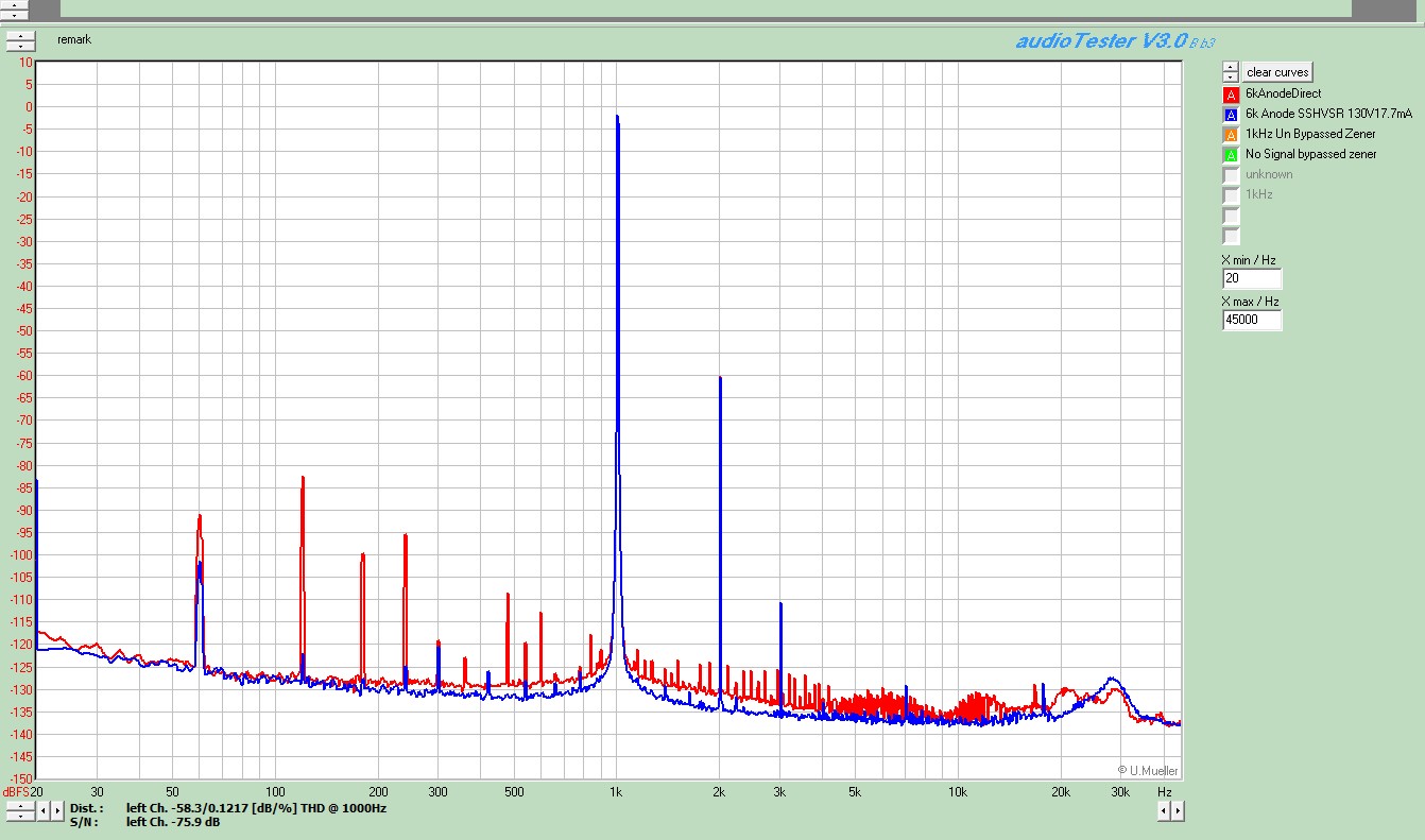

Today I wanted to compare the performance of the Gyrator vs a resistive anode load on the 12b4. That expanded to look at the impact of the SSHVSR. So I will start with the SSHVSR first.
Conditions 1Vrms=0dB 6kResistor Anode Load. Using the same operating point described earlier with the anode = 130V etc.
The main impact of the SSHVSR was in noise. As can be seen in the first plot, not only does the SSHVSR reduce drastically 60Hz and its harmonics , but the general noise floor as well.
Red = No SSHVSR Blue= With SSHVSR
There was no significant difference in THD with or without the SSHVSR although it did provide for a better S/N ratio by 4dB. THD measured 0.122%.
So the SSHVSR stays at this point.

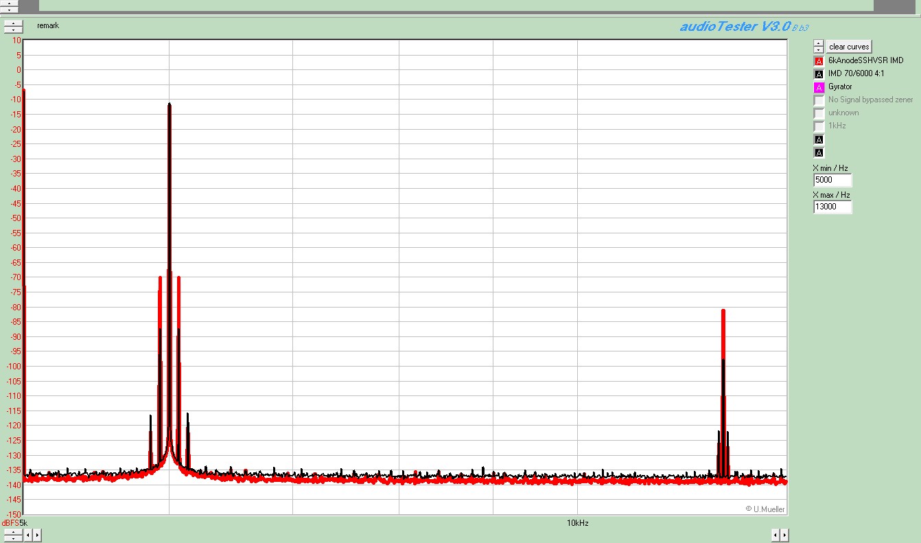

Bringing the Gyrator in is were we start to see some significant differences in the harmonic performance. In the second FFT plot we see that comparison. In both cases the SSHVSR is employed and tube operating point is the same. The second harmonics have dropped by 20dB while the third has remained the same. Although not really a huge difference but I consistantly saw a couple of dB greater noise floor with the gyrator above 3kHz compared to the resistive load. However, at less than -135dB I am not going to complaign.
Finally, I looked at the IMD between the two. The third plot attached shows a 70Hz/6000Hz signal at 4:1 amplitude ratio for both the resitive load and Gyrator. The Gyrator exhibits a lower 2nd order band and a slightly higher 3rd order band. Total IMD is improved however with the gyrator. I need to find my MJ book to calculate the number for the IMD Distortion.
The frequency response for both configurations was flat from 10Hz-40kHz
Hope you find this as interesting as I did.

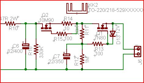

I'm also surprised that you're seeing a high level of power supply artifacts in a low gain line amp. Is your base case a simple RCRC filter? Also a little surprised to see so much 60 Hz left over. Maybe you have a ground loop somewhere. Nothing beats a good star ground with short local rectifier loops in the power supplies.
I find that with a gyrator on the plate, a simple ripple eliminator, capacitance multiplier, or "electronic choke" as shown kills all the power supply junk down below -120 dBu on the output of a single stage D3a amp at 30 dB gain. (Q2 is just for short circuit protection and set at 1.5X normal current draw)
For higher gain e.g. microphone or phono input stages a good shunt regulator is needed in addition.
