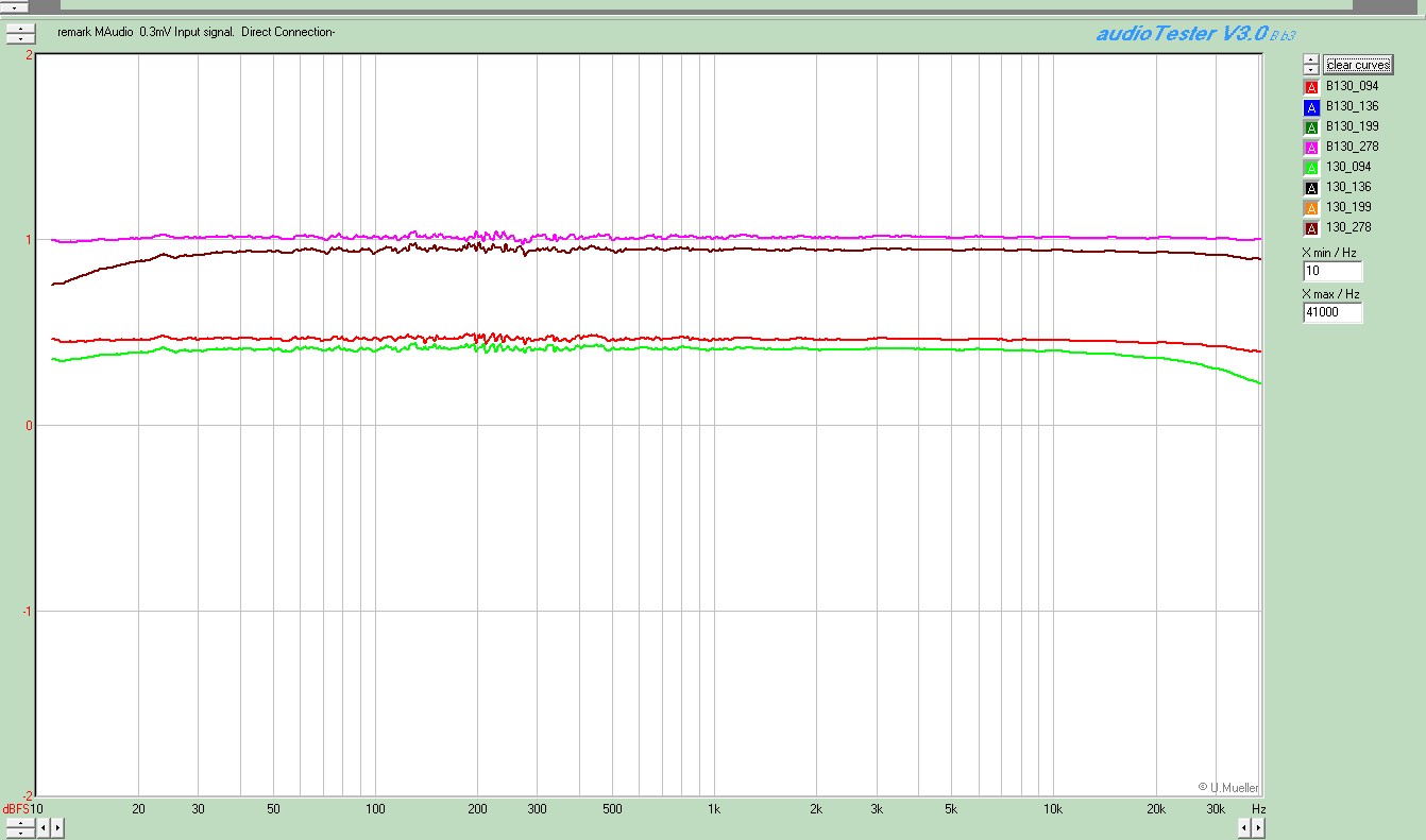

Salas,
I didn't have a 1000uF cap to play with so I parralled (sp) three 220uF caps for 660uF total. I didn't see a significant improvement in THD or noise floor. I did see a marked improvement in Freq Response though. The attached sweep is with 130V anode varied between 9.4mA bias and 27.8mA bias both Bypassed and UnBypassed.
Bypassing the LEDs appears to remove the remaining local feed back associated with stringing that many LEDs together. Freq Response is much flatter bypassed at both extremes. What I find interesting is the behavior unbypassed. At low Bias the LF response is better but suffers some increased HF rolloff, At a high bias current the LF suffers some increased rolloff but the HF is better. I assume that the improved HF rolloff is a result of a lower Ra at those currents.
In the Index B means bypassed. The first three numbers are Anode voltage and the second numbers is bias x10. I measured a couple of bias settings in between but it made the graph too cluttered.
If you note the Y axis none are real bad. and with in the case of HF the roll-off seen is weill above audible.
I should comment that the sweeps were conducted with the exact same input signal Vrms of 166.9mVrms. The changes in gain are due to the circuit and tube operating point. In the graph 1dB= 1Vrms. Sorry but it is an error in my cal file, as are the squiggles. The tube used is a GE JAN12b4a calculated mu is about 6.

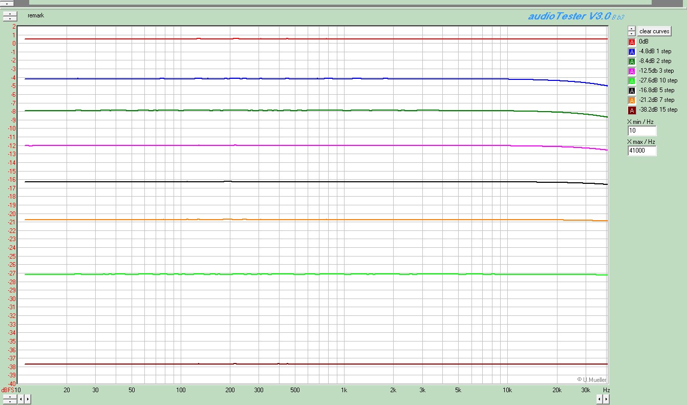

Here is some more interesting data. In this set of curves where I stepped the attenuator downward. I would have thought that as I increased attenuation, the HF rolloff would have increased. Instead, the roll-off decreased with increased attenuation. I measured the resistance of each step and the source impedance remained spot on 100k.
In these sweeps, 130Va, 27.9mA bias. LED's bypassed 660uF. 0dB=1Vrms output. 0.166Vrms input.
Bypassing so many LEDS plays a role. When you will decide subjectively also, see about bypass cap's quality and maybe a shunt film cap combination.
It looks more like a slew rate limit than as a high frequency roll-off. Do you have a plain good old oscilloscope instead of computer, Scott?
Yep. Have the old school tools too. ;-), I assume you want to test some square waves.
Bypass are panasonic FC. Can put a film to bypass if need be. Not ready to listen yet but will soon. Have a couple more tests to run first. Besides I only have one channel running.
Not necessary. Would be enough to check frequency response by sine waves of different frequencies. 🙂
