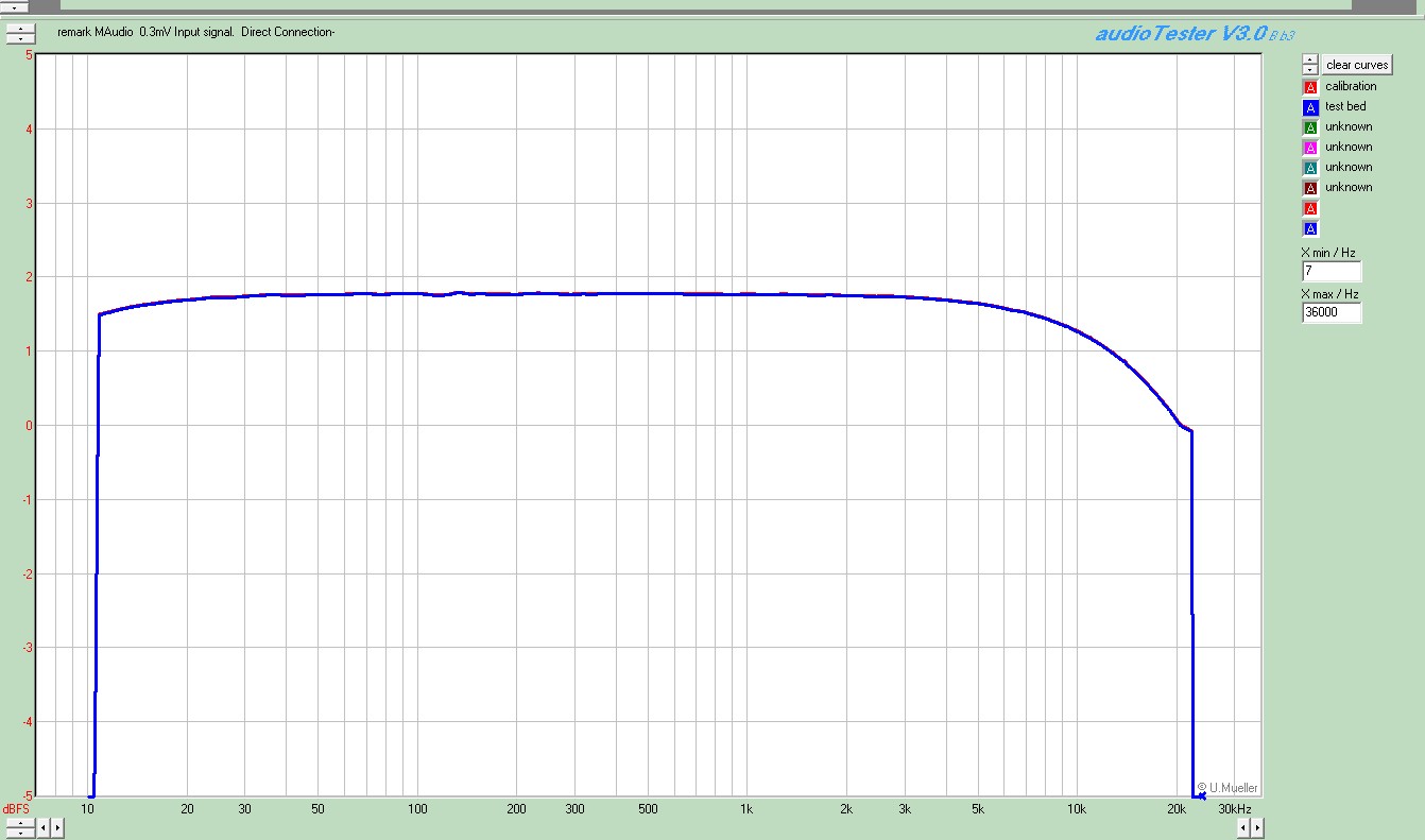

I built a test bed to evaluate different types of anode loads for my next version of the 12b4a preamp.
My current 12b4a preamp is using a 10m45s CCS as the load. It was a quicky to clean up the wiring mess I had initially, but some simple measurements of the frequency response showed it to be flat out past 30kHz.

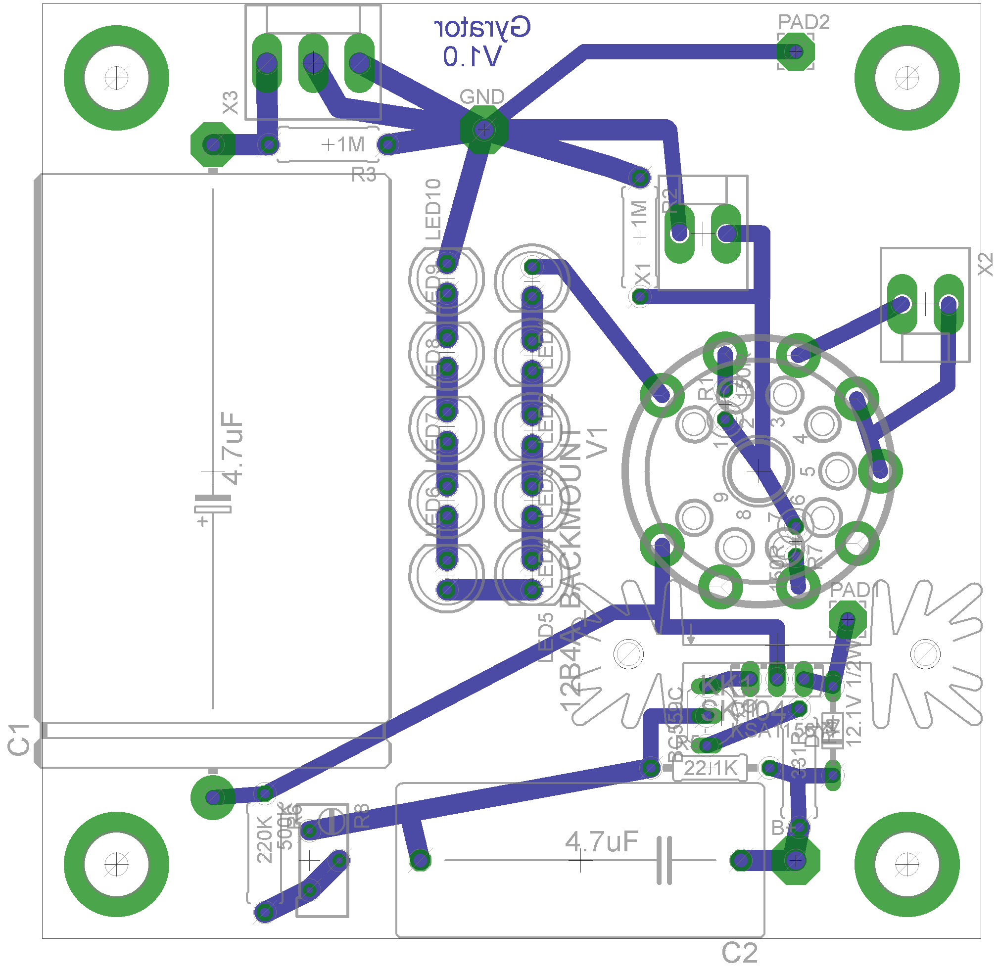

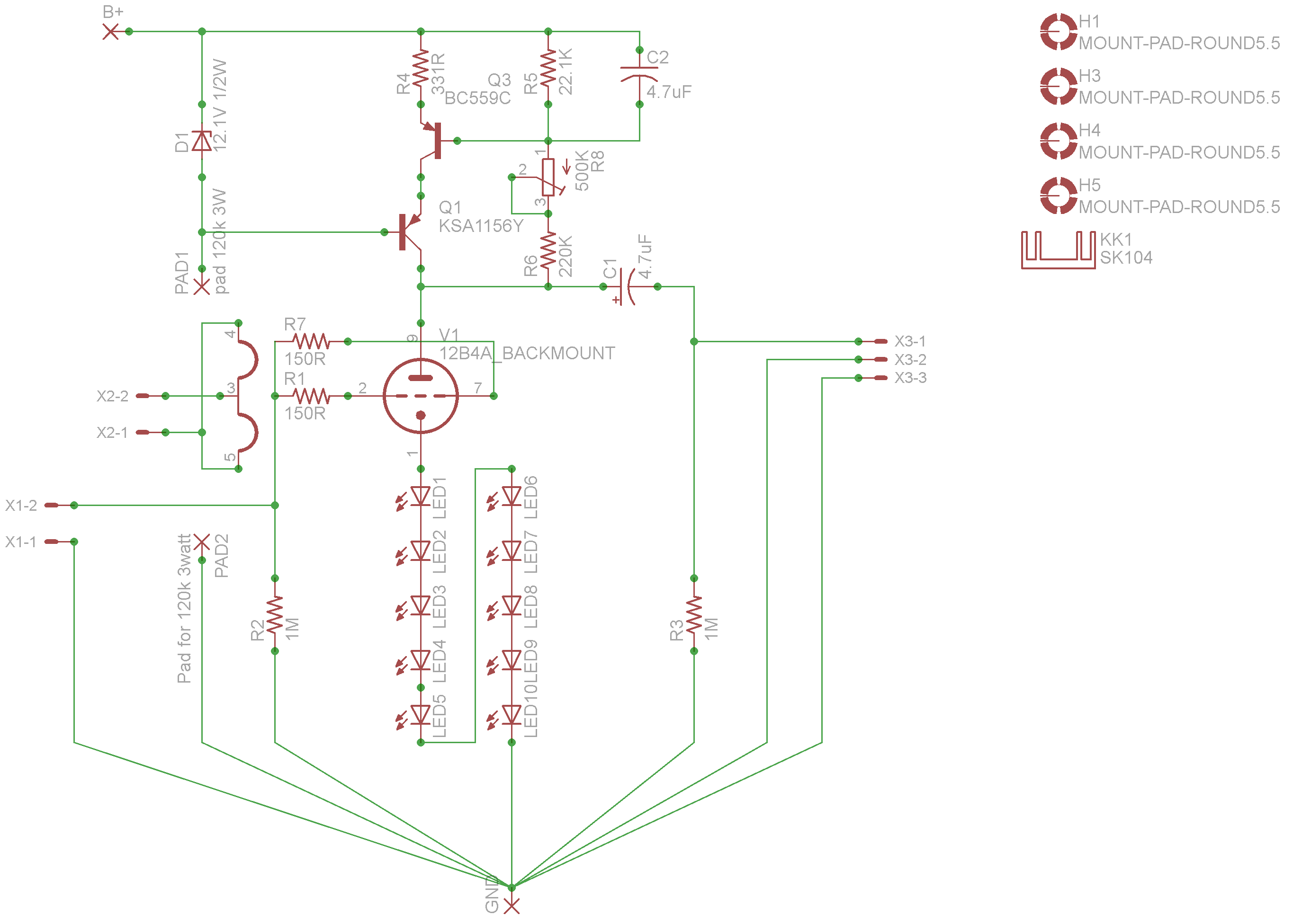

I am now playing with Wavebourn's Gyrator. Attached is the schematic, pcb used and the response curve. I don't think a gyrator has a response like this indicating I did something wrong. The response curve is shown with a calibration run so it is the circuit response that drops off starting at 10kHz. I have switched tubes, played with bias, and moved the anode voltage up and down. The curve is taken at 140V anode, 20mA bias with 200V b+ into the gyrator.
Your help would be greatly appreciated.

The input capacitance of the test equipment should be quite low. The cal curve was taken with the same set-up and cables. It is a 1626m soundcard.
In regard to the KSA1156Y I can't find the output or transfer capacitance in the fairchild spec sheet. I do have some MJE350STU on hand but I find the capacitances for those either.
DF96 good question will check.

B+ 278V
V anode = 142V
With respect to B+:
The KSA1156 has 12.1V at its base, 136.2 at the collector, and 11.7V at it emitter.
The BC559C has 6.18V at its base, 11.7 at the collector and 5.53 at its emitter.
The zener diode is flowing 1.3mA
R5 is passing 0.28 mA
The circuit appears to be working, I suspect that the current may be too low through the zener for the ksa1156

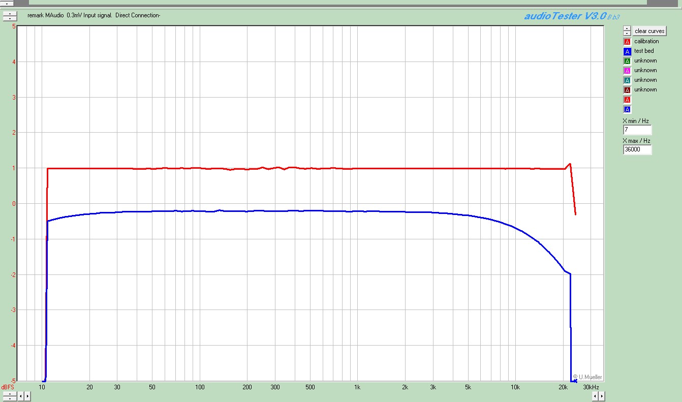

After searching for a while, I have come to the conclusion the the capacitance of the KSA1156 has to be quite large. There is no documentation for it so it wasn't an issue in the design of the part. Found quite a few replacements that specify low capacitance but either they don't have a high enough voltage rating or can't dissapate enough heat. I know they are out there just havn't looked in the right spot yet.
I didn't have a 1 Watt 1k resistor so I used a 750R 3watt I had in the bin. (15V vs 20V, I didn't think it would matter too much) I still get the exact same HF roll-off. The curves lay right on top of each other

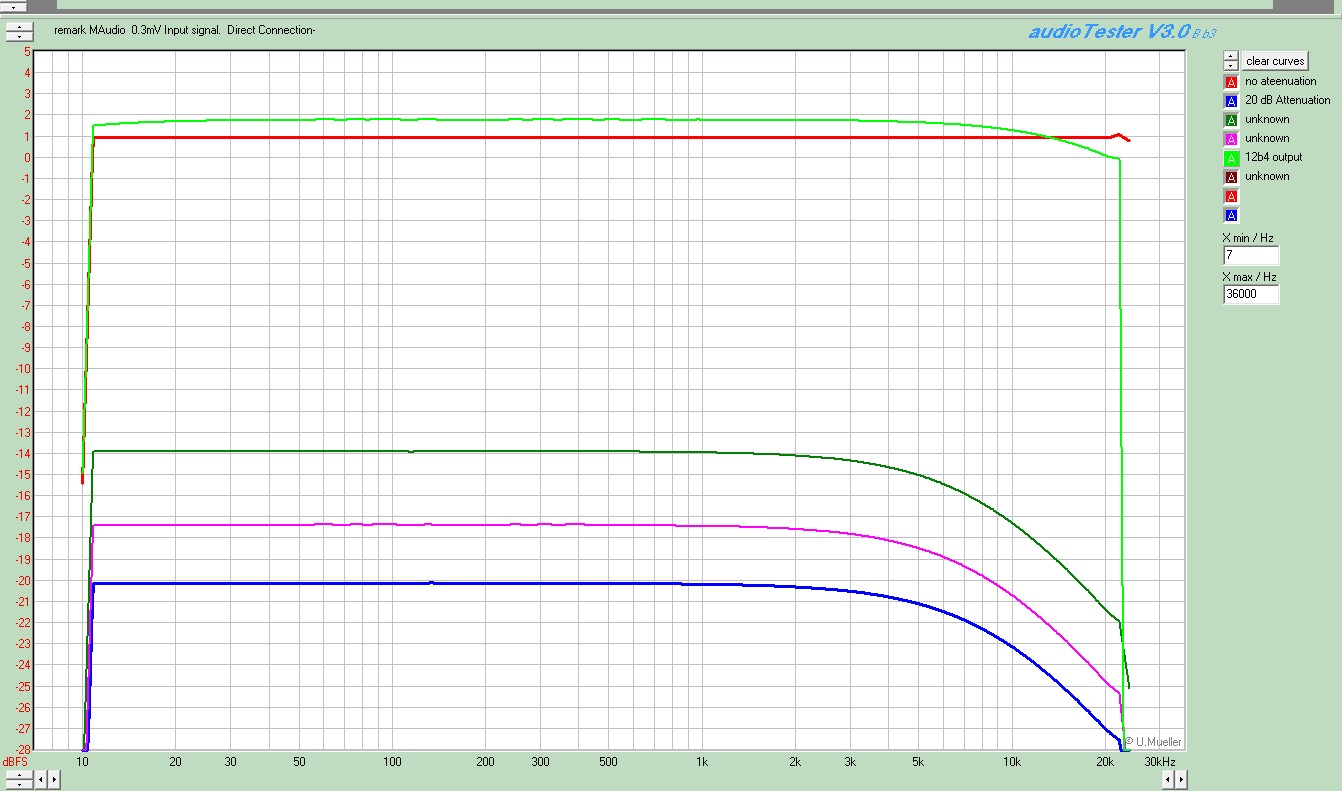

You have narrowed this down thanks. I soldered a pin to the grid and measured.
The bright green is the output of the preamp at 1Vrms out
The Red is the grid with no attenuation, howeever the bottom three lines is the grid with increasing attenuation. I have a 100k stepped ladder attenuator on the input. The Blue line is the attenuation needed to get 1Vrms at the output and where all of the testing to date has been done.
At this level the input impedance is 23.5k on the grid.
At that attenuation there is 75k in series with the signal

Hey that is a graphic demonstration of the Miller effect. The effect becomes more pronounced as the attenuator voltage divider shunts more signal to ground (my speculation).
What is the source driving the 12B4? It might not be just Mr. Miller if there is a coupling capacitor creating a time constant (low pass filter poll) with that 25K resistor in the atenuator to ground.

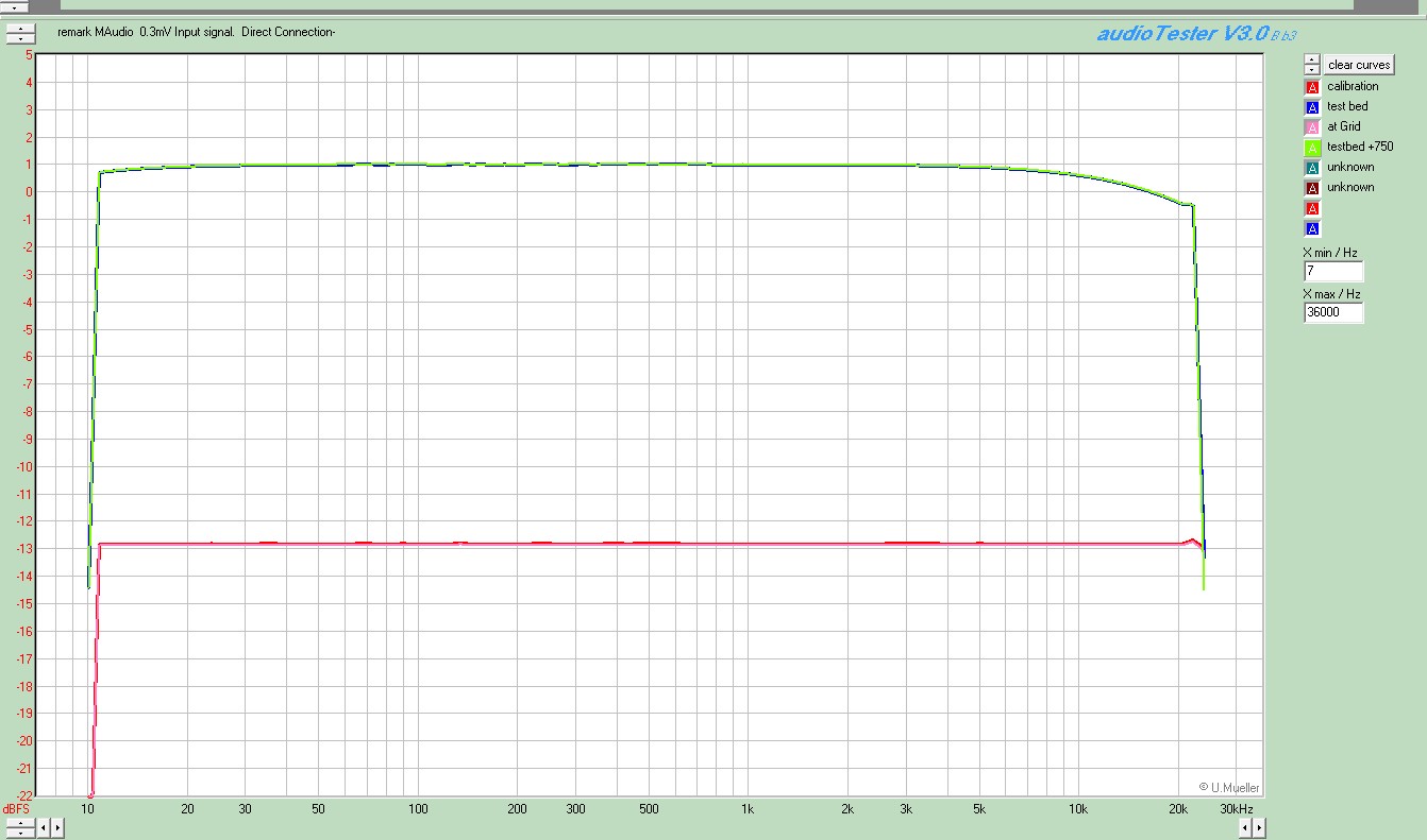

Hey DT,
Something is certainly going on. Miller certainly is a candidate. I made a few more tests. This time I set the attenuator to full gain (zero attenuation). In otherwords it is now acting like a 100k grid leak resistor. I then dropped the input signal level so that the ouput level of the 12b4 was 1Vrms @ 1kHz.
I then repeated the sweeps.
The Red and Pink curves are of a calibration sweep and the measurement at the grid of the tube. No HF roll off this time on the input side.
I then swept measureing the output with and without the 750R resistor in the collector of the KSA. The roll-off is still there. (blue and green).
At least now I know it is not the input. The fact that the 750R resistor at the collector had zero effect points to something outside the circuit. Not sure yet how to test your point wrt a rc constant and Wavebourn's earlier comment regarding the input capacitance. I did switch cables with no change.

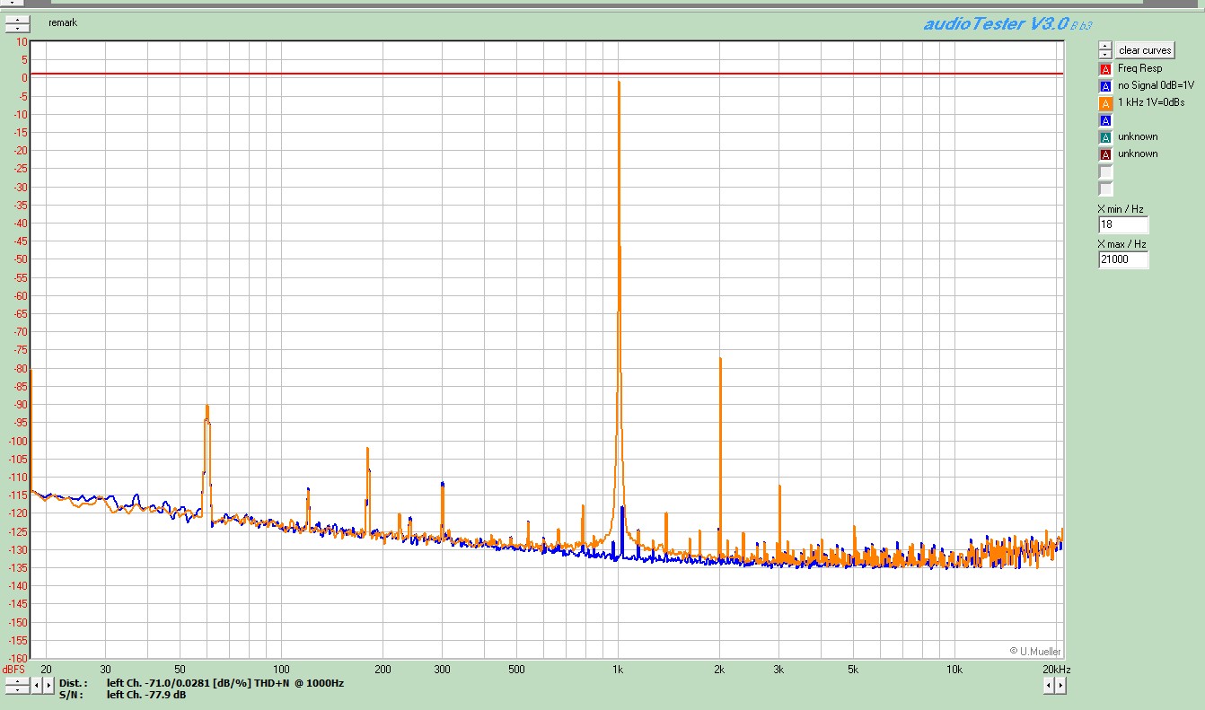

Had the same idea. Except my break was a shower. Came back and started thinking, Looked at my sound card and said "Why do they list the front input /Mic Input as HiZ?". So I switched to it and low and behold.......see attached.
Apparently the input on the back connectors is too low or has a high capacitance as Waveborne suggested. Will have to look at it in the morning.
Eli,
have thought about trying a FET and may whip up a board to try it before it is all over. I have a couple of BC20's left from the OPUS.
A Genuine and Heart Felt Thanks for those that helped me out.
Scott
P.S. Now to play around with the sample rate and see the higher frequencies
