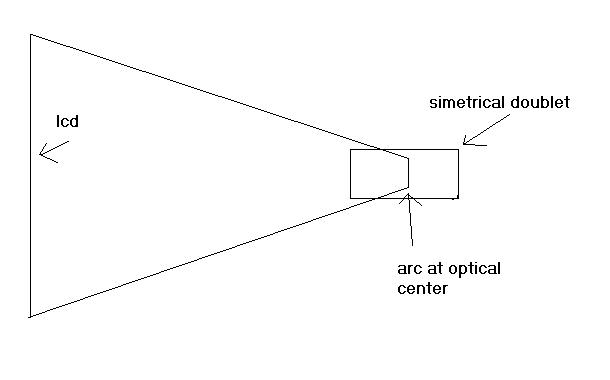

The key in my ideal setup is filling the rear lens. I would say yours is focusing to the optical center.
this is a supid example of focusing at optical center and that it won't work.
Dazzla Said: "Yes filling the entire lens aperture will work with the 135mm FL triplet and yes filling the entire lens aperture of a singlet will work. But filling the entire lens aperture of all lens types wont work and more aberrations will be present"
I would like to se an example of non working setup filling the rear lens, (i did a example of non working setup with focusing at optical center).

Your example of the symmetric duplet that is too small in diameter has nothing to do with where the arc image gets focussed. It just has too small a maximum field angle for the application. If you try drawing the same thing using a diameter that is large enough, you will see that focussing the arc image at the optical center gives you the largest field angle.
and about post 73 you have something to coment?
about the simetrical doublet it was just a stupid example. It could be that the field angle is not sificent... maybe a wide angle projectio lens would be a better example...
now forget it, i would like to see a example with my ideal setup not working.

I just don't share your belief, because I don't think the light from a single pixel really falls on a small area of the lens. In simple spherical lenses, the spherical aberration is the most significant problem and it gets much worse the farther the light path is from the center of the lens. We don't have any idea how well the 450 mm fl triplet is corrected, but I can tell you from my experience using the OSLO optical modelling program that the corrections of a well-designed triplet are usually made so the maximum aberrations occur at the center and the edges of the lens. Half way from the center usually has the best correction. The aberration at the center does not matter at all, because light going through the center does not get refracted to a different direction. So the edges are where the poorest performance is.
Another thing to think about: A projection lens for an LCD does not need to be very good, because the size of each pixel on the screen is so large. But it does need to have a large enough field angle to get the corners lit. Focussing the arc image at the center of the lens gives you the widest field angle. Focussing past the center may cut off some of the light from the corners of the LCD. Not enough to give you black corners, since the light from those pixels gets spread over a (ie. 60 mm) circle. But enough of that light can get blocked to make them dim.
But all of this is just speculation: There are too many unknown parameters for the 450 mm fl triplet. We could discuss this forever and never reach any conclusions. Somebody has to get one and make some measurements.

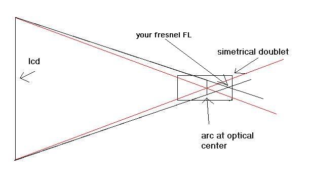

Rox in your example pic you aren't focusing thelight at the centre of the lens, you have drawn it focusing past the lens. The red lines are focused at the centre of the lens. So in this example your theory is the one that wont work.

Here is the end of the "focus point for arc image" discussion! I just looked up one of the websites selling the 405 mm fl triplet:
http://www.diyprojectorcompany.com/catalog/product_info.php?cPath=23&products_id=69
They give the barrel length as 159 mm and the lens inner diameter as 135 mm. I made a full-scale drawing of this lens with a 60 mm wide arc image focussed at the center of the lens, and a 60 mm wide arc image focussed at the third lens. Then I projected rays from the upper edge of each of these arc images to the upper barrel at the first lens edge. This shows the maximum field angle the lens can support with 100% of the light getting through the lens. In the drawing below (not very accurate) the arc images are in red, the field angle with the arc image at the center is in blue, and the field angle with the arc at the last lens is in green.
If you focus the arc image at the center of the projection lens, you get a field angle of around 49 degrees. If you focus the arc image at the far lens, then you get a field angle of around 26 degrees. A 17" LCD with a 528 mm distance between the LCD and the lens, needs a field angle of 44.5 degrees. If you get the arc image focussed right at the optical center of the projection lens, then this lens should work perfectly for a 17" LCD. If you focus the arc image at the far lens, then the corners will be dim.

Dazzla; Rox in your example pic you aren't focusing thelight at the centre of the lens
yes, your drawings are with perfect bulb, but mines are with arc lenght at optical center as you have teach me to do. Anyway is stupid example.
just would like to see finaly the setup with my ideal teory (fillng rear lens) not working example. And would like also a reply to the question why don´t you minimize the rear lens area (you could focus exacly there so minmal area and minimal aberrations would be used at center.
Ok i give up with convincing anybody about where to focus with the field lens. I´ll just place the bulb somethng closer to the rear lens than you (if the 550mm field is done by 3dlens) and everibody will be happy.
about triplet field angle, the information manufacturer told me is less than 40 degrees of max field angle the lens was designed for, that has sense if you refract the lines something in your pics GG. Your field angles are considered like if the barrel had no lens, like if it only was a tunel.
