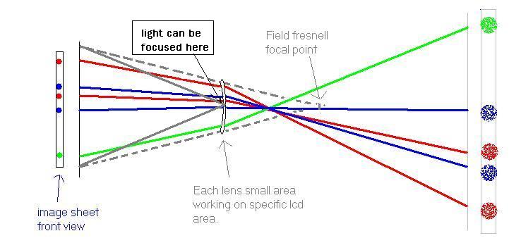

Dazzla, do you understand the post 39?
about the small lens area working on exclusive lcd area, and that it never hapens on crt?

please now draw the light rays on top of your image, focusing at center. Would like to know what happens to the projected image in your setup.

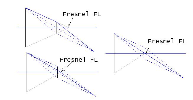

Here is a pic showing decreasing fresnel FL. The solid blue line is the actual light ray that is coming from the LCD. The dotted blue lines are just there to show what the lens is capable of imaging and to find the correct refraction angles. In all of these the final image size is the same and the throw is the same. It just shows that at each different fresnel FL, less and less of the objective is being used.
DJ
i mean that would like you to post a pic on the 39 post image showing the light rays for that image but focusing at center as you would do.

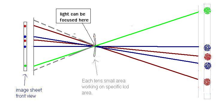

ok i agree with the light rays.
but now "each lens small area working on specific lcd area" is not true. just the central small area is working, rest of lens is out of work. And even the central area does nothing to the rays because it is the lens teory.

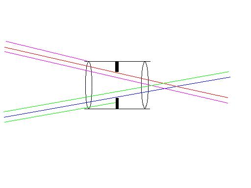

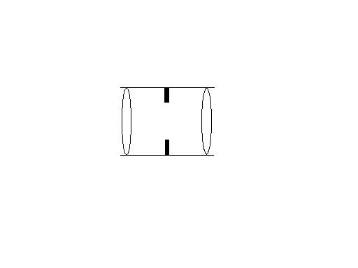

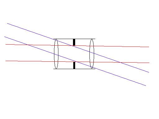

This is a drawing of a symmetric duplet projection lens, commonly used in overhead projectors. It has two positive lenses and a stop aperature at the optical center of the lens. The aperature makes the image sent to the sides and corners of the screen have the same amount of light as the image sent to the center, when the light is coming from a diffuse object. Triplets have almost the same design, but the aperature is replaced by a small negative lens.
more

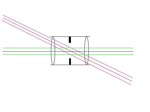

This drawing shows the paths of light going through the duplet. You can see how the aperature lets through the same amount of light for each path. Without the aperature, much more light would follow the straight-through path so the center of the screen image would be much brighter than the edges.
more
This drawing shows the paths of light going through the duplet in an LCD projector when the fresnels focus the arc image at the optical center of the lens. The red line shows the ray coming from the center of the lamp arc, while the magenta lines show the rays coming from the ends of the lamp arc and going through the same LCD pixel.
The blue line shows the ray coming from the center of the lamp arc through the center pixel, while the green lines show the rays coming from the ends of the lamp arc and going through that same pixel.
The area in the middle of the lens defined by the intersection of all the rays contains the image of the lamp arc projected by the fresnels. If you removed the projection lens and replaced it with a piece of white paper, you would see an image of the lamp arc. The size of that projected lamp arc image is a product of the arc length and the fresnels distances:

This drawing shows the paths of light going through the duplet in an LCD projector when the fresnels focus the arc image past the optical center of the lens. The red line shows the ray coming from the center of the lamp arc, while the magenta lines show the rays coming from the ends of the lamp arc and going through the same LCD pixel. Half of the light through that pixel does not get through the lens,
The blue line shows the ray coming from the center of the lamp arc through another corner pixel, while the green lines show the rays coming from the ends of the lamp arc and going through that same pixel. Again, half of the light through that pixel does not get through the lens.
All of the light from a central pixel will get through the lens, so the corners of the image will be much dimmer than the center. Notice also that the maximum field angle is reduced compared to the case where the arc image is focussed at the optical center of the projection lens. The only way to compensate for these problems is to use a much larger diameter projection lens. Then the fresnels can focus the arc image past the lens without any dim corner problems. Instead, the lens will be much more expensive and the final image may be more affected by spherical aberration and barrel distortion that get worse near the edges of a large diameter spherical lens.

OK, in your duplet, when you focus the light at the optical center, you are filling the rear lens aperture perfectly. This is exactly what i was triyng to say.
You said as well that if larger aperture lens is used, it is posible to focus farther with the field lens. I agree
If you draw those same pics with the 135 triplet, and you focus at the center of the lens, some part of the rear lens will never be hit with the light from the lcd.
I guess that ideal fresnell lens told to 3dlens is not a duplet lens based fresnell but a 135 famous triplet. Anyway, what assumtions did you take as well (100" image? 17" lcd?....) i just would like to see the standar setup.
