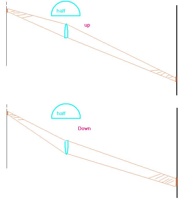

Dazzzla said:The entire lens is not being used and small points are not used either.
Yes i agree that it is midleway between perfect 0 arc lengh and difusse source. The top part of lens on the fresnel based setup, will never work on the botton lcd image. There is some lens area that will work on some area on the lcd, but FULL lens area will work on lcd if we add all "small works".
If i block the light from the difuse source (block upside), do you agree that the oposite side will be overall better quality? i mean don´t you think the lens upside was doing better work on upside than downside of the image before i stoped the light? I mean the distortion introduced by the lens is not simetrical. So so when we have fresnell based setups, overal the distorsion is minimal, Why do you think there are singlet OHP? The resulting image has nothing to do with difuse sources and a singlet.
I believe this thing i am calling "small lens area working on small lcd area" is much important than the aberrations introduced by the lens when you are on the outer limit.
If it was like you say, that we should keep close to the center so we keep the distortions minimal, then why are you focusing so far on the optical center? you can focus exactly to the center of the rear lens so minimal area would be used and "minimal" aberrations would be introduced. A 60mm diameter rear lens would do a perfect work to you.

yesIf i block the light from the difuse source (block upside), do you agree that the oposite side will be overall better quality?
noi mean don´t you think the lens upside was doing better work on upside than downside of the image before i stoped the light?
It's also the reason why a triplet is better.I mean the distortion introduced by the lens is not simetrical. So so when we have fresnell based setups, overal the distorsion is minimal, Why do you think there are singlet OHP?

dont you agree that each side of the lens will do a better work on each side? the second question on your previows reply (asnwer: no)
the projection of the down will be worse than up both with a difusse source.
Don´t you think?
