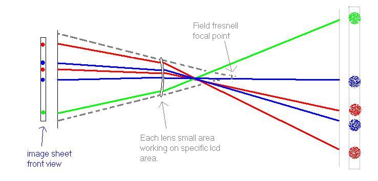

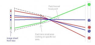

i think focusing beyond do full area is used is ok because the each lens small area works for correspondent lcd area and this way the image is better.
i´ll try to xplain it;
lot of OHP are based on singlet lens because it is sufficent if the setup is ok. Mean the cuality is sufficent for sheet trasparencies;
this would be a OHP setup, focusing the light beyond the lens so full area is used (check that each lcd part would only hit the correspondent lens part and no other, lets call it unidirectional light source) the projected image is best.
now lets see what would happen if homnidirectional light source is used;
this could be a crt light source, each image point will hit full lens area (and more will be lost out of the lens area) so the each small lens area needs to work on full image source and then project all images one on the wall, like adding all of them (one on top to next....))
this projected image will be blurry.
I think this is the idea of fulling the lens area with the unidirectional ligh cone (fresnells will do that), so 1)full light goes where we want and 2)lens cuality is best as well as image cuality.

if someone has a singlet lens from a OHP, he can try it in front of the CRT TV. The image with the OHP setup is much better than the crt with the same projection singlet lens.
Now a triplet lens and a unidirectional image source (fresnell fitting the lens perfectly) is the best quality. The same triplet on a crt tv will give us worse image quality.

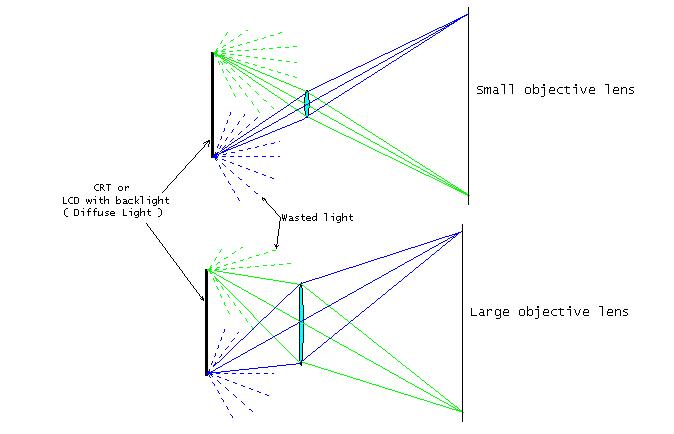

This is because a CRT produces diffuse light and the singlet doesn’t collect as much light as it can from the OHP.if someone has a singlet lens from a OHP, he can try it in front of the CRT TV. The image with the OHP setup is much better than the crt with the same projection singlet lens.
Again this is from the diffuse CRT and to make it worse the triplet is physically longer, making it block even more light.Now a triplet lens and a unidirectional image source (fresnell fitting the lens perfectly) is the best quality. The same triplet on a crt tv will give us worse image quality.

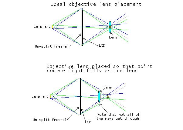

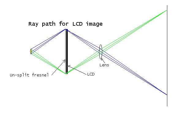

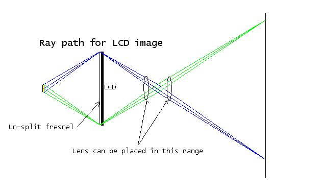

Rox I think you are confusing the LCD imaging with the light path. We have to consider two goals here. One is the objective lens and it’s ability to focus the LCD the other is how we steer the light so that it all goes through the objective lens. Have a look at the following pics.
This first one show how light is collected from a diffuse light source. The rays from the pixels travel out in all directions. The two raytraces shows the difference of a small and large objective lenses ability to collect light. Note that the large lens is able to collect more light than the smaller.
Now here is why the light should focus at the centre of the objective lens. The bottom raytrace shows how the light will be blocked if the light is focused beyond the lens using the point source as the guide for placement. Also make sure that you understand that this is the raytrace for the lamps arc and not for the LCD image. Another thing to consider here is that a multiple lens such as a triplet will make this blocking of light even worse.

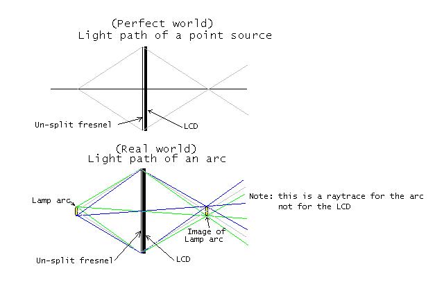

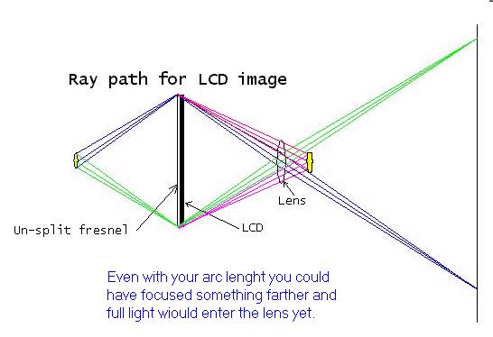

I agree with you in all points. I agre about the homnidirectional crt sources as well, i have just posted the same pics as you, but the first one is not honmidirectional, is unidirectional.
But there is only some little things i would like to check;
you are posting pics of real world, with those arc lenghs. If you had no arc lenght (infinitesimal point) there would not lose any light.
Even with your arc images, you can focus something father with the fresnells, your last picture is using 60% of lens aperture.
I now in real world it is not going to be as far as i say to focus, but it isn´t going to be at the focusing at the center neither. It needs to be a midle point where the full arc is inside de lens aperture and the outer light rays are inside the lens aperture as well. I think this point is the best solution for REAL WORLD.
What do you think about doing something like; (fcenter+fperfect)/2?

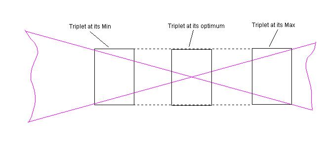

Another thing to remember is that no aberration or distortion has been shown in these pics and these will need to be taken into account as well.
I’m not sure what you are trying to achieve by placing the lens at one of its limits. The optimal position in my opinion is having the light focused at the centre of the lens. This is optimal for both light going through and keeping distortions and aberrations low. Any other position is a compromise. The idea is to use as little of the lens surface as possible and in doing so you can use a smaller lens. Just think about it this way, as the light is focused to an ever-decreasing smaller point, from real world to perfect world, the need for a large lens size is decreasing to a theoretical point where the lens is so small that it is not needed.

i don´t agree with your statement on that the lens is not needed.
I repeat that our setups are based on lens projection, so thats the most impotant elemnt.
You said that the lens could beplaced on a range that the light enters fully to the lens, but it is not correct, the lens needs to be placed only at ONE position for each throw and it is the lamp position or the fresnells focals what can be in a range of working ok.
your teory of focusing at center of the lens, does not care the aperture of the lens, mean that any lens larger than the arc lenght aperture would be a waste of money cos only the aperture of the arc lenght would be working.
Please could you tell me what field fresnell lenght would you use if you had 200mm diameter aperture 450mm focal singlet?

Just because the lens is 200mm diameter doesn't mean you have to use all of it
