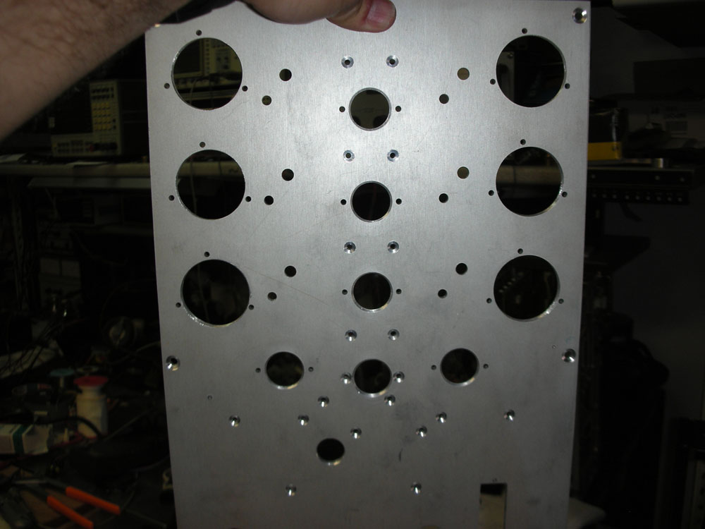

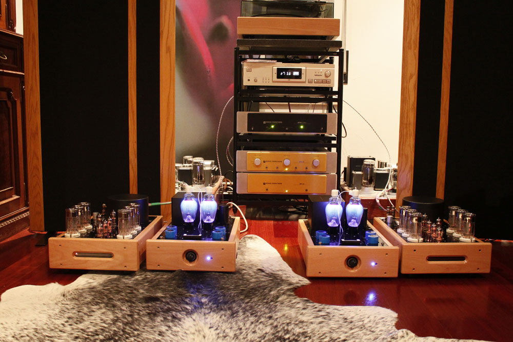

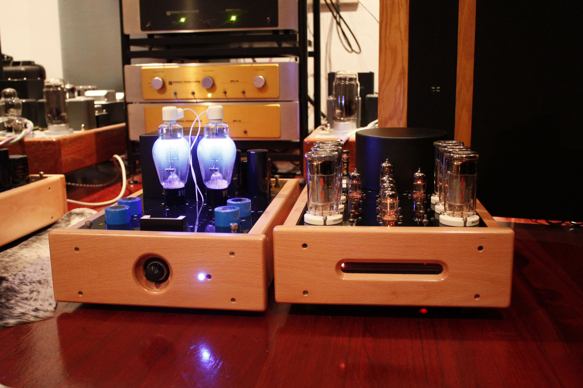

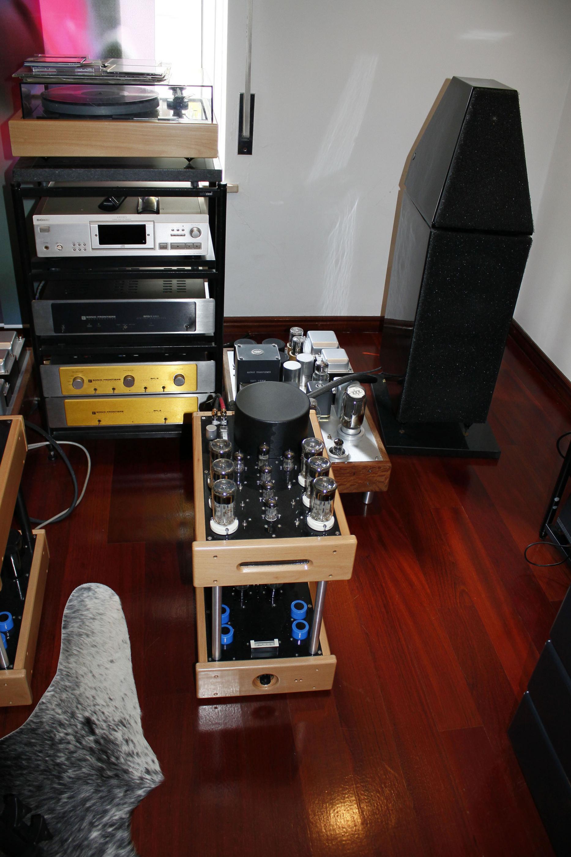

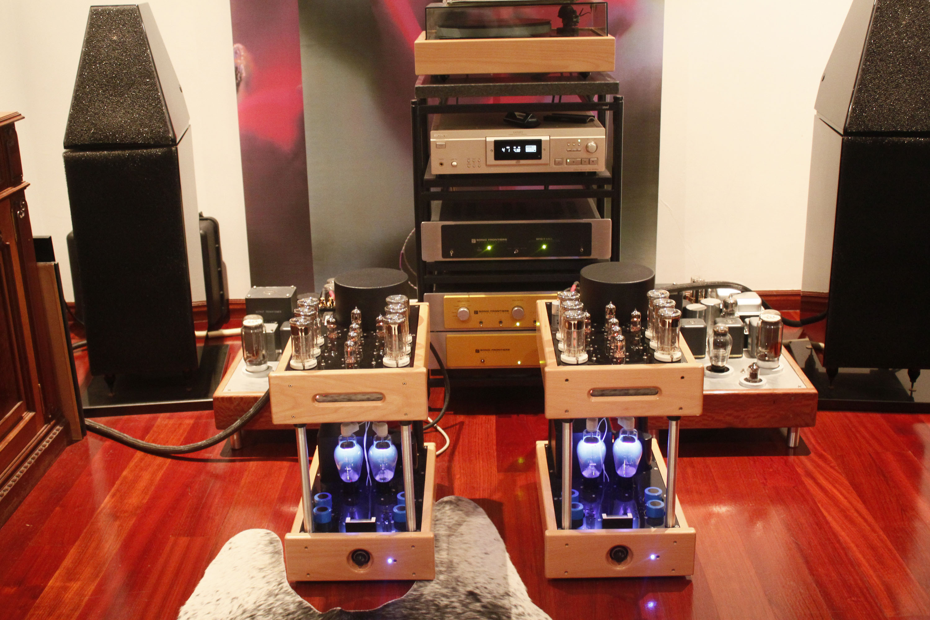

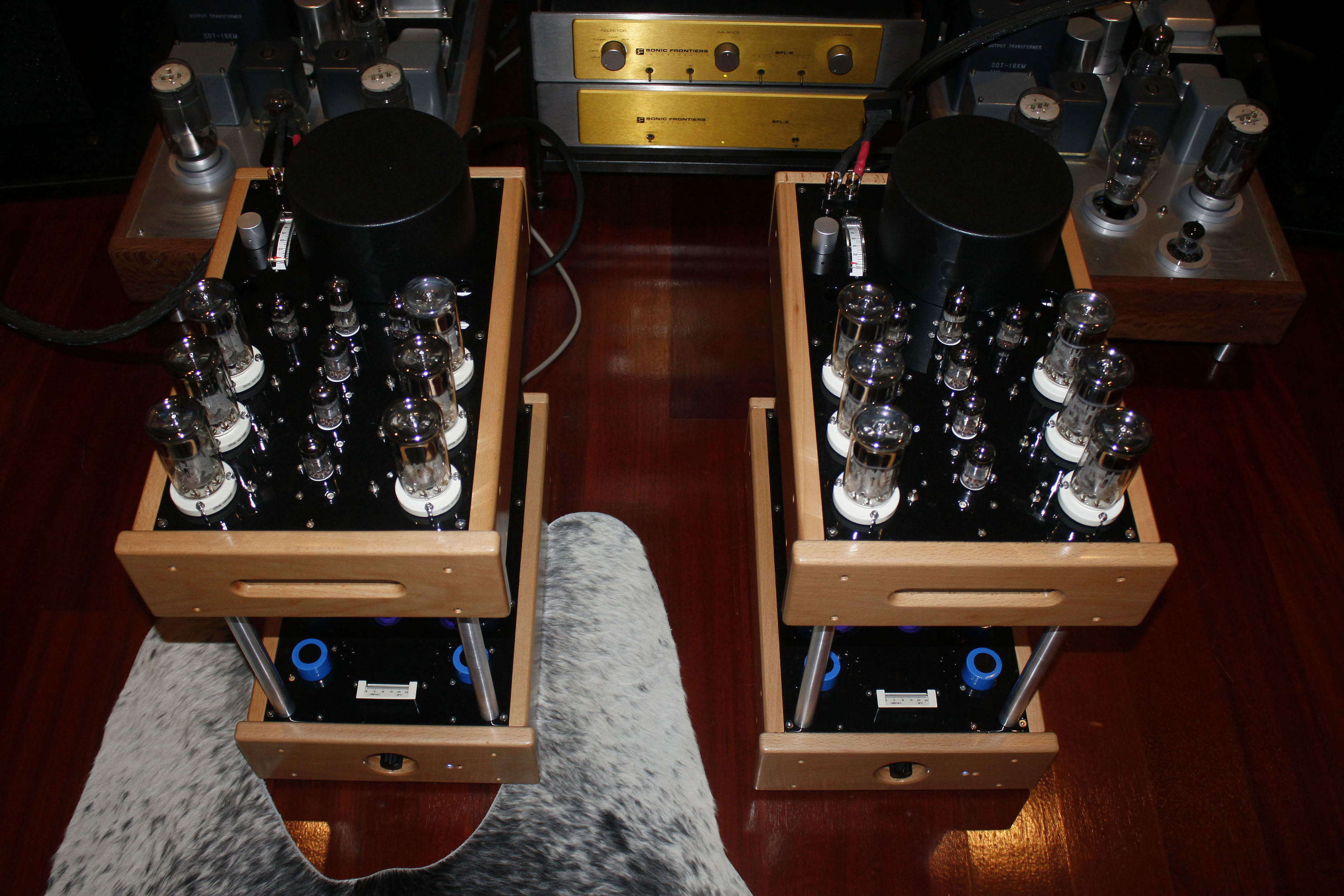

My setup is simply, Plate voltage about 440V ultralinear configuration plus cathode feedback. 50ma per tube (6 tubes). input tube diferential mode dual 6j43 plus sink current source; driver tube 6N6 CCS, 6N1 cathode follower output which provide individual bias for each final tube.

the output trafo is a vanderveen special version VDV2100CFB, the psu has dual voltage +/-180v for input tube (6P43) and cathode follower and like I said the the rail has 440v. The design hasn´t nothing special, it is all simetric and the input tube is a great performer.
