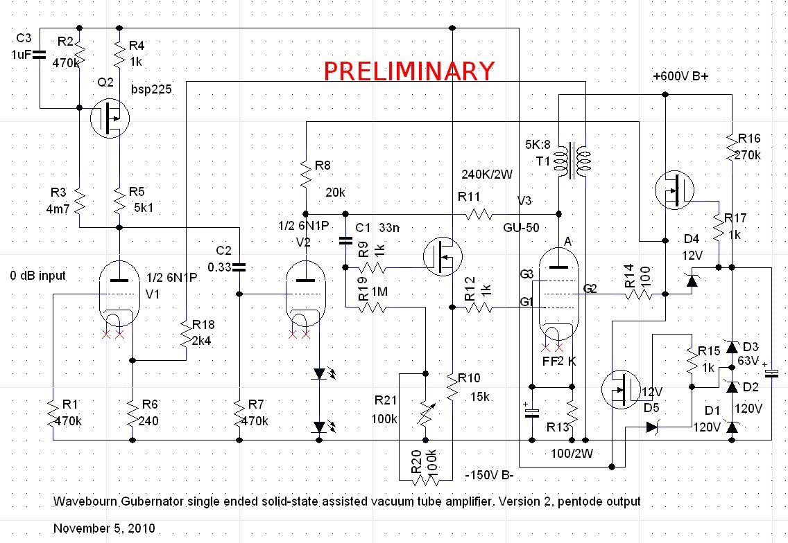

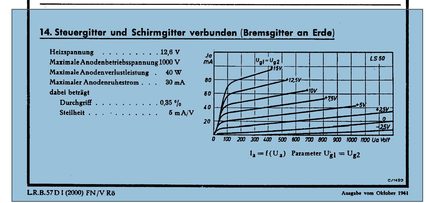

It seems that one alternative to make GU50 working as a triode with high anode voltage has been not presented yet. The pentode tube can also be connected as a triode by connecting screen and control grid together.
This connection forms GU50 as a "hi-mu" triode resembling much like 811A. In such connection the mu of the triode connected GU 50 is around 200...250. It requires some power to be driven and positive bias of some 7 to 8 volts when operated with 800 V anode voltage, but these are not too difficult to accomplish.
As many readers possibly know, GU50 is originally a German WW2 era tube namely LS50. It's datas can be found from the following site: http://www.mif.pg.gda.pl/cgi-bin/vs4.pl
At the last page of the data available from there (section 14. ), you can find this data.
I have built such SE-amplifier with GU50 and Edcor GXSE15-8-10k transformer and the results were very satisfying. The available output power was about 15 W.

Where is the advantage in comparison to the pentode connection? You still end up with 40-50 Kohms plate resistance I guess and same maximum plate dissipation (40W) with the additional complication of positive grid bias...!!

This was what I heard of at first. If you look at my original post, this was the thing I was thinking of. A high voltage Triode mode for GU-50. Which i have been strongly discouraged from doing due to the dangers 🙂
